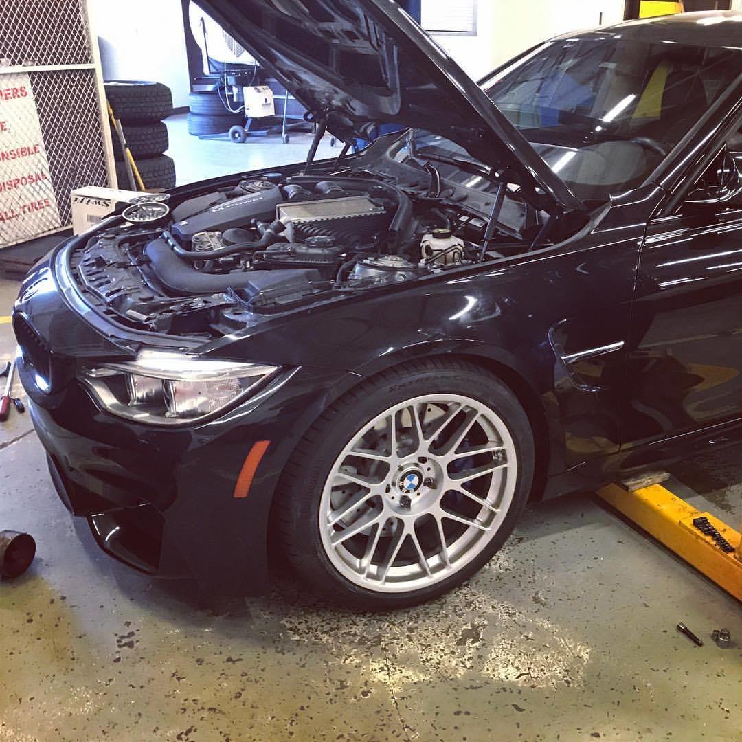

    Nice! I still get down ;)

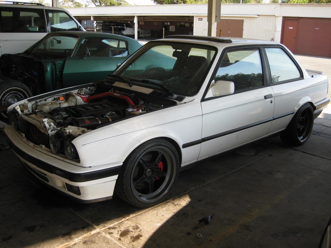

    And the one that was stolen :( Only original parts left were the tranny, body panels, and dash... I'm getting old.
