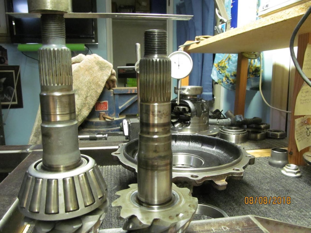

    Did some more reading: land cruiser gear won't work because it's high pinion, the clamshell is mid pinion. Looks like drilling out the holes another 1mm is solution.

    This is definitely the concern with the LC 4.10 gears, but ZUK has a set and is going to try them. If you look at the diff from an LC, it definitely looks more mid-pinion than previous models that were clearly high-pinion. Won't know for sure until he does. I'm still hopeful for a drop-in solution w/o drilling, for everyone's sake ;)

    And when I say it looks mid-pinion, I'm referring to the picture below, from this build.[​IMG]
    However, this image is not so mid-pinion :mad::

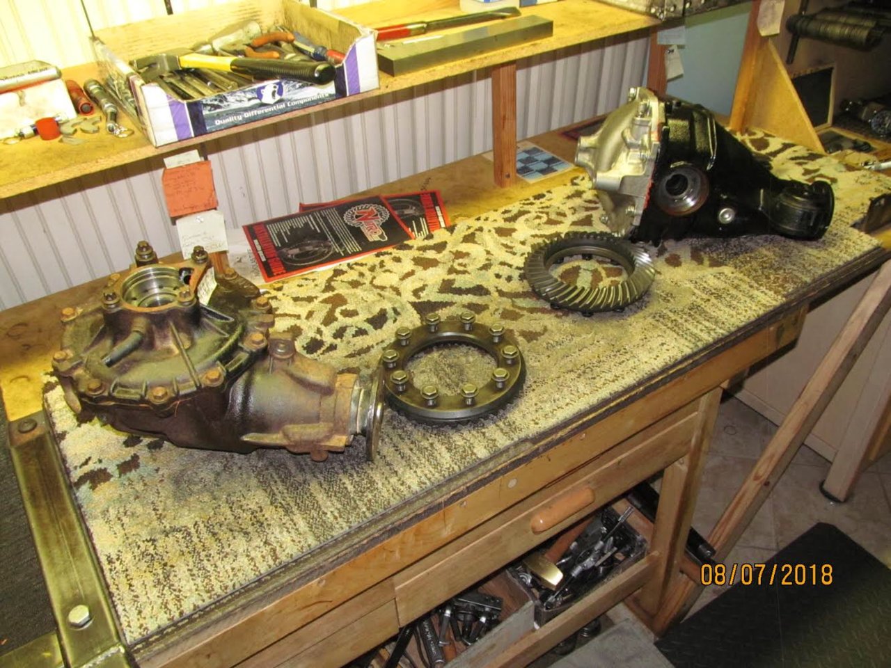

    We’ll know soon! Ken just sent me this pic of the diffs I sent him laid out on the bench!

    It's a no-go on the TLC 4.10 gears.
