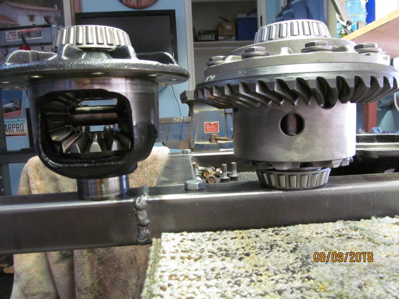

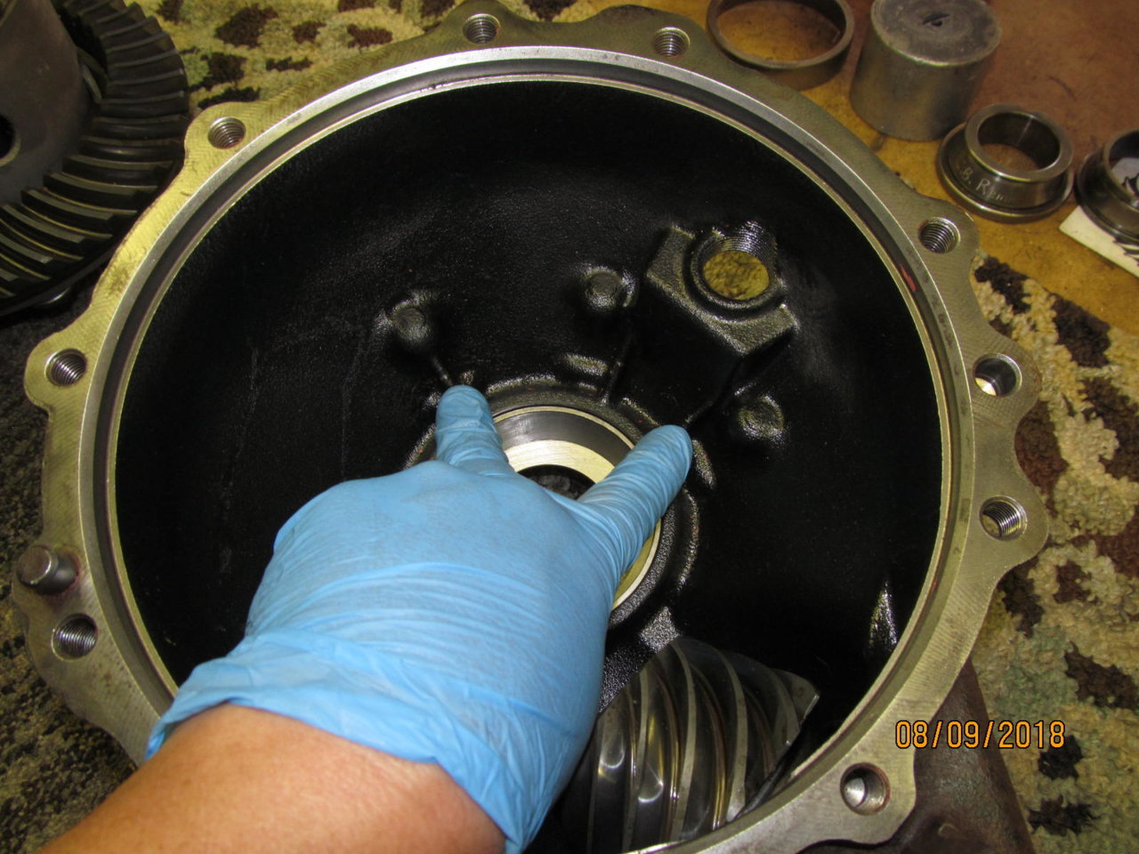

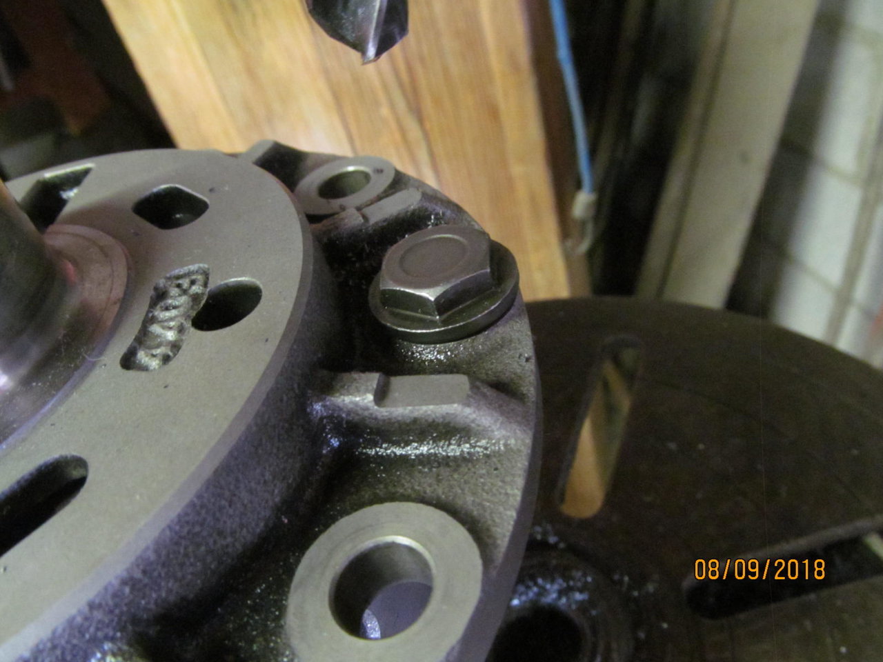

    This just in, @ZUK is a badass...

    This is definitely getting very interesting. If only some minor milling and machining is all it takes to fit one of those bad boys in a clamshell, I will be considering the upgrade.
    In reference with the first picture, did he cut the diameter down where the ring gear sits on the carrier?

    I think OP said early on the ring sits there nice, I think just showing how he secured to drill base.

    I test fit the FJC ring gear on the FRS unit before sending it to be rebuilt, they are the same ID. I did have to tap it on and off with a mallet, but I think that's pretty normal.
    @05Taco4x4 is correct. These were just pics sent to me showing how he was able to lock the carrier down on his drill press. Thankfully the torsen carrier has a pass through the center that he was able to fit an 8" long bolt through.

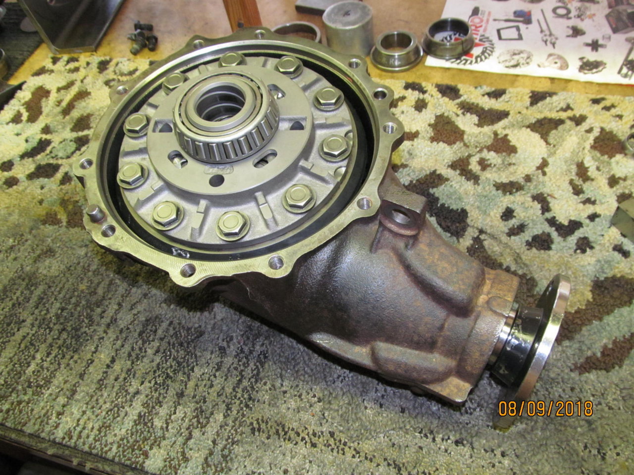

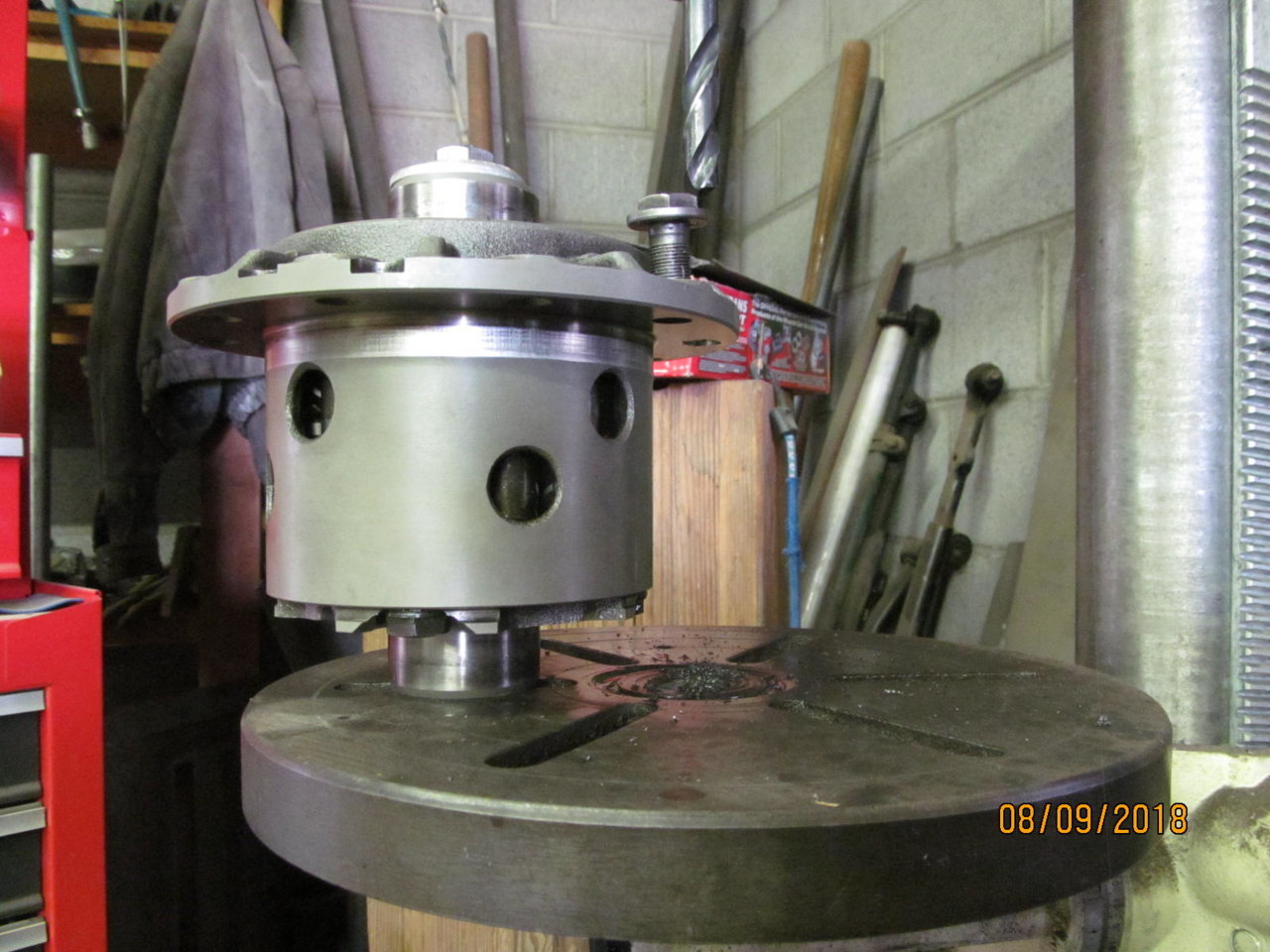

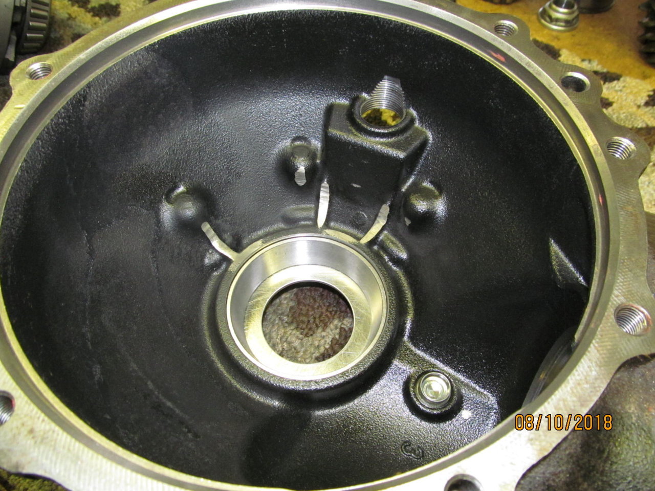

    Ring gear on. Had to clearance the ribs similar to what has to be done for the harrop e-lockers, which I expected.

    Nice! What is left to get those in the truck?

    That's exciting, I'm happy for you. Did he take measurements from end to the ring flange to see how exactly close they are? Or do a paint test on the gears?

    Paint test is next, only thing left to confirm this works.
