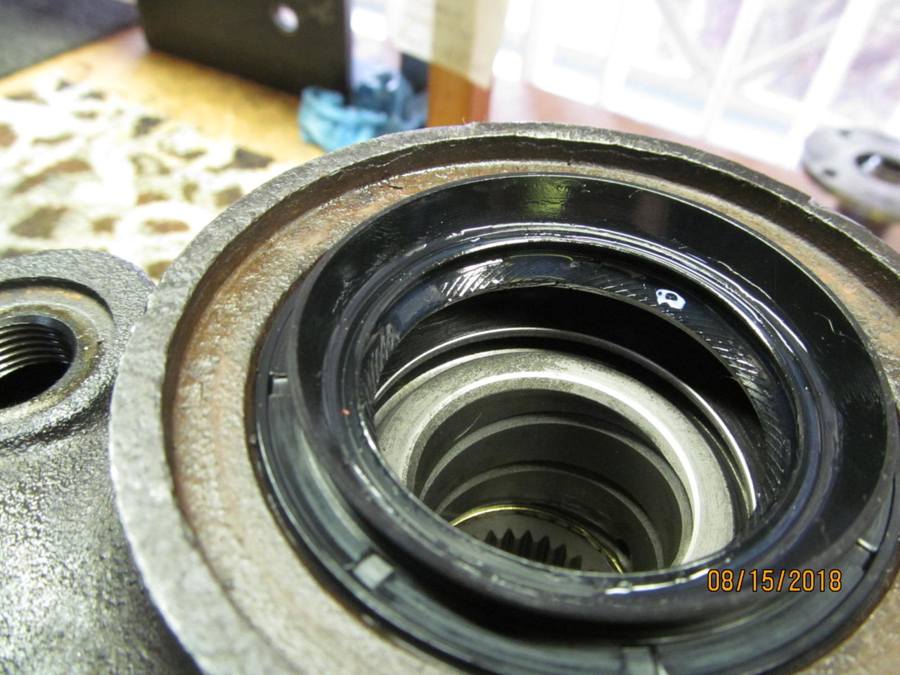

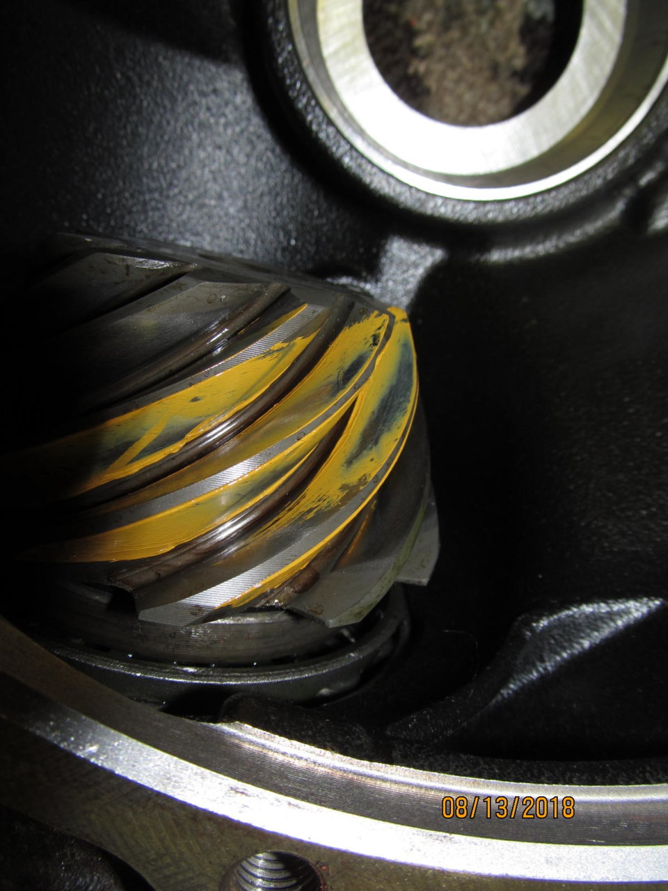

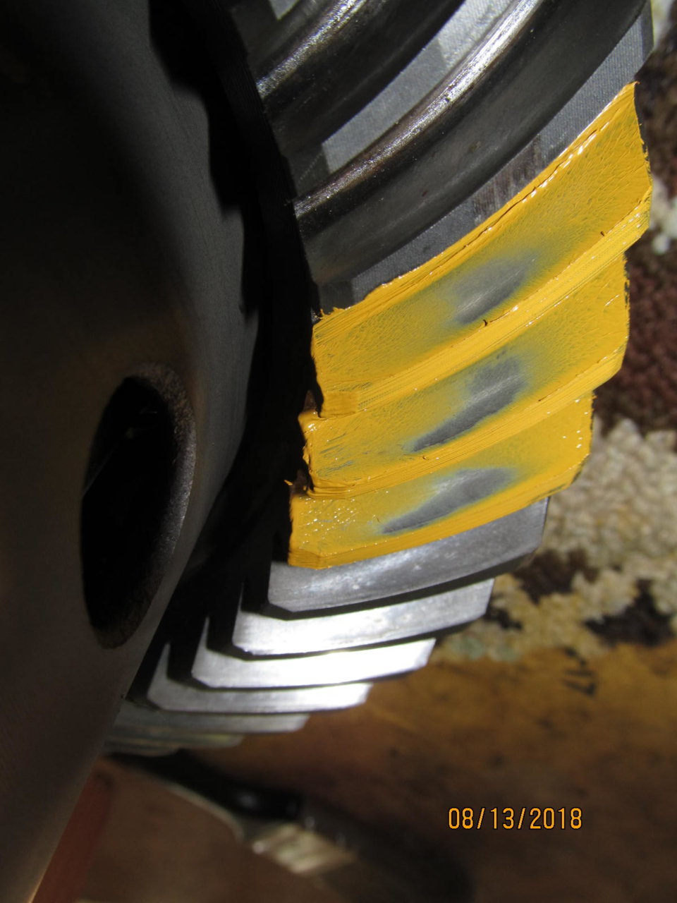

    According to ZUK, everything looks good :headbang: Sending a 3.91 3rd to him now for new bearings and a TrueTrac

    You'll like the trueTrac, I got one installed when I re-geared to 4.30 and I believe it is worth every penny.
    With this great outcome, I am now tempted to upgrade my front open carrier to a LS just like you did. This was a great research and I am glad it turned out so well for you.

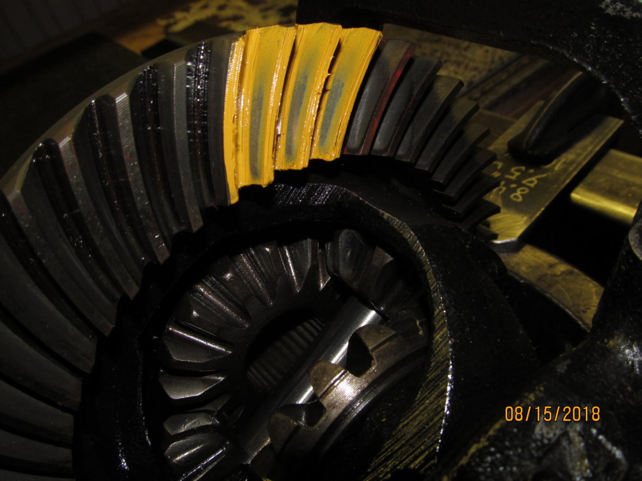

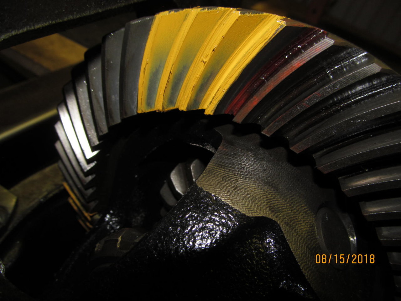

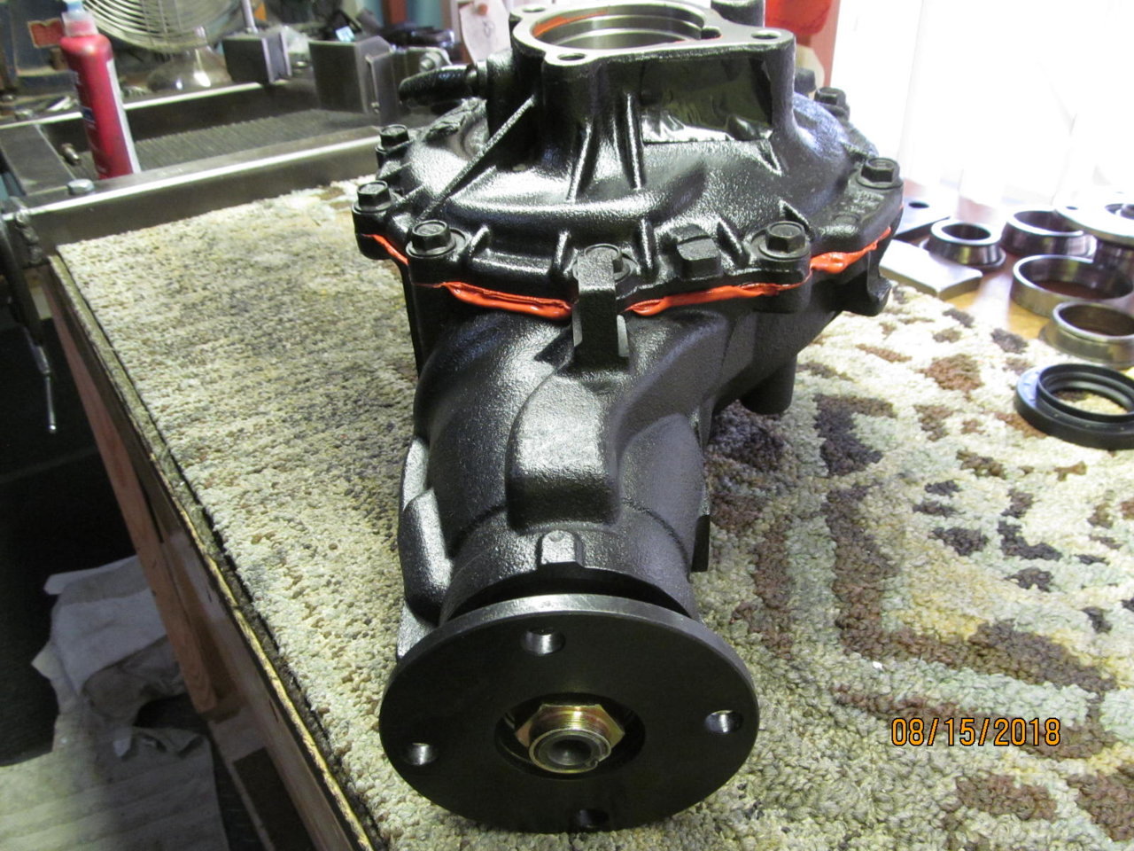

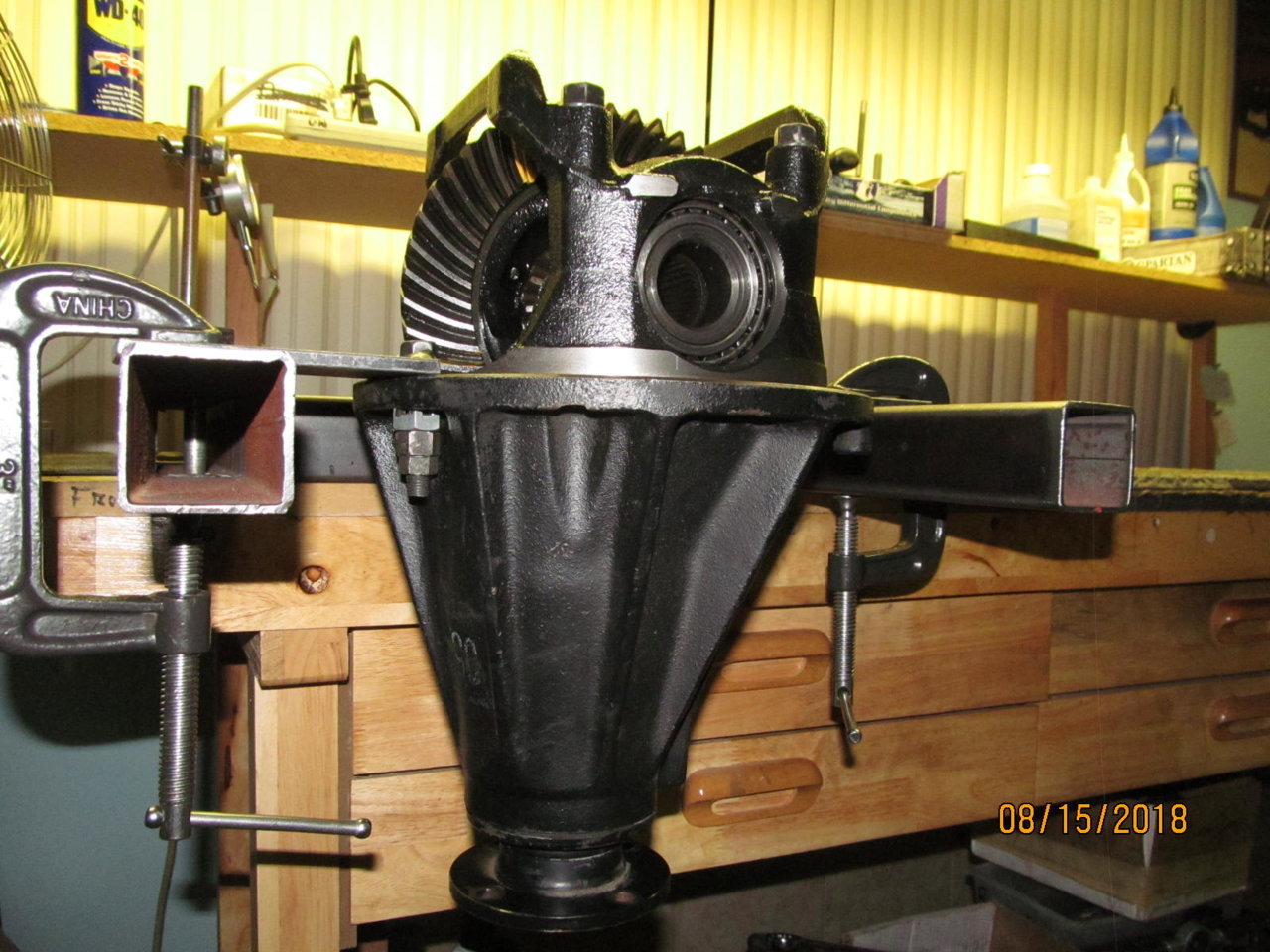

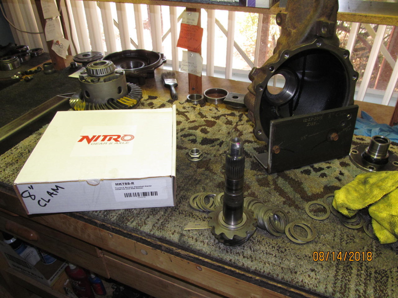

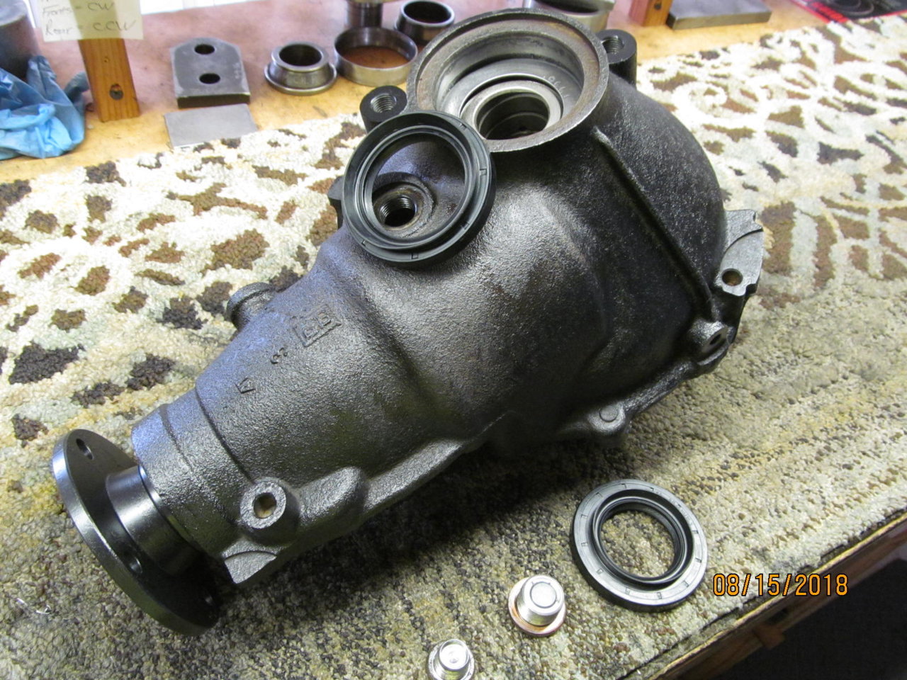

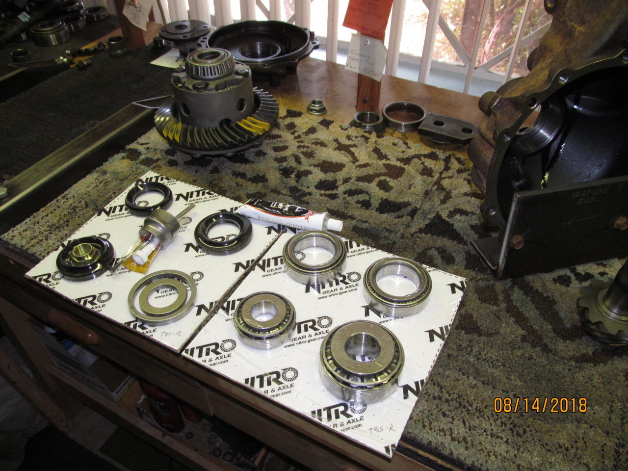

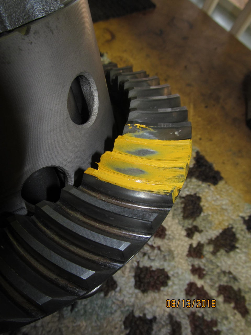

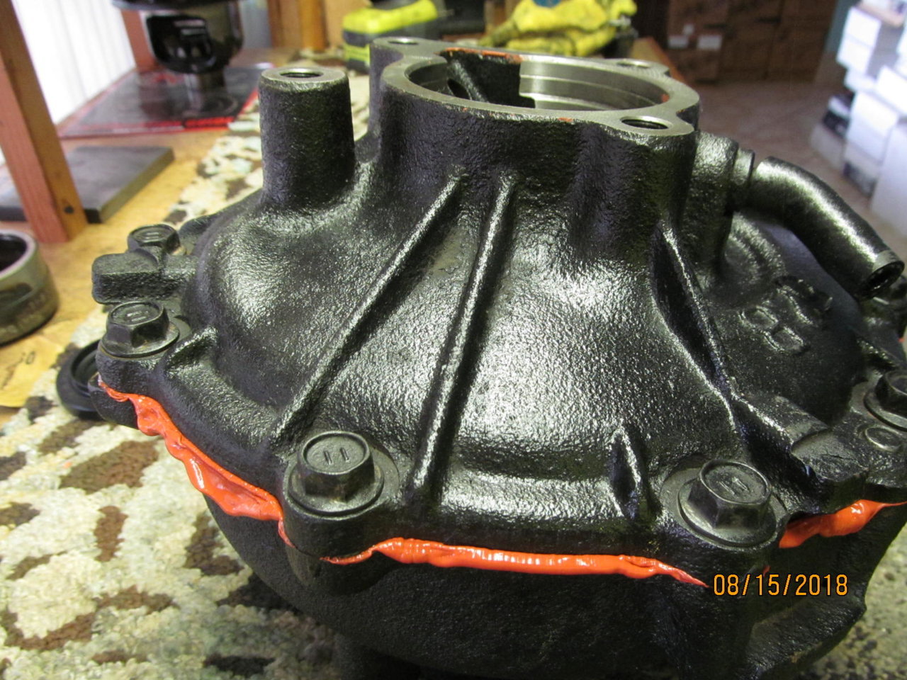

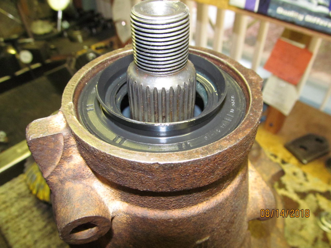

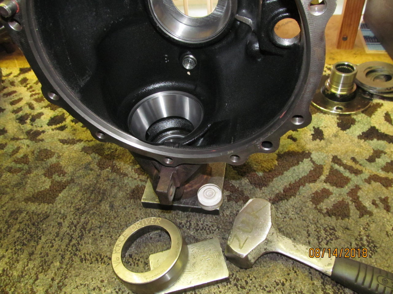

    Time for the build finale! I probably won't have any significant updates for this thread until I get both diffs back from ZUK and installed.
    IMG_1237.jpg IMG_1238.jpg IMG_1241.jpg IMG_1245.jpg IMG_1249.jpg IMG_1251.jpg IMG_1254.jpg IMG_1256.jpg IMG_1257.jpg

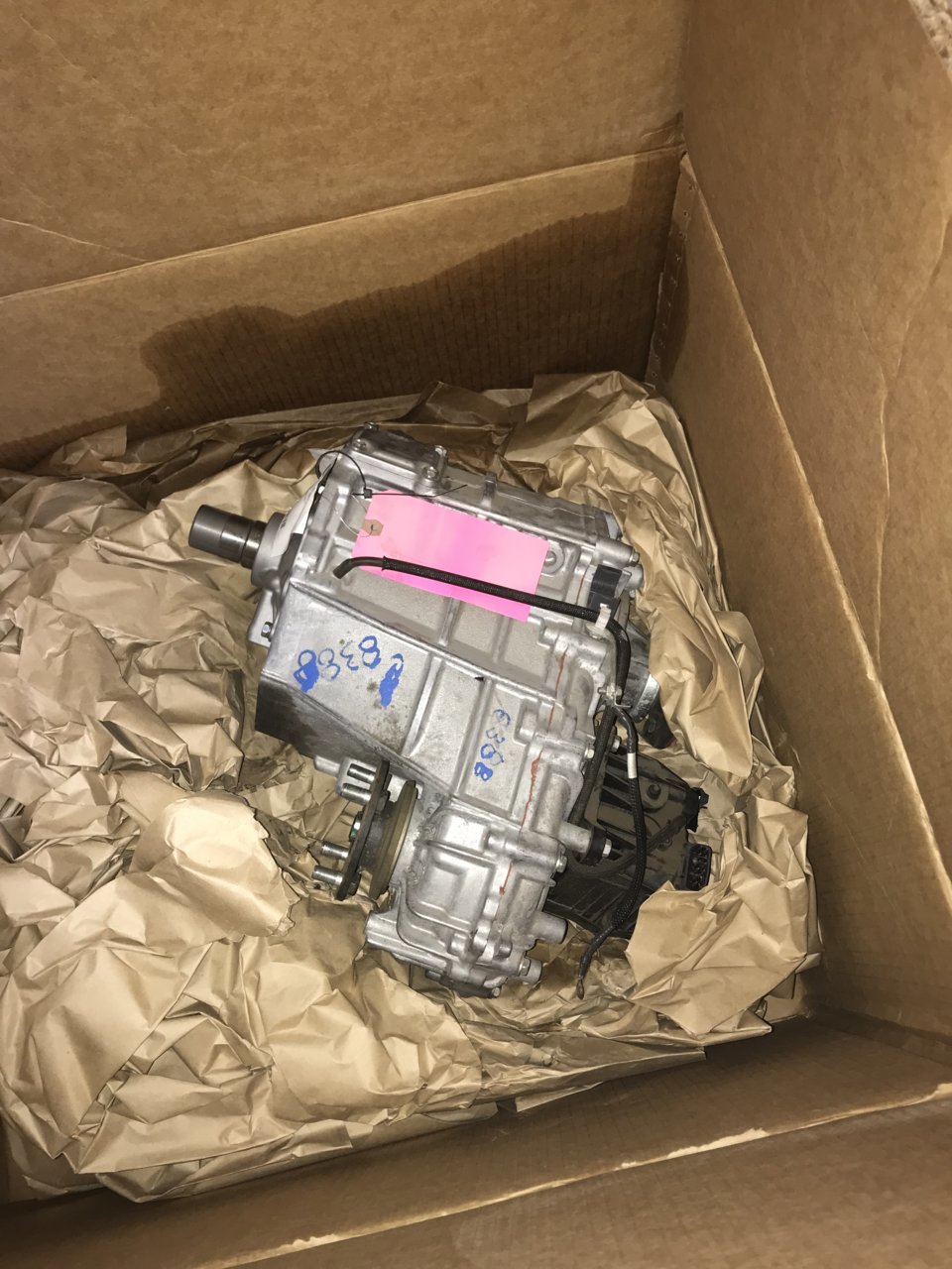

    Picked up the front diff and this AWD transfer case, naturally the plug casing on the actuator got smashed into pieces during shipping. Any ideas on how to repair or adapt without purchasing a whole new unit?

  16. Aug 21, 2018 at 6:51 PM
    #116
    YamaDirtrider
    YamaDirtrider Custom bumpers @FORT-ifyRigs
    Mar 1, 2016
    #179877
    6,343
    Josh
    Elizabeth CO
    06 DCLB sport postrunner
    What hasn't been modified?
    Dosent look that bad:confused:
    Is it just the outer casing or did it bend pins?
  17. Aug 21, 2018 at 7:17 PM
    #117
    bwawuz02
    bwawuz02 [OP] Well-Known Member
    Apr 1, 2018
    #249069
    217
    The outer casing, pins are slightly bent but look ok. I need to check and see if the receiver pieces are in the box, maybe epoxy them back on.
