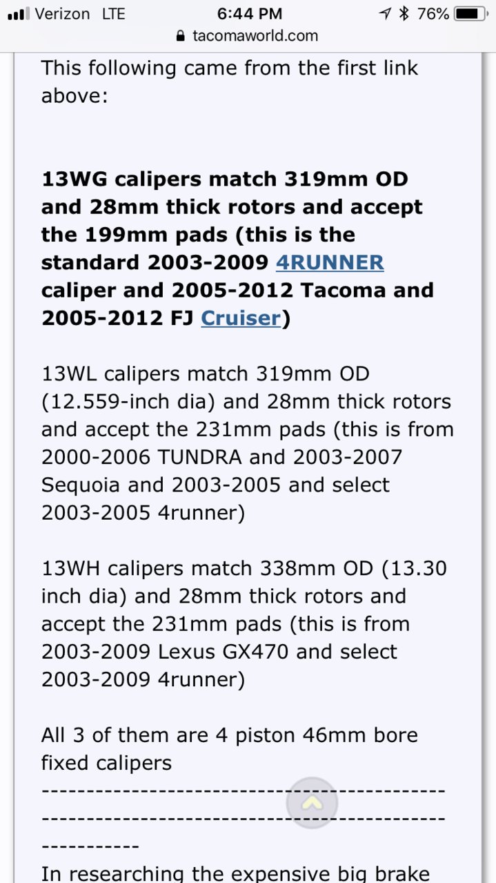

    03-09 4Runner had 3 different size brake options. The biggest was shared with the 03-09 GX470. The reason why everyone calls it a Lexus brake swap is because the Lexus only had the one size of brakes. For 10+ 4Runner/GX460 there is only 1 size of brakes. Either way they're all a 338mm rotor that requires a 17" rim, and they all can be retrofitted onto a Tacoma.

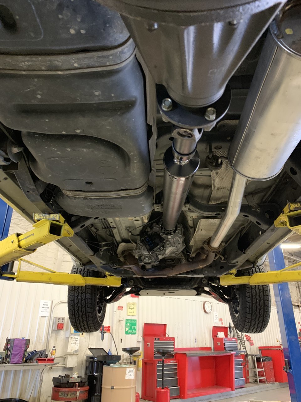

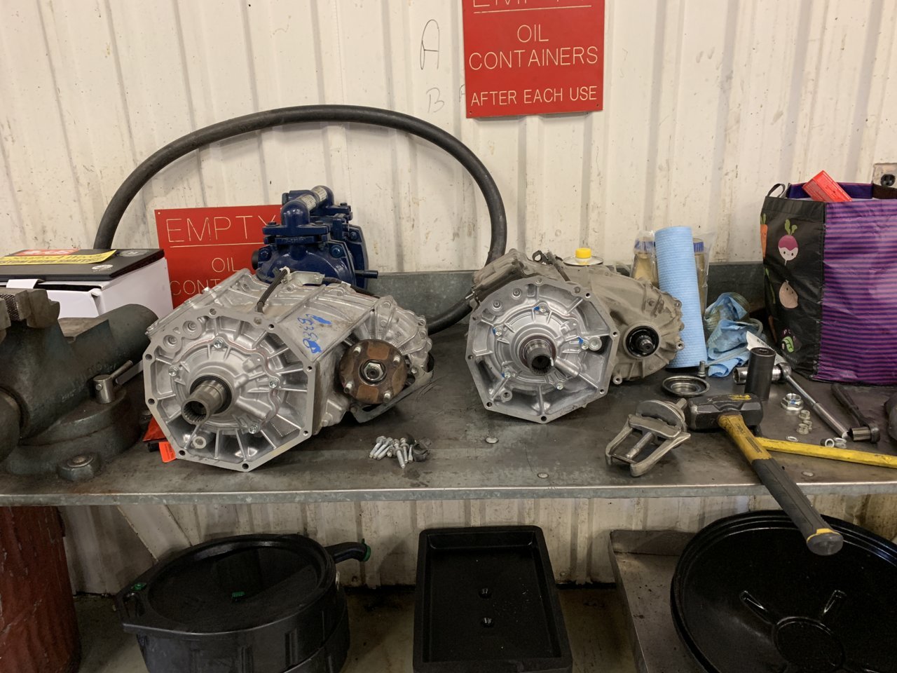

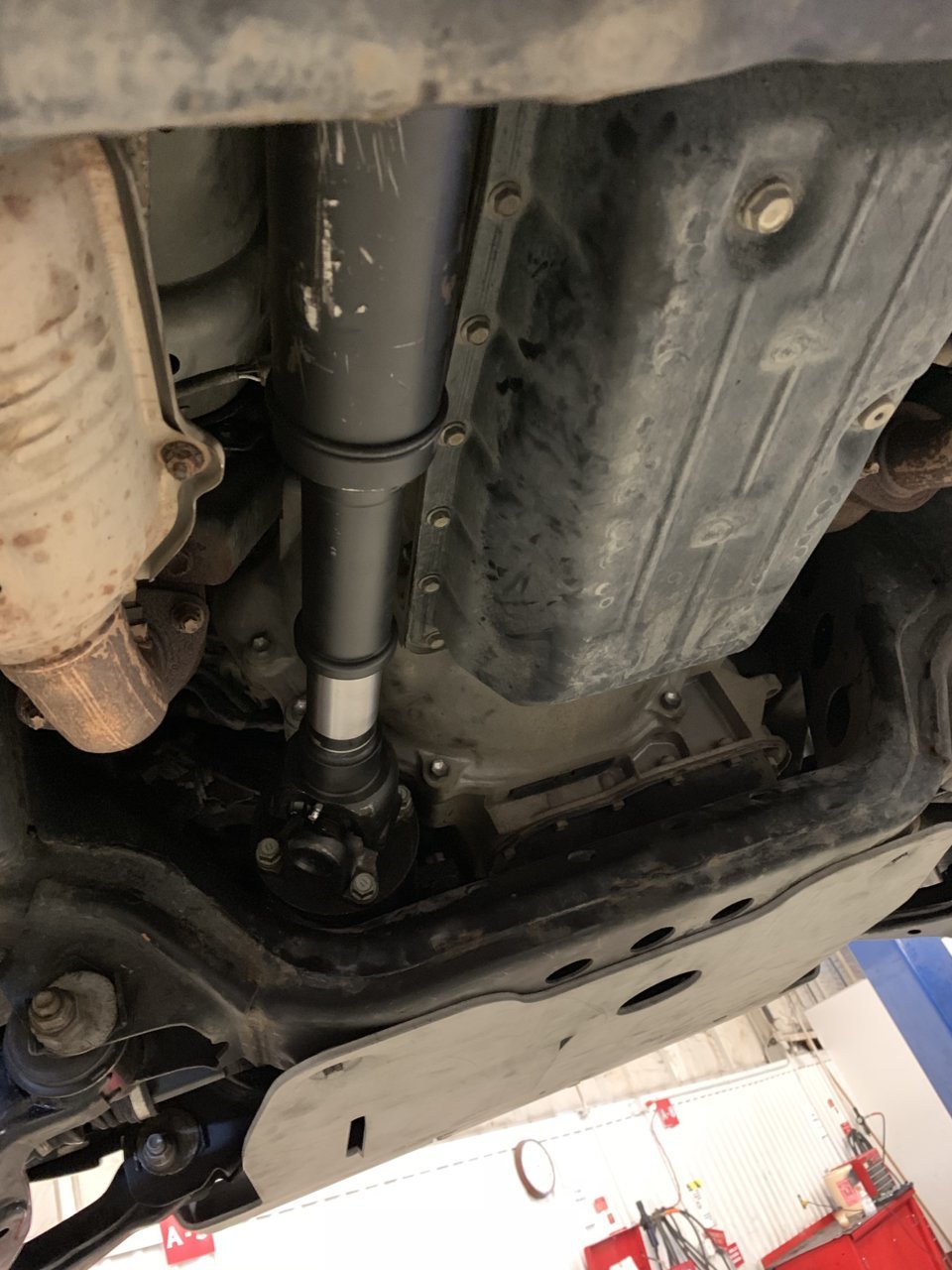

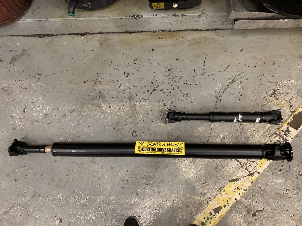

    It drives! I’ve only driven it the 70 miles back from the shop, but so far so good. I still have to figure out the wiring to get 4LO and center diff locking to work. The front traction does take some getting used to, but it’s not bad. I need to drive it a little more to really get a better feel for it. Definitely feels like a completely different truck.
