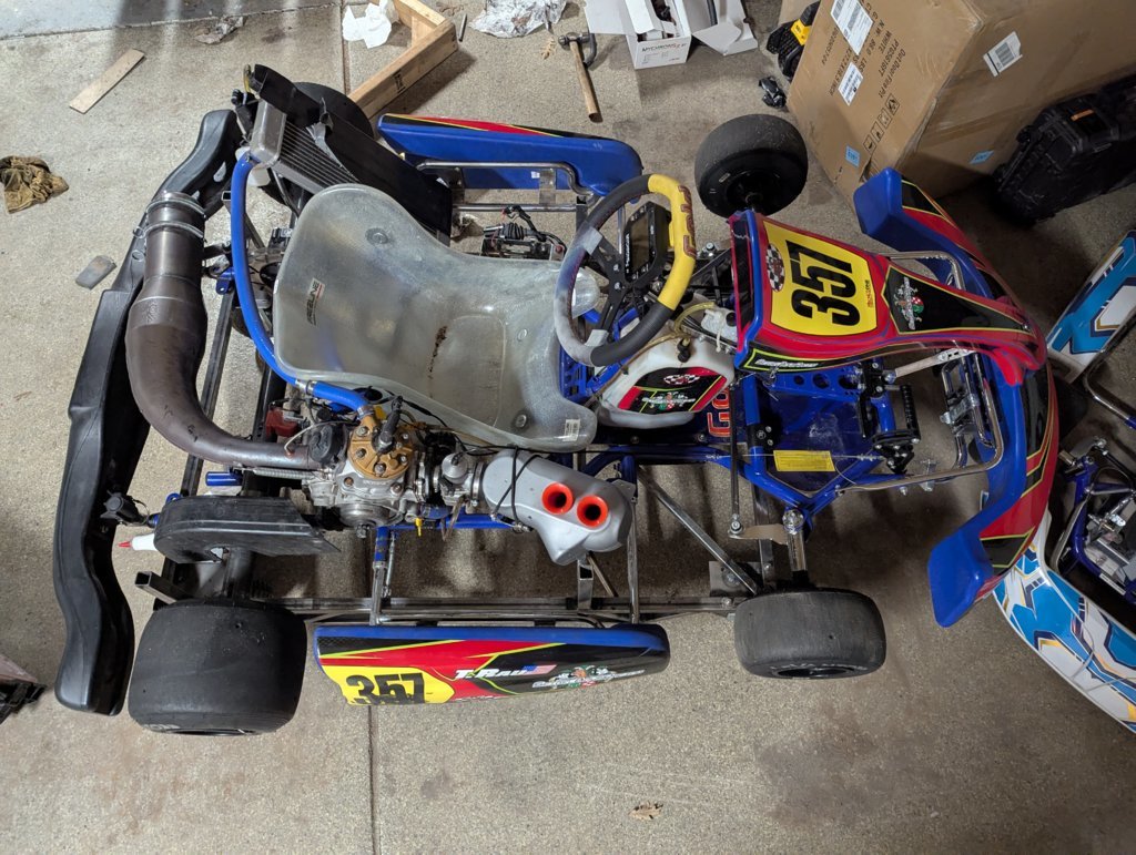

    Holy crow, that thing is a large shed on wheels. I, personally, would look at no wider than a 7’ wide trailer (7x14 or 7x16) and consider a 6’. One thing you didn’t mention, are those go carts dragsters?

    This is one of them. I usually take 2 karts. Fuel, kart stands, tools, an extra set of rims and tires. Occasionally, I'll take 5 karts.
