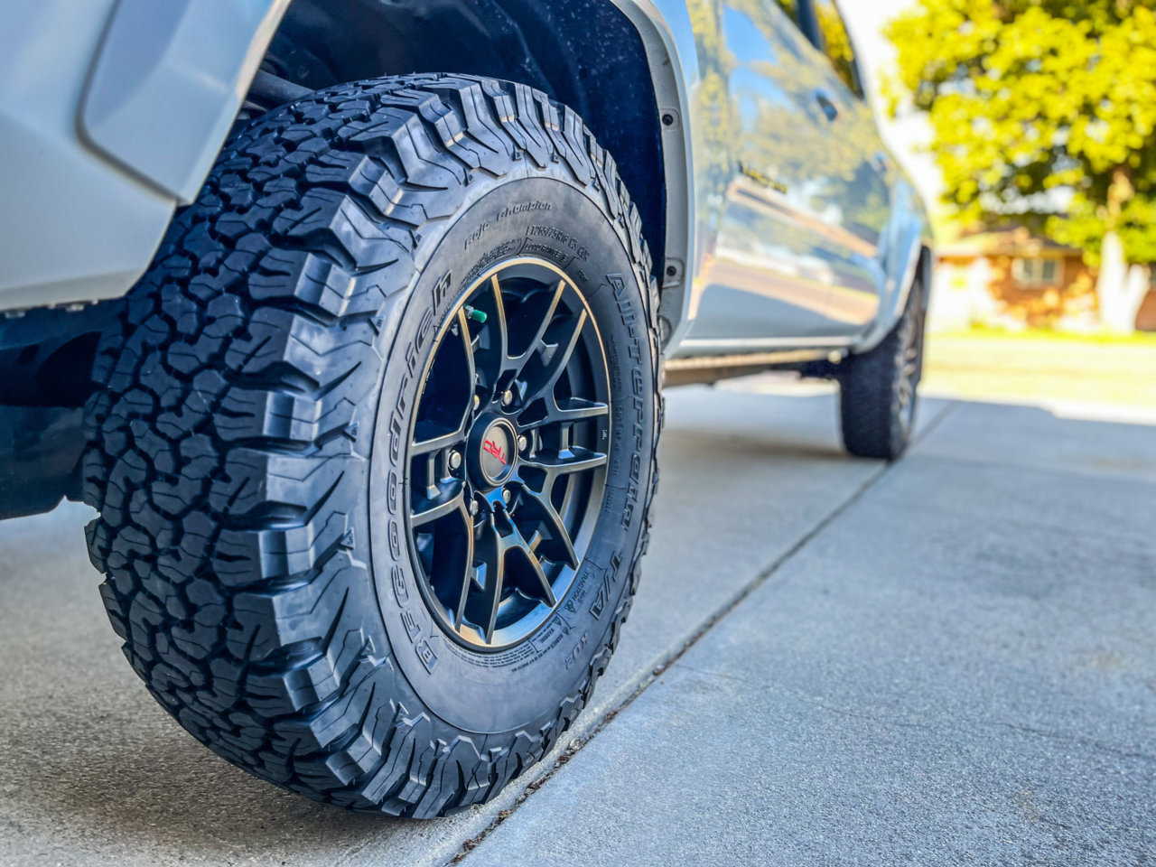

    I got a set of 265 75 16 KO2’s (E Load) installed from Costco the other day and they’ve been great. The ride really didn’t change much from my Toyo AT3’s.
    The KO2’s are smooth up to 85mph which is the fastest I’ve gone so I’m very happy with that.
    I did notice that the amount of balance weight on my front right tire was significantly more than the others. 8.75oz total.
    My question is if I should take it back to Costco and have them rebalance to try to get the weight down? Or, do I not ruin a good thing and just let it be since I’m currently riding silky smooth.
    I’m headed on a 1200 mile road trip this weekend so I’m not inclined to do anything significant until I return.
    Thoughts?

    Here’s how they balanced:
    LF - 1.00oz
    RF - 8.75oz
    LR - .50oz
    RR - 4.75
