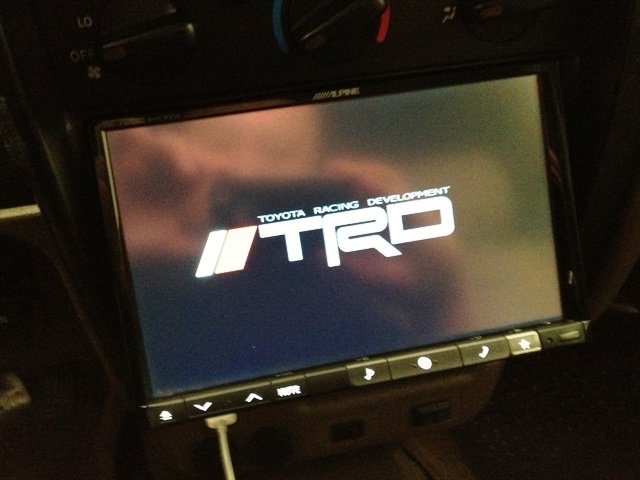

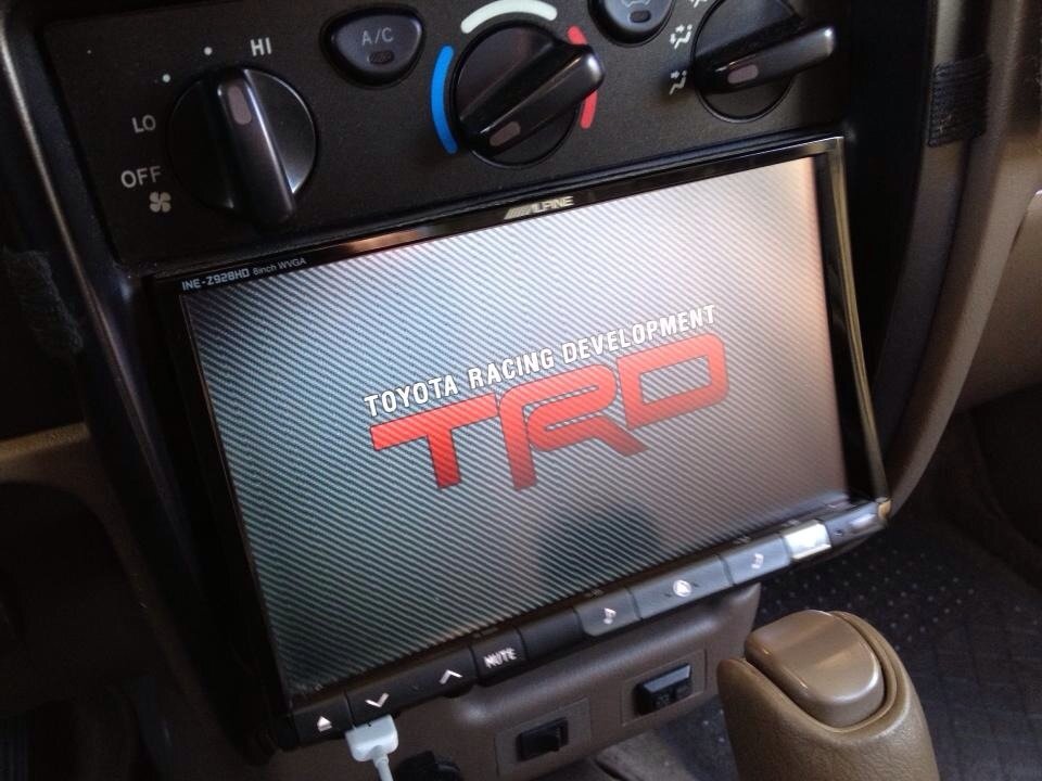

    Finally got my splash screen changed from the boring blue Alpine screen to this (sorry for the crappy cell pic but you get the idea):
    from this wallpaper:
    TRDstripes2forblackboxinthetruck_zps5976_4bd9efbc613a00886df5d10babd791db5958d0e6.jpg
    to this on my truck:

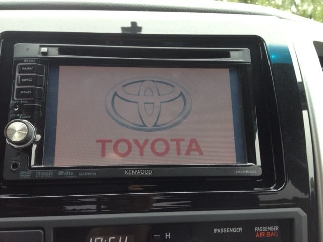

    Here's mine on my Kenwood DNX5120.

    Mine was done with a USB thumb drive and a sequence of buttons I had to press to get to the customize menu.
