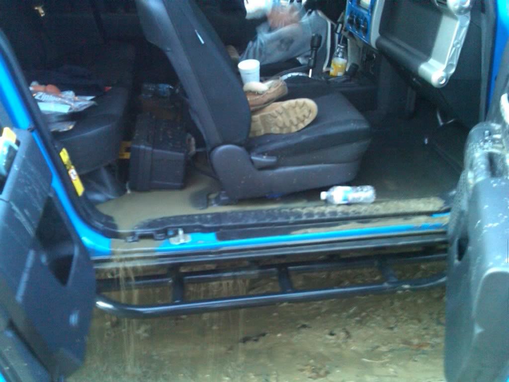

    Also if you keep moving the water doesn't seem to infiltrate even with the windows open (not that it maters because of the pressure release vent behind the cab). I have only had issues 3 times out of hundreds where water got in the cab and each time it was due to being stopped. Each time it spilled in through the door seals of my access cab and came up from under the carpet.

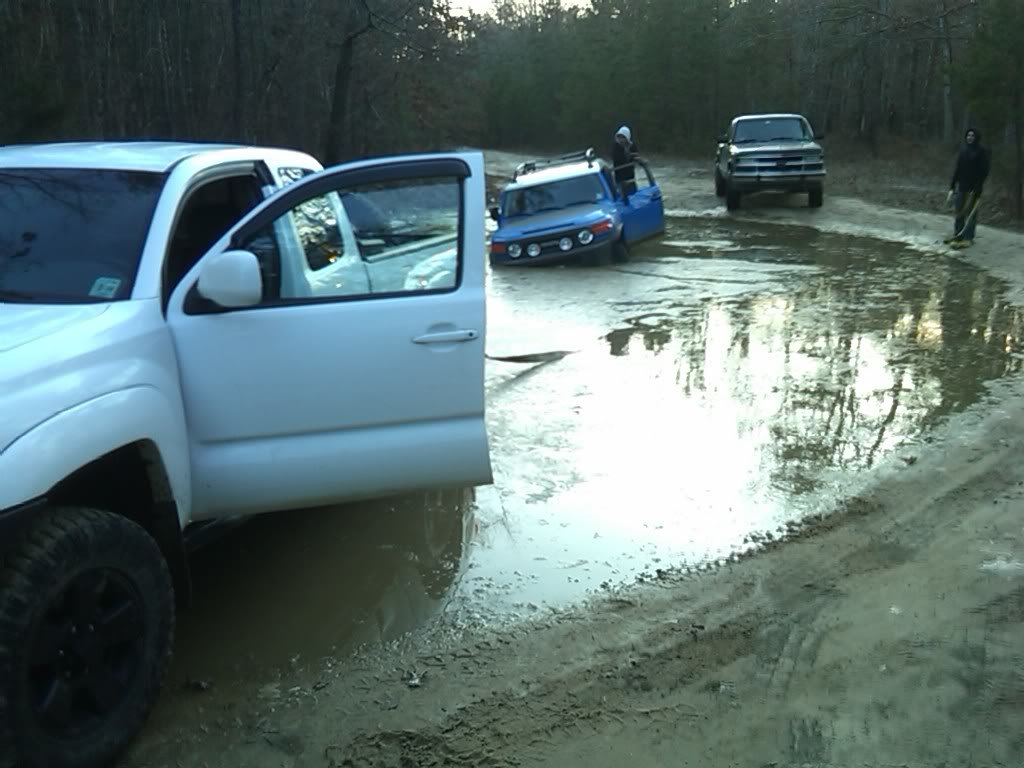

    To date this was the hairiest longest sub run I have made over a road I have never driven on. It is an access road next to an overflowing river.
    wake
    a little more speed and this wake would of been perfect.... also note he is heading into the current correctly

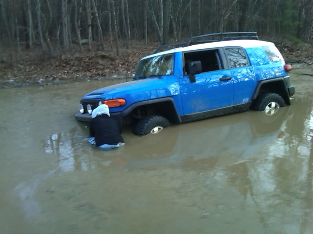

    Either way everyone need's to remember what happens when it goes wrong and be able to accept the consequences when you derp the herp
    one of my derps...cost me a starter and hours of cleaning
    friends derping
    hypothermia set in right after this pic (note the ice water)
