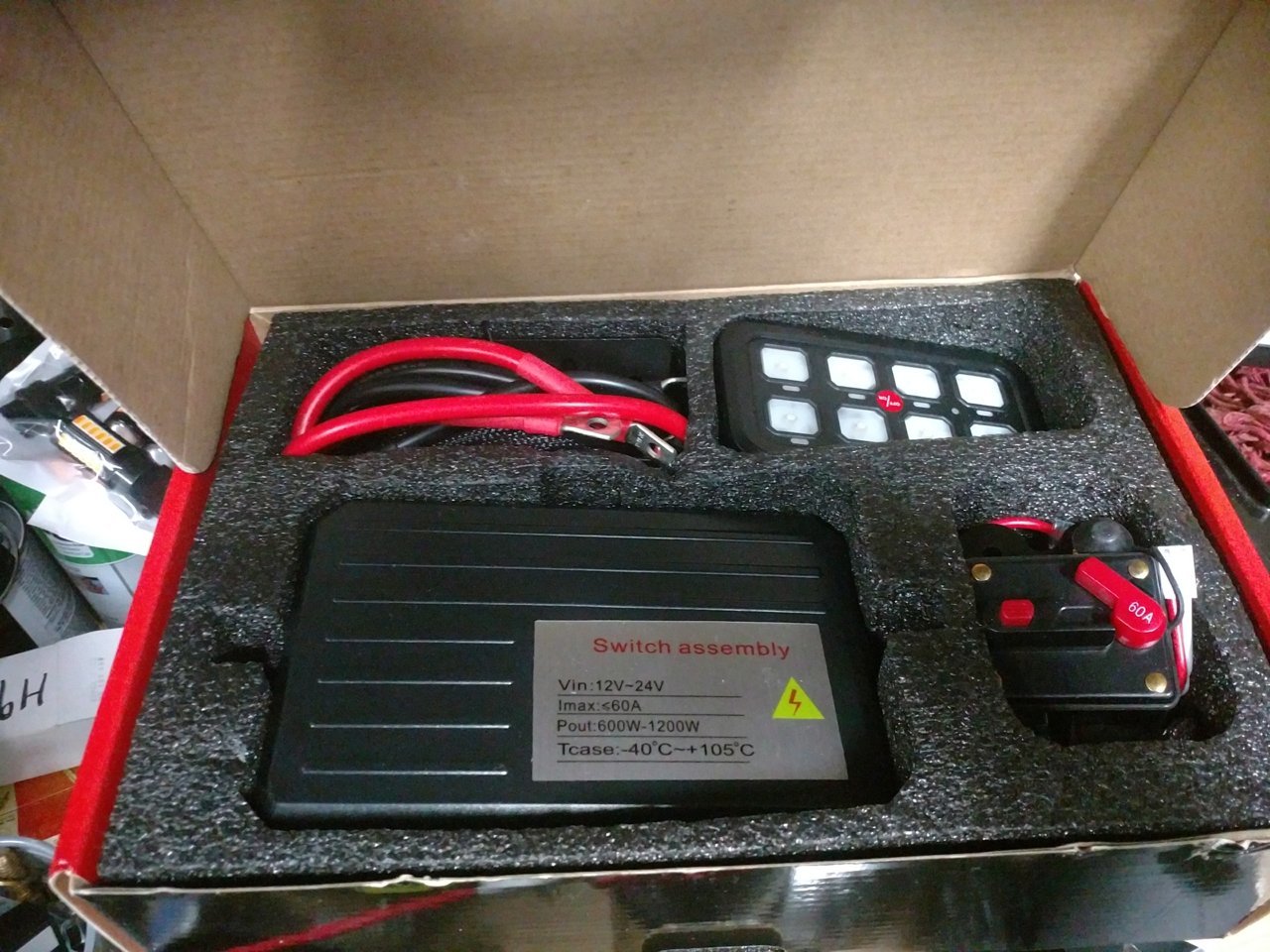

    Has anyone ever used one? Any input will be appreciated.

    Everything on my truck is already hooked up. Just want to better organize under the hood. I found this panel on eBay under $50.

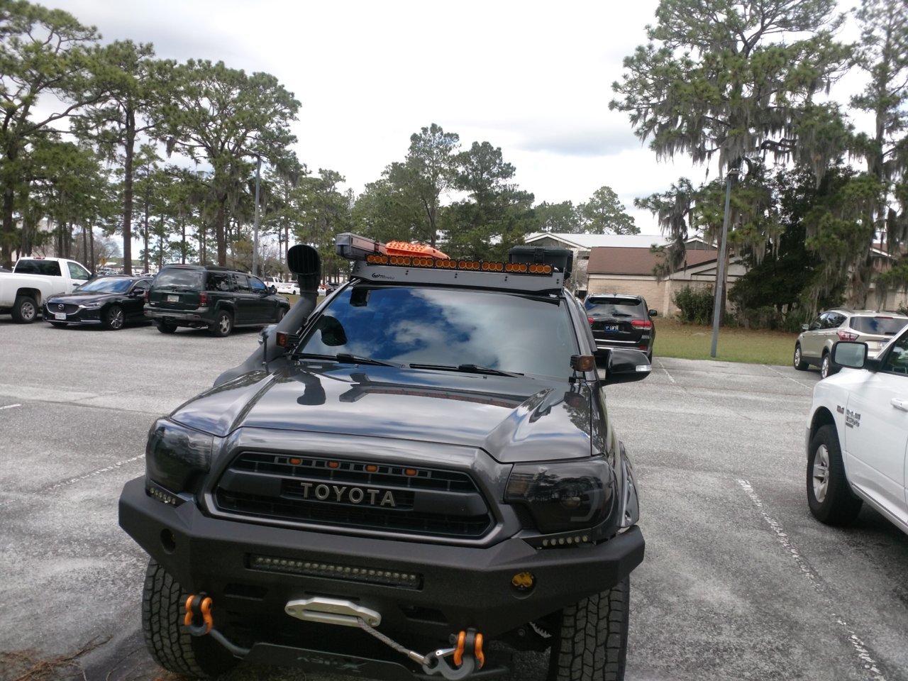

    Any pics of what you have going on under the hood?

    I'll take a picture tomorrow. Everything is running direct from battery with a relay and in line fuse.
    I got this really to have a neater engine bay and my switches all in one place

    I just wanted to hear other's experience with this.
    Is the backlight annoying to drive around with? I'm thinking about putting it on the outside of my sunglasses holder.

    It's not that bright. I had it down on my center console though.

    For some reason mine isn’t working. After hooking up to battery the switch thing won’t turn on

    There is a small gauge red wire that also has to be hooked up to a 12 volt power source or it wont power up. If you take the white wire and touch it to a 12 volt power source once you get it working you will get 4 brightness levels.
