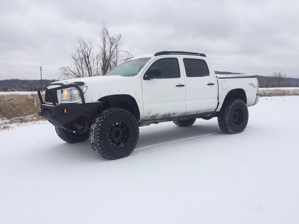

    Just a few
    How about you just cut a little and fit 35s?
    Here's mine....3 inchs with 35s
