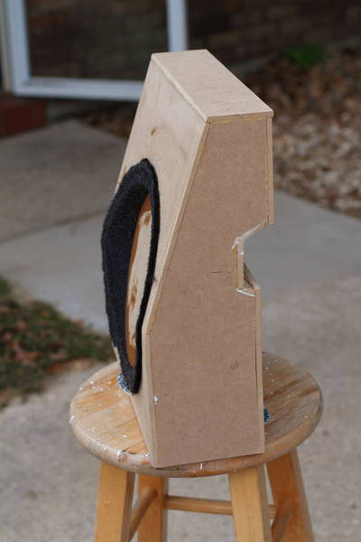

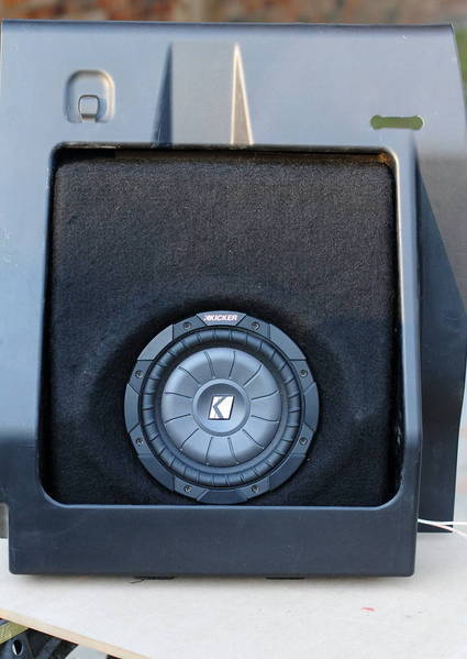

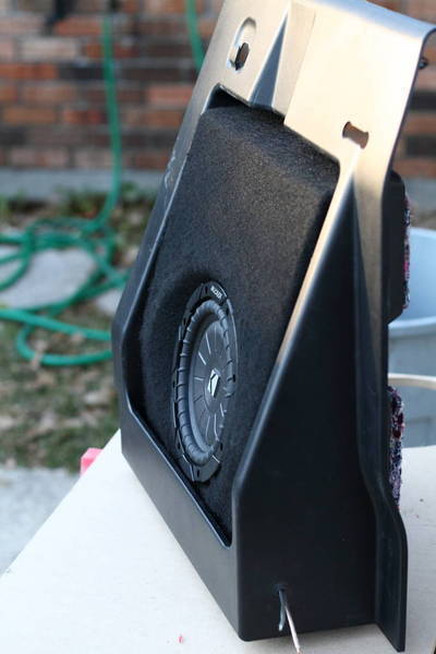

    Here is a box going into my buddies 2008 Tacoma Double Cab.
    Looking at all of the other boxes, install involved cutting or completely removing the cargo bins behind the rear seats.
    We decided to go a different route. I left the drivers side cargo bin with another friend who used to manage a car stereo shop. A few days later, and this is what he came up with. Its a Kicker 8" CVT 2 ohm sub running off an older Kicker KX400.1 that is under the drivers seat.
    The only mods done to the truck for this are a hole for the speaker wire in the cargo bin and cutting off the child's seat hoop behind the drivers rear seat.
    Its being called "The eyeball box" because of its look before the carpet.
    15 different pieces not including the internal bracing.

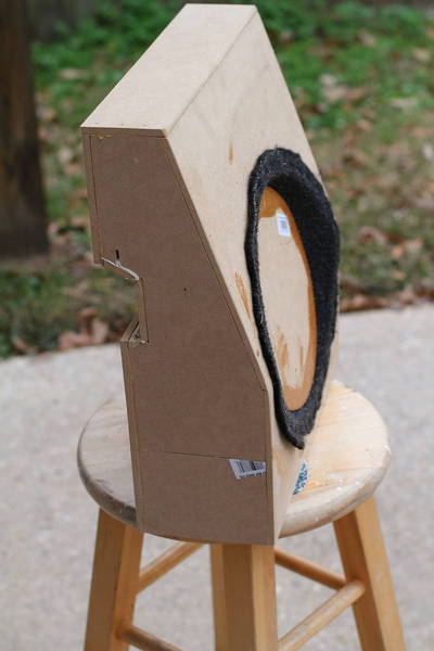

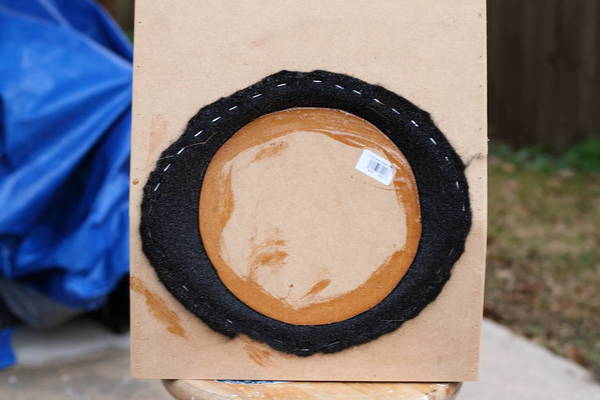

    Nice design but that's some thin looking wood
  5. Jan 23, 2011 at 10:41 AM
    PX213
    PX213 [OP] Member
    Jan 23, 2011
    #49733
    7
    New Orleans, La
    2008 Tacoma
    It's 1/4" MDF with a layer of fiberglass over it all.
