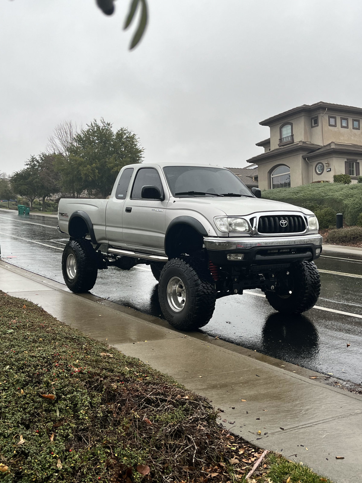

    You expect us to believe you have 11" of IFS suspension lift, that stock has available down travel of less than half that?
    Your pic is clearly a drop bracket or similar frame cutting lift...
    At least you don't get water in the cab, though. And no short chicks, presumably.
