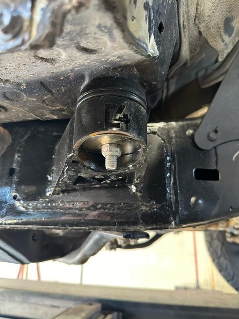

    Update: Found something suspicious
    They put washers on the driver-side cab mount to make the truck sit level. Both sides were identical pre-accident. Not sure if this is standard practice with cab mount relocates. Anyone know? Also the welds look like week old garbage.IMG_2119.jpg IMG_2118.jpg

    Are those aftermarket cab mounts?
    I thought that truck got a new frame.
    As a fabricater, yes those welds are horrible!

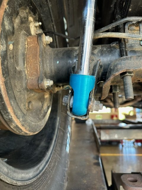

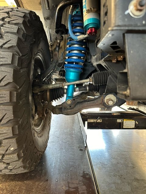

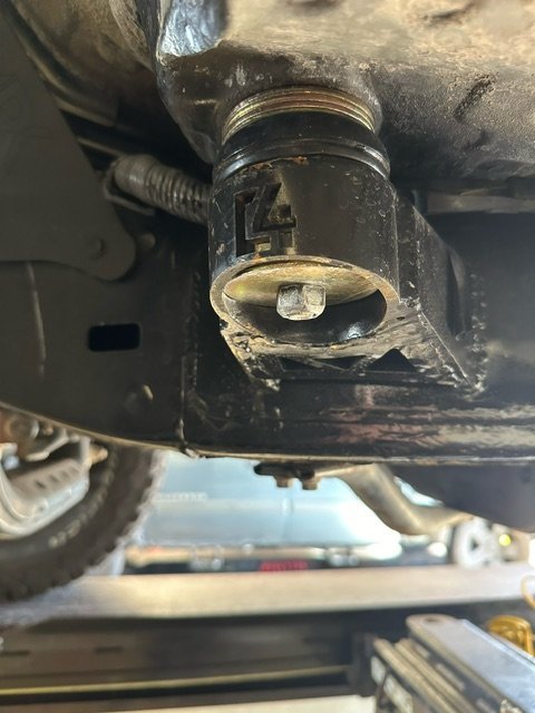

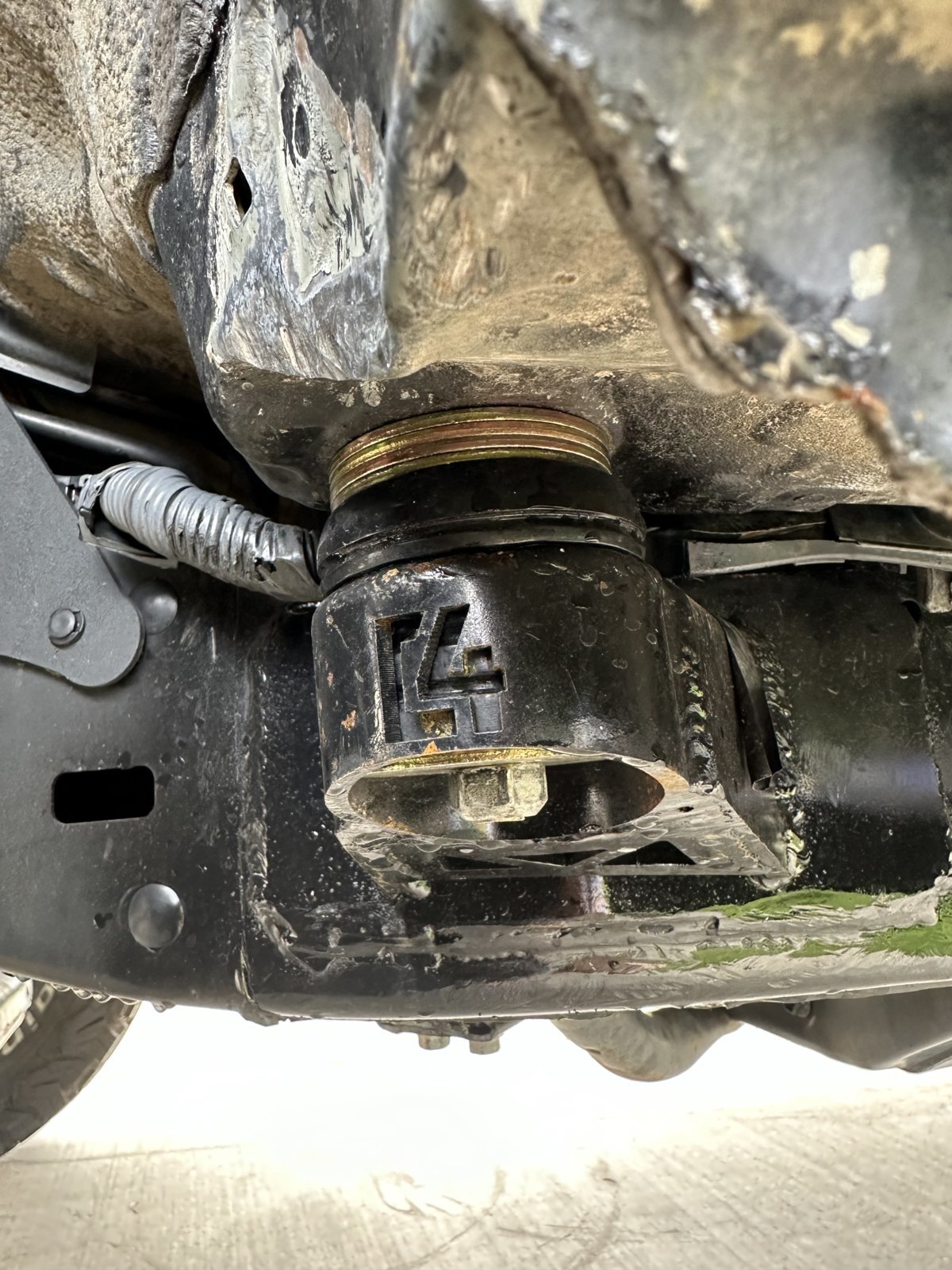

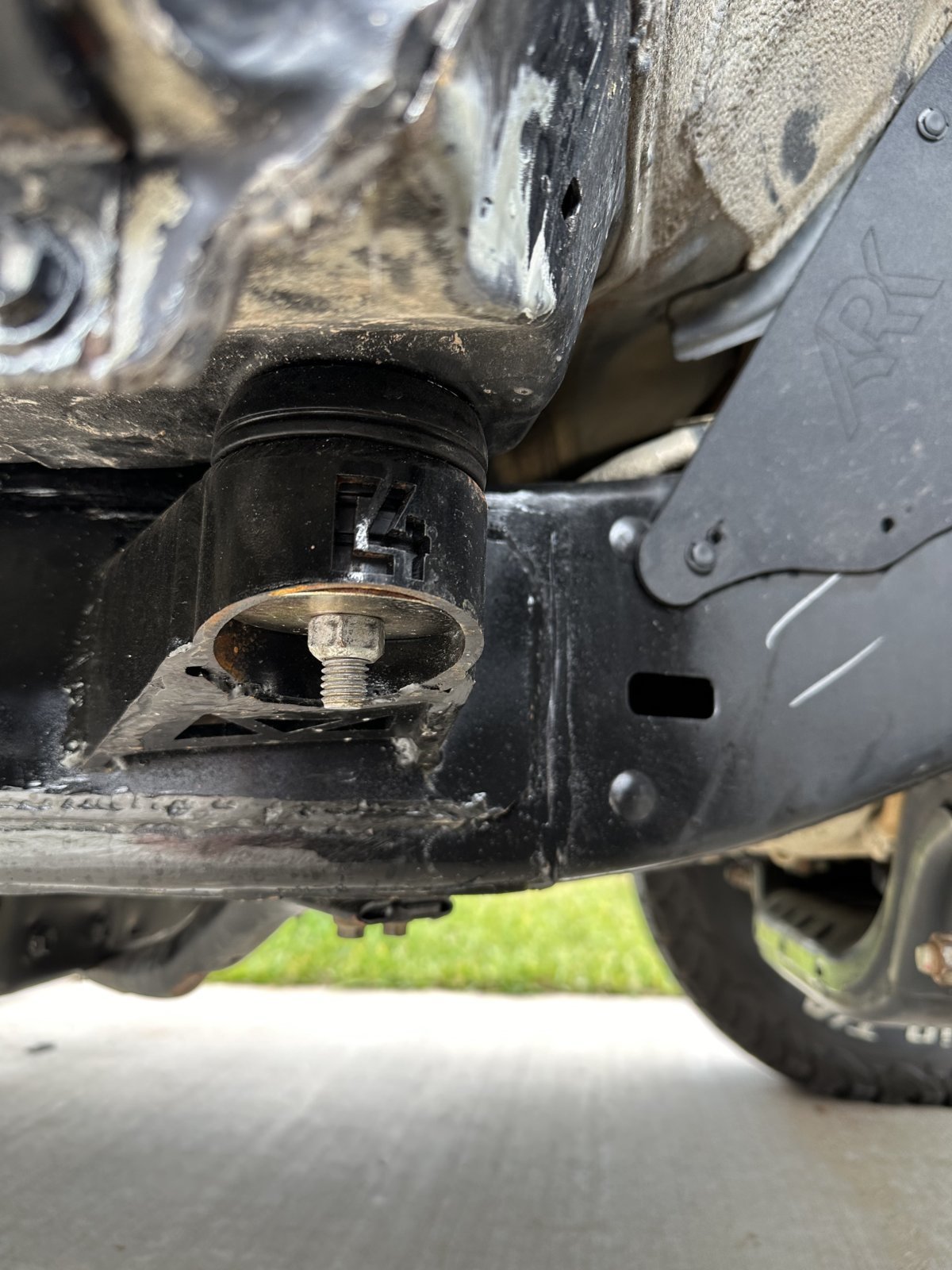

    Things that I noticed:
    1. On the Driver Front Cab Mount, they used 4 washers to make the truck sit level. This was not there before the accident.The passenger side just has the rubber bushing as normal.
    2. The truck seems to be slightly lower on the Driver side. The Driver side CV axle appears to be at a flatter angle compared to the passenger side.
    3. The rear shocks are mounted crooked into the axle assembly. They used to be perfectly straight.
    4. There is a creaking noise coming from the Driver front wheel well. Video Below.
    Driver Front Cab Mount.jpg Passenger Front Cab Mount.jpg Driver Front Suspension.jpg Passenger Front Suspension.jpg Driver Rear Shock.jpg Passenger Rear Shock.jpghttps://youtu.be/5LdyNrHOCFg

    Assuming they installed a new, undamaged frame (not all new parts are undamaged), then the cab is out of square. Could just be the mount is bent, could be a lot worse. Regardless, that's not an acceptable repair.

    The rear shocks are fine. You can twist the shock shaft to center them up, if it bothers you. I have no opinion on the other "issues".

    It is an aftermarket cab mount for more tire clearance put on by the collision shop (I assume). They just f'd up installing it.
