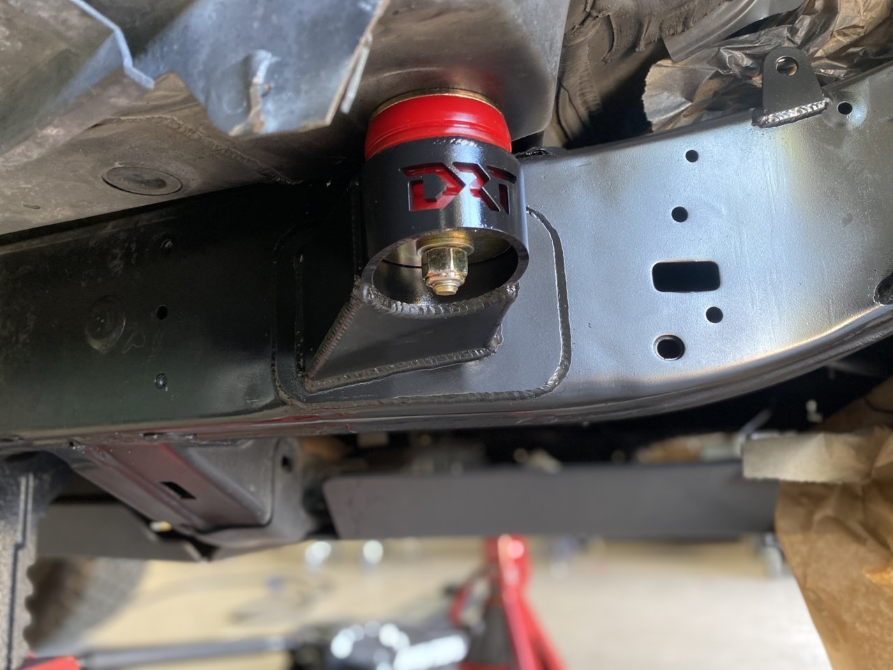

    They had the body on a hoist.
    They rolled the chassis under the body and lowered the body to the somewhat correct position.
    Most likely the hoist arms and floor are not perfectly parallel.
    The fact that the welder had lay on the floor to install the mounts probably pissed him off because there was a perfectly good hoist sitting there.
    A can allow the spacers, the welds are what bother me.

    Not perfect, but to the exact same quality as it was before the wreck. Nothing aftermarket is perfect

    22 Barcelona Red TRDOR 6MT worth the wait !! Hang in there !!
    At this point I would document it with pictures, buy a new set of mounts, and take it to a quality shop who does this sort of thing, and pay for it. Submit it to the insurance company for reimbursement. Worse case you pay for that out of pocket. You can always look at your long multi-page invoice and see how much parts and labor you have in that relocated cab mount job. Then ask for a refund since it was not done properly. Not ideal but probably the only way you can get it done right.

    You need a fab shop. They cut them off, clean them up and properly weld them back on.

    I would consider this if I 100% knew that the cab mounts are the only issue. Who knows what else is hidden underneath all the work.
    I have Collision Safety Consultants looking into the work. We'll see what they say

    Looks like the driver's side mount was welded on a little lower that the passenger side was, and the washers appear to be and attempt to make up for that difference.

    You're correct. Driver mount is welded about a quarter inch lower than passenger mount. It's hard to get an exact measurement with all the extra material though.

    Looking at the manufacturer's photos, @drtfabrication, it looks like the use of a washer is acceptable... but maybe not 4 of them.

    Interesting....it looks like the cab mount is supposed to have one washer on each side (per c4 fab). My truck has 4 on one side and zero on the other.
