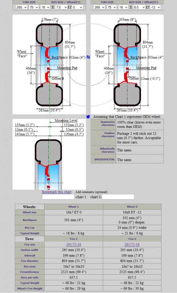

    I started running numbers and I came up with this -
    From what I've found, the stock 16" TRD wheels are 7" wide et32, which is 5.25" backspace. Can anyone verify this??
    I have 1.25" Spidertrax spacers on my 16" TRD wheels. 1.25" = 31.75mm.
    If my math is right, the specs of the stock 16" TRD wheels w/ the spacers
    is 7" wide roughly et0.
    So I plugged in the numbers and came up with this....
    According to this, 8" et -12 (4" backspace) sticks out 12mm (1/2") further the the 7" et 0. Does this seam right?
    Or if its easier, is there anyone running 8" wide wheels with a 4" backspace (et-12) ??

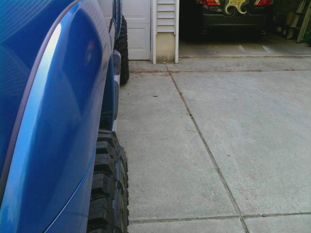

    This is the only shot I can find which really shows the wheel poke from head on -
    And for comparison, these are 8" et-25 (3.5" backspace), which should stick out 1/2" further than 8" et-12 -

    At a glance though, it seems like you should probably lose the spacers...

    Definitely losing the spacers
