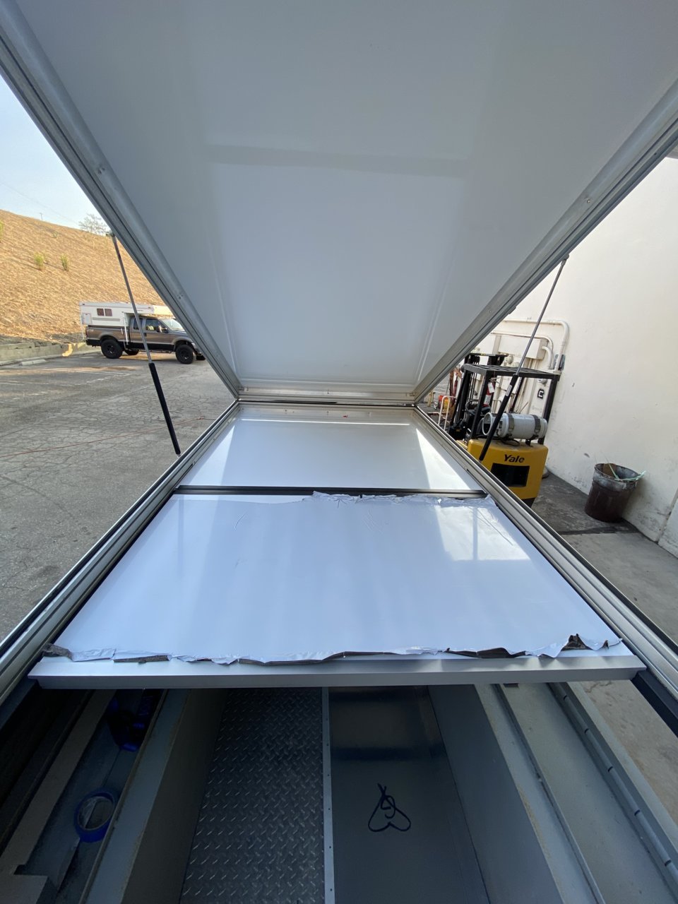

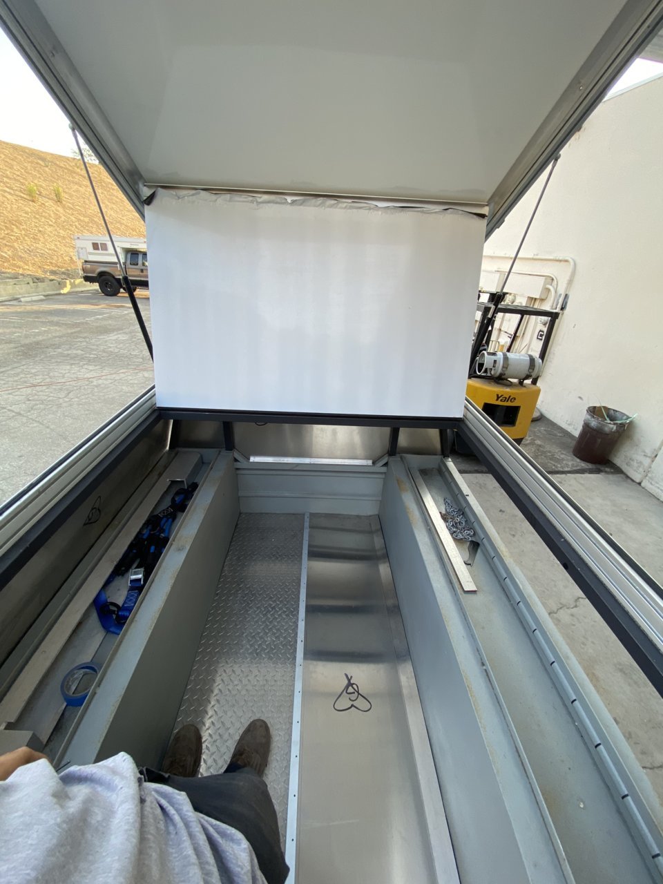

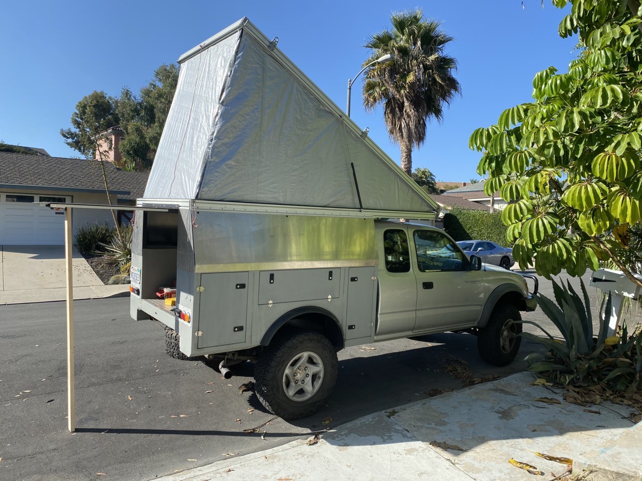

    Made some real progress and got this thing usable for my elk hunt the last 2 weeks. Worked perfectly. Tarp is temporary until I make a real tent for it. Need to get struts and latches for the side and rear doors. Eventually I’ll wrap or powder coat all the bare aluminum.
    7F61743D-BBDC-431E-965C-18FD885743B0.jpg 444B93A7-AAEF-4E30-9569-84F66A380E82.jpg F7DA059D-97B7-44D8-B86B-572362F2442D.jpg EF3B4578-D173-4103-B00F-DADFB3EFEC1C.jpg
    TRD_IV, Gunshot-6A, PzTank and 7 others like this.
  8. Sep 27, 2021 at 7:27 PM
    #48
    garrettG1991
    garrettG1991 [OP] Member
    Nov 1, 2017
    #234738
    17
    Garrett
    03 Tacoma 4x4 5 speed extended cab.
    Extended travel kings Jba uca's 33" tires Bora wheel spacers up front .75" Aluminum shell Modular camper build out
    roof and bed material are 6mm alumalite, wasn’t able to source reasonably priced honeycomb panels so I settled for the alumalite. I ordered 10mm and 6mm showed up, didn’t have time to wait for the 10mm so I ran it. Seems rigid enough, I may add some struts to the roof panel but the bed and fold up are plenty rigid the way I set them up.
