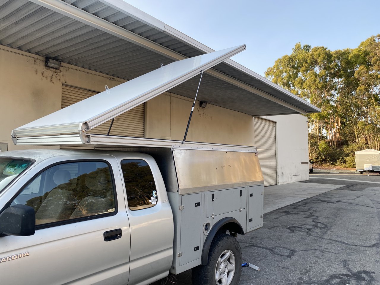

    Just following up on this. Back to the overhang and only having to carry your feet is not entirely accurate.
    It also has to carry to load of the roof minus the weight carried by gas lift struts.
    Mounting the lift struts inside has worked okay. the main issue is that the bottom end of the strut starts out above the bottom so you have to physically lift the roof about 8" in order to get it going and then the struts lift it to it's full height.
    For my tent I used 18oz vinyl coated polyester, similar to what Vagabond outdoors was using but I only used a single layer and they stitched theirs where I used HH66 adhesive. My sewing machine does not have a long enough arm to sew fabric that big.
    I used vinyl coated fabric for the screens and clear vinyl for the clear windows.
    It's 24 feet long and weighs about 24 pounds but it does not give a shit about wind at all. It's also 100% water proof.
    I made my trashbag on the back of the camper out of the same stuff.
    I highly recommend it but a heavy duty sewing machine is required.
