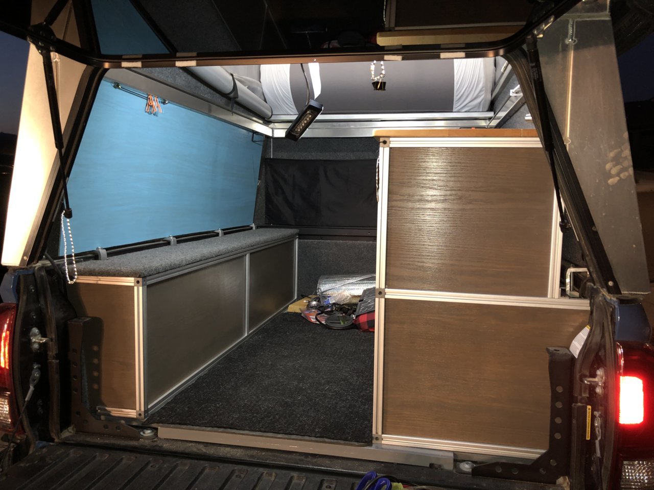

    For anyone wondering, I now own the camper and buildout!
    If you have any questions on the build, please DM me on Instagram: @socalexpeditions or send me a PM here, and I'll be glad to get back to you!
    Jerry did a phenomenal job with the interior layout and I've had such a hard time wanting to change anything. The functionality is perfect and dare I say nearly effortless; what separates this setup from others is that it's barebones, lightweight, and very easy to use.
    Here's what it looks like now! (minus the blue panel on the wall...stained that a horrible color and it became firewood).
    I’ve beat this setup up and it needed a refresh. I’ll be redoing the countertop, plumbing, sink/grey tanks, etc. Overall, killer build to take notes from and I’m glad to share!!
