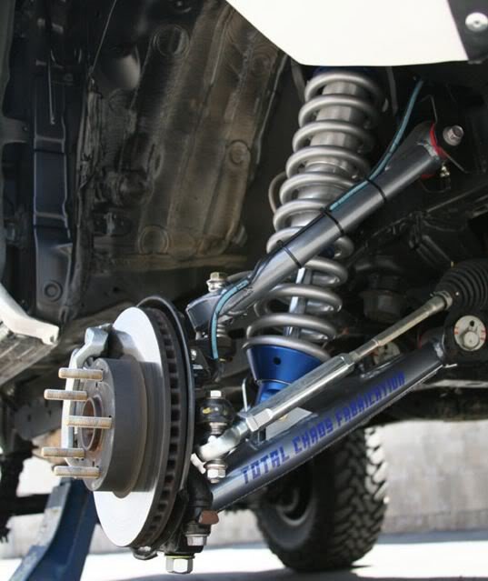

    How does the spindal actually push the tires out more? Wouldn't that also depend on how far my lca goes out as well, or what?

    those spindles are the exact same spindles i have... out trucks have very similar suspensions...
    the spindles is fully fabricated and the wheel hub is pushed out farther than stock, thats where you get the extra 2" track width per side.
    the spindles are sick, and the ability to ditch the lower ball joint and run a uni ball is so worth it... but the spindles and lower conversion is gonna run ya close to $2K. weld on gussets work and are def a must have in the mean time until you get whole new spinles.

    all of the pre cut gussets on the chaos site are for 6 lug spindles... non of them will work for you.
    2nd gen 5 lug spindle
    yes sir, that's them

    ya i was reading about them and what not. so i would only be running one uni ball then?

    if you buy just the spindles you'll retain the current upper uni ball you have now and the lower ball joint. if you buy the lower uni ball conversion too you'll replace the shitty ass lower ball joint with a 1" uni ball, just like what your upper arms have
    the cost of the spindles and the lower conversion (which also replaces the factory tie rods with heim steering) will run ya about $2K and solo requires you to send back your hubs from your stock spindles or they will charge you a $500 core fee

    you'd have to get some made... but i cant say that i've seen a 5 lug spindle gusseted before. might not be enough room... it's a small part
