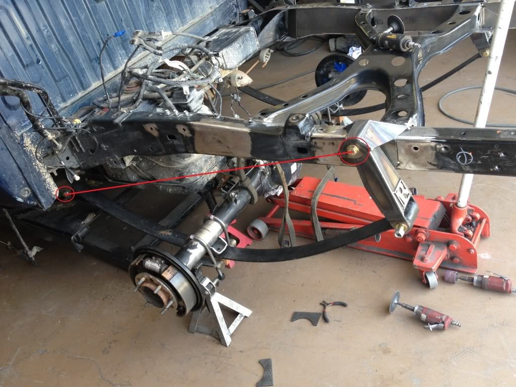

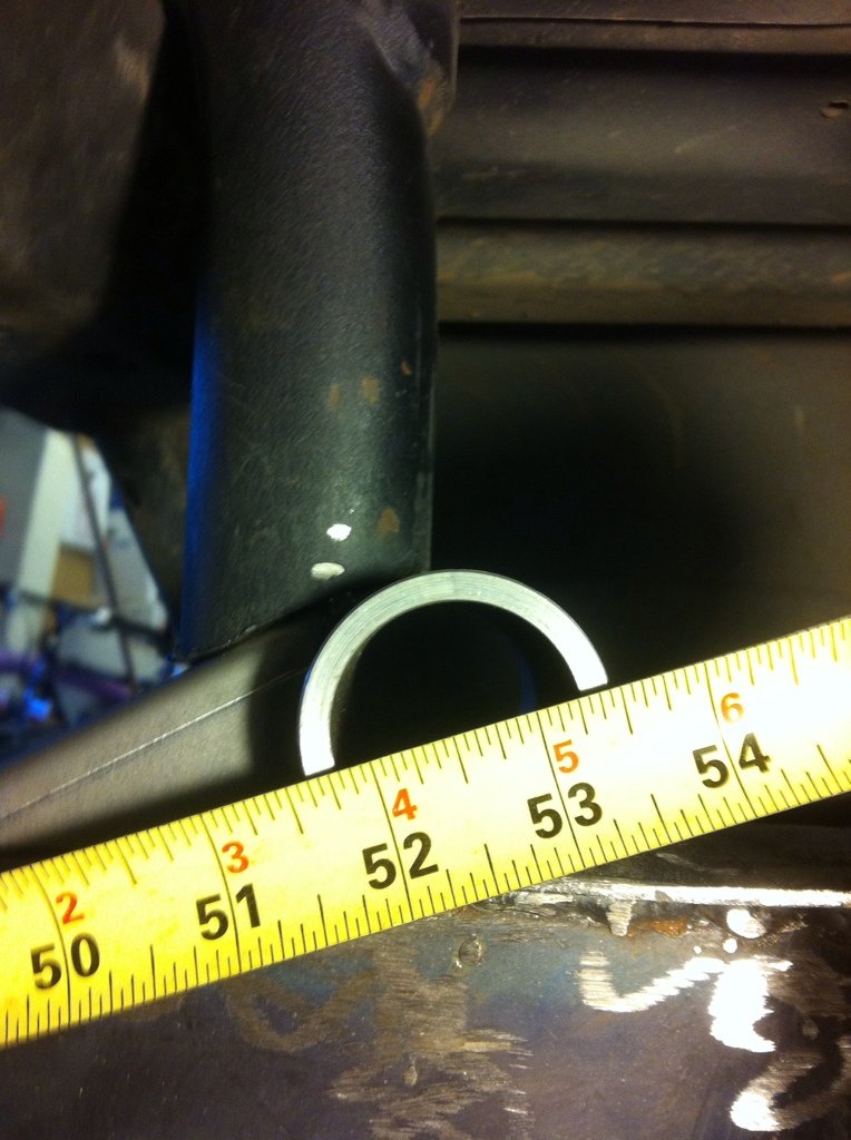

    51.5? 52.5?

    And where is that measured from?

    front hanger to the shackle location on the frame

    Like this :D

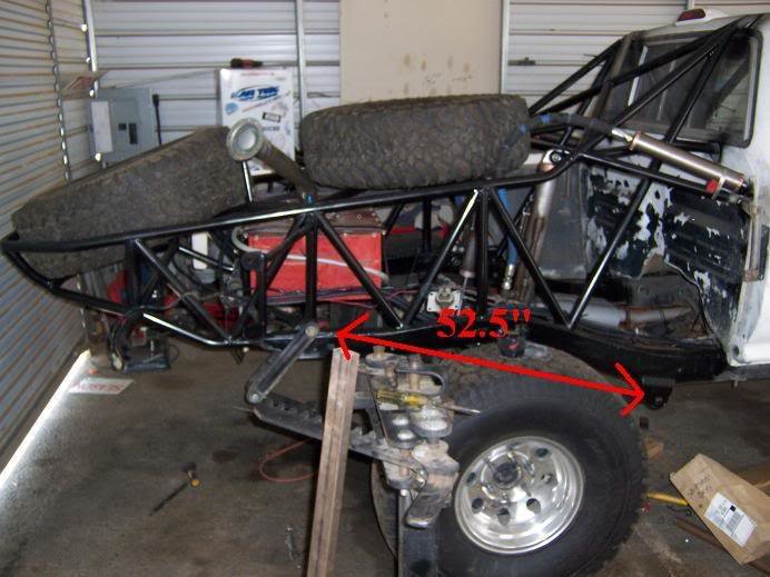

    figured i should put up a pic of a truck that actually has the magic number set up...:D

    with a 12" shackle right?

    Lol the tube bender lined right up with the shackle, I was like WTF at first
    Yes sir

    Its only two inches off :rolleyes: :brianr:
