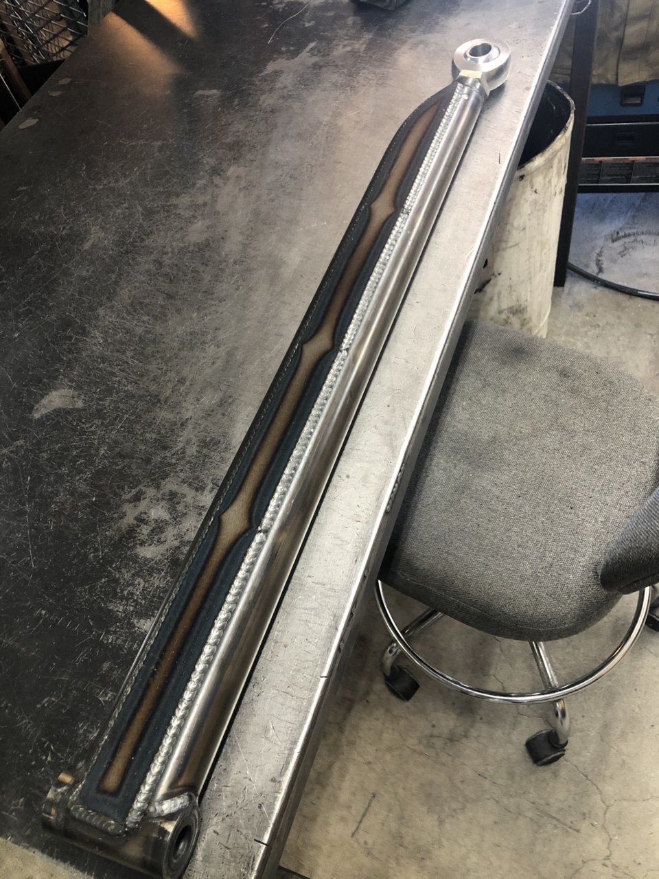

    Those welds are a joy to behold

    Thank you... I love mig welding clean cromoly

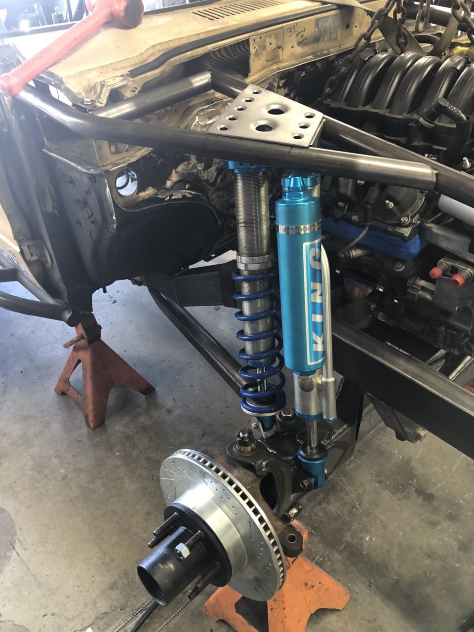

    @81Trekker what were the benefits of chopping the frame and starting from scratch with 2x4?
    What did you end up with for your upright?
    and hub/snout setup?(GM D44?)
    been planning out similar for my 1st gen tundra. Strength, suspension travel and reliability with 4wd is tempting.... Maybe do something silly and channel my inner Rough Riders and have someone draw me up equal length TTB's
  5. Jul 31, 2020 at 10:29 AM
    #185
    81Trekker
    81Trekker [OP] Well-Known Member
    Aug 25, 2019
    #303299
    3,750
    La Jolla SD
    81 Trekker and 2015 CCSB Tacoma
    Too many to remember
    It was easier to start over with fresh frame rails. I didn’t want to deal with cutting off all the old stuff so I just started over. I also moved the new frame rails up so I could get a little more up travel since I notched the crap out of my oil pan.
    I used the Chevy big bearing D44 6 bolt snouts as they bolt right up to the ford uprights. From there I was able to use the Chevy hub bodies which have the same 6x5.5 lug pattern as a Toyota. The rotors are off a Lexus GX470 which shares the same lug pattern but uses 13.5” rotor. I then cut the Ford caliper mounting ears off the upright and am making custom mounts to accept Wilwood calipers. I also drilled out the hubs/rotors and upgraded to Moroso 5/8” studs

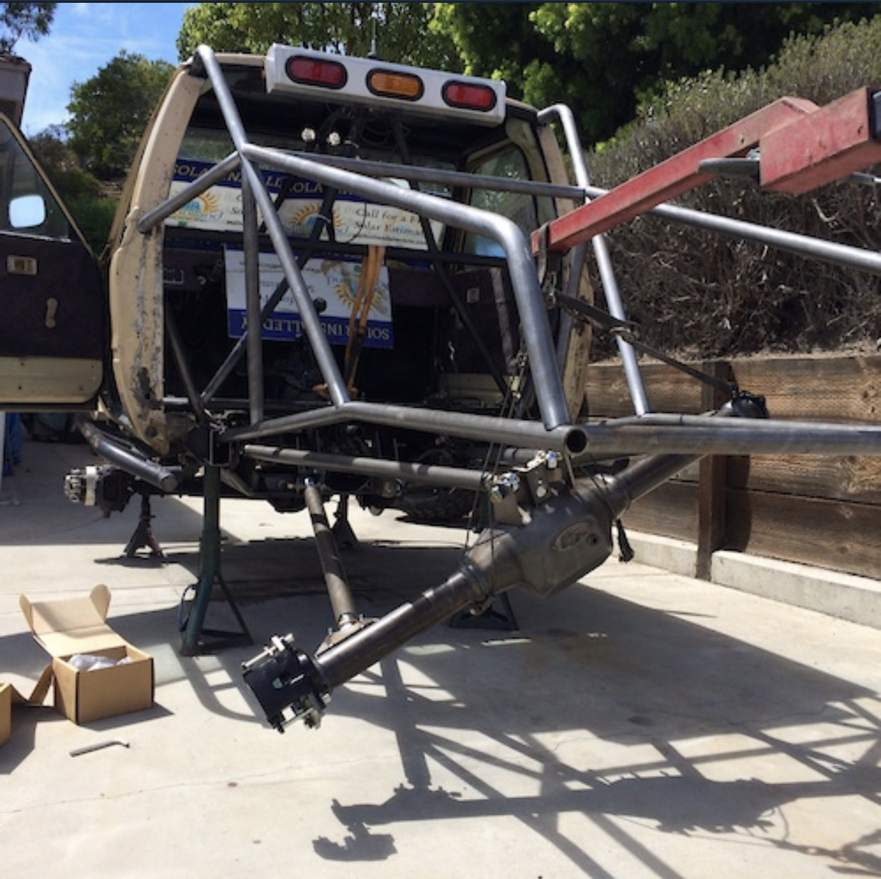

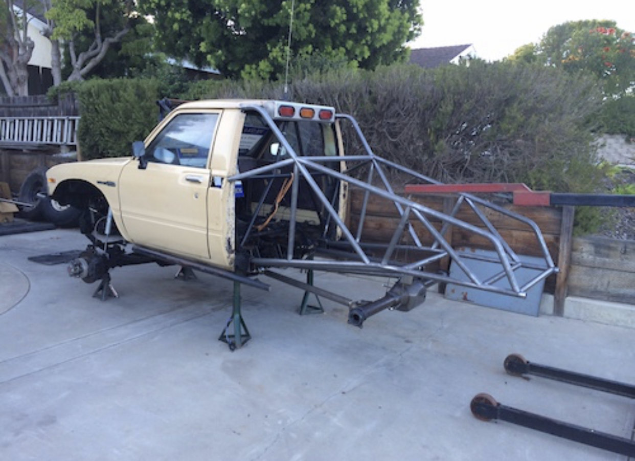

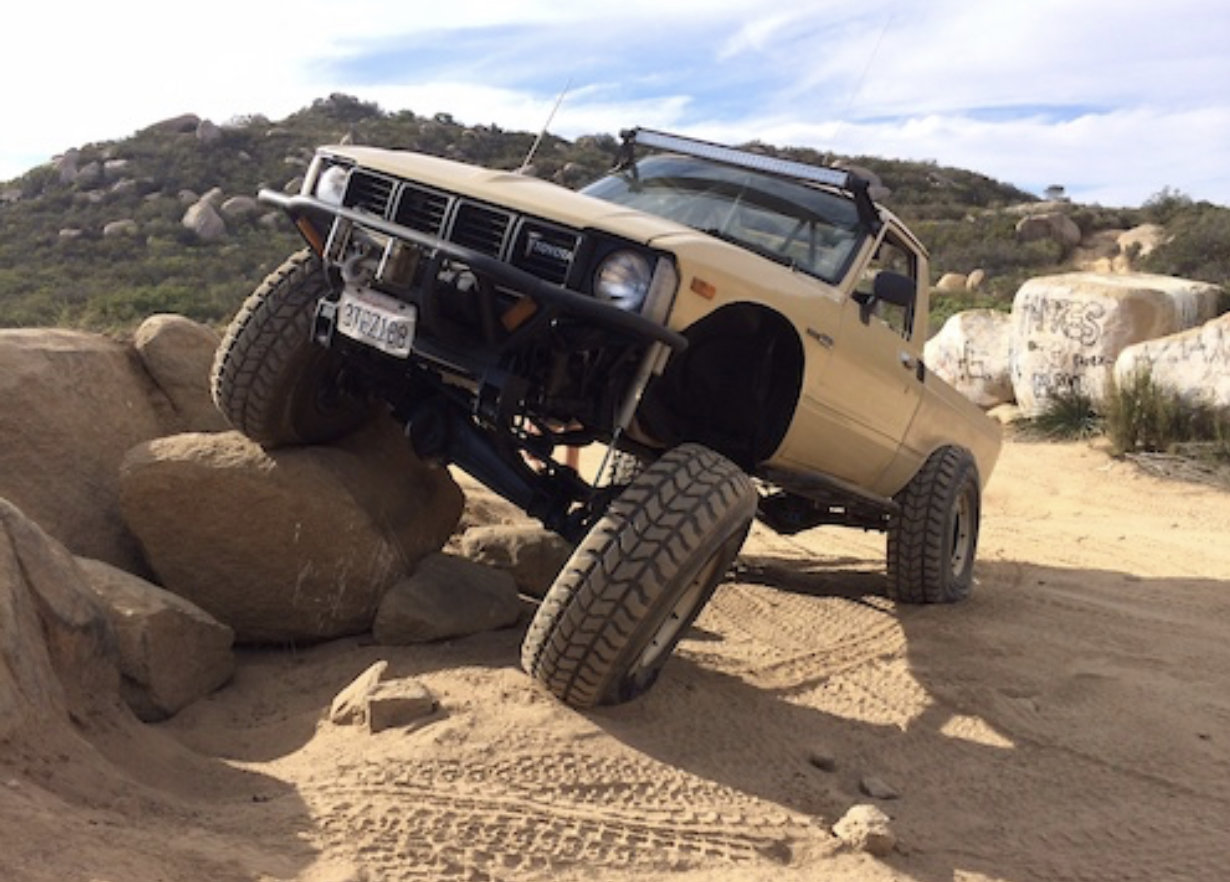

    Found some old pics from way back when it was still a Trekker!

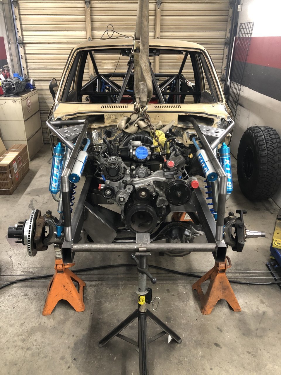

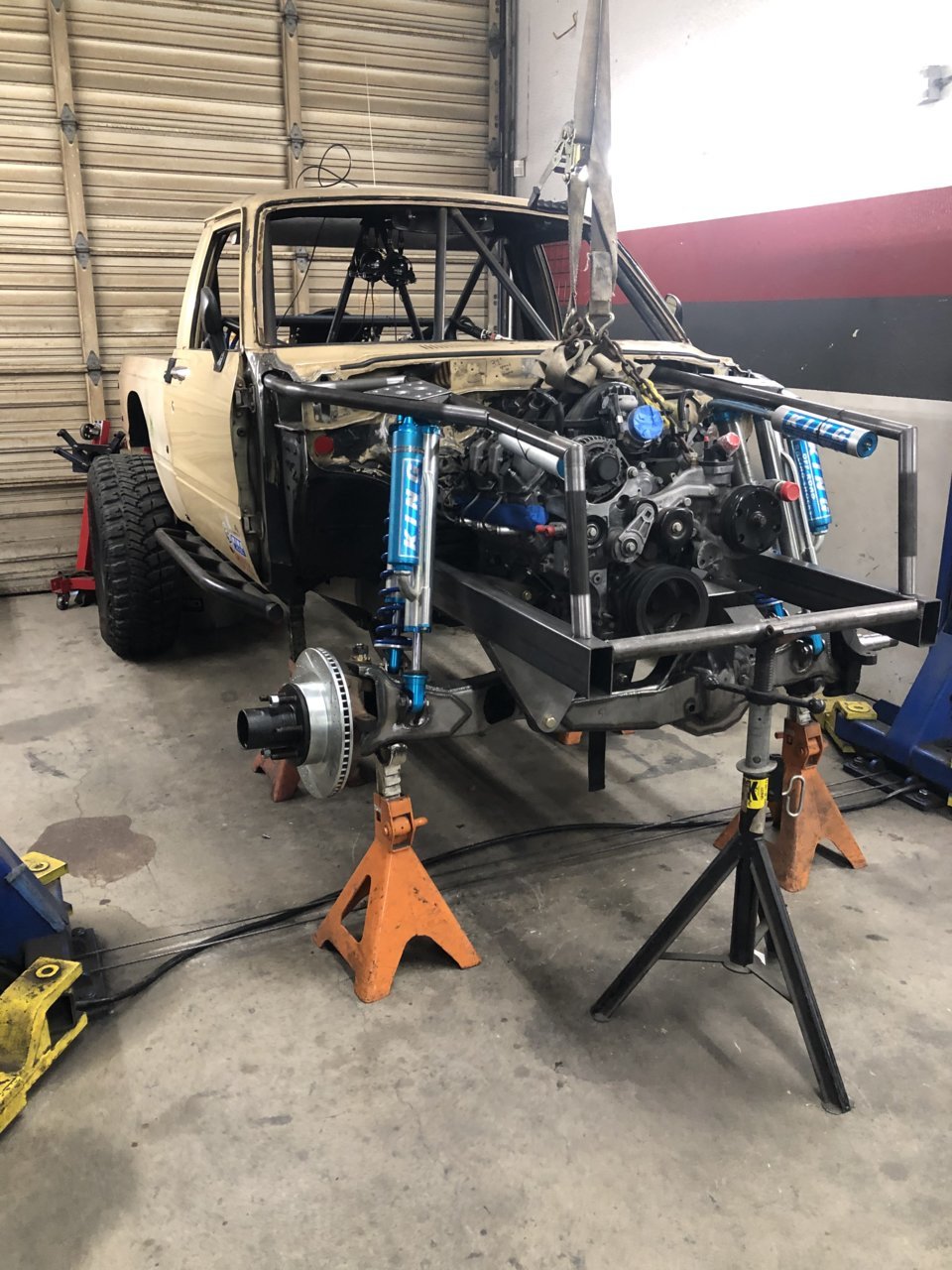

    Decided to take the afternoon off and make some progress... shocks are mounted and I started doing some tubes on the engine cage

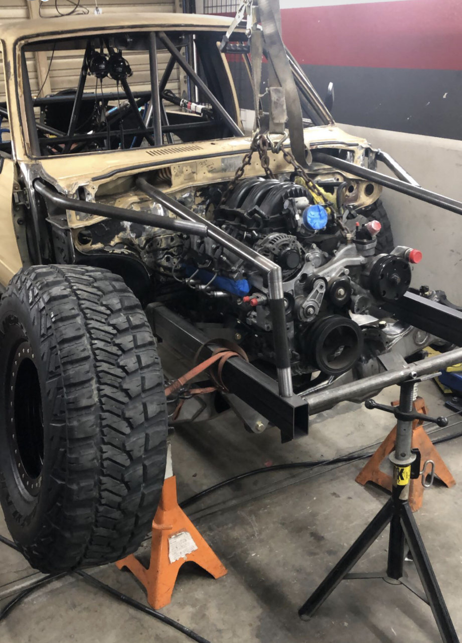

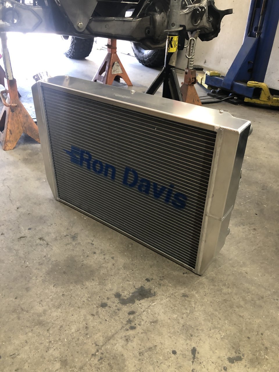

    Ron Davis showed up today :)

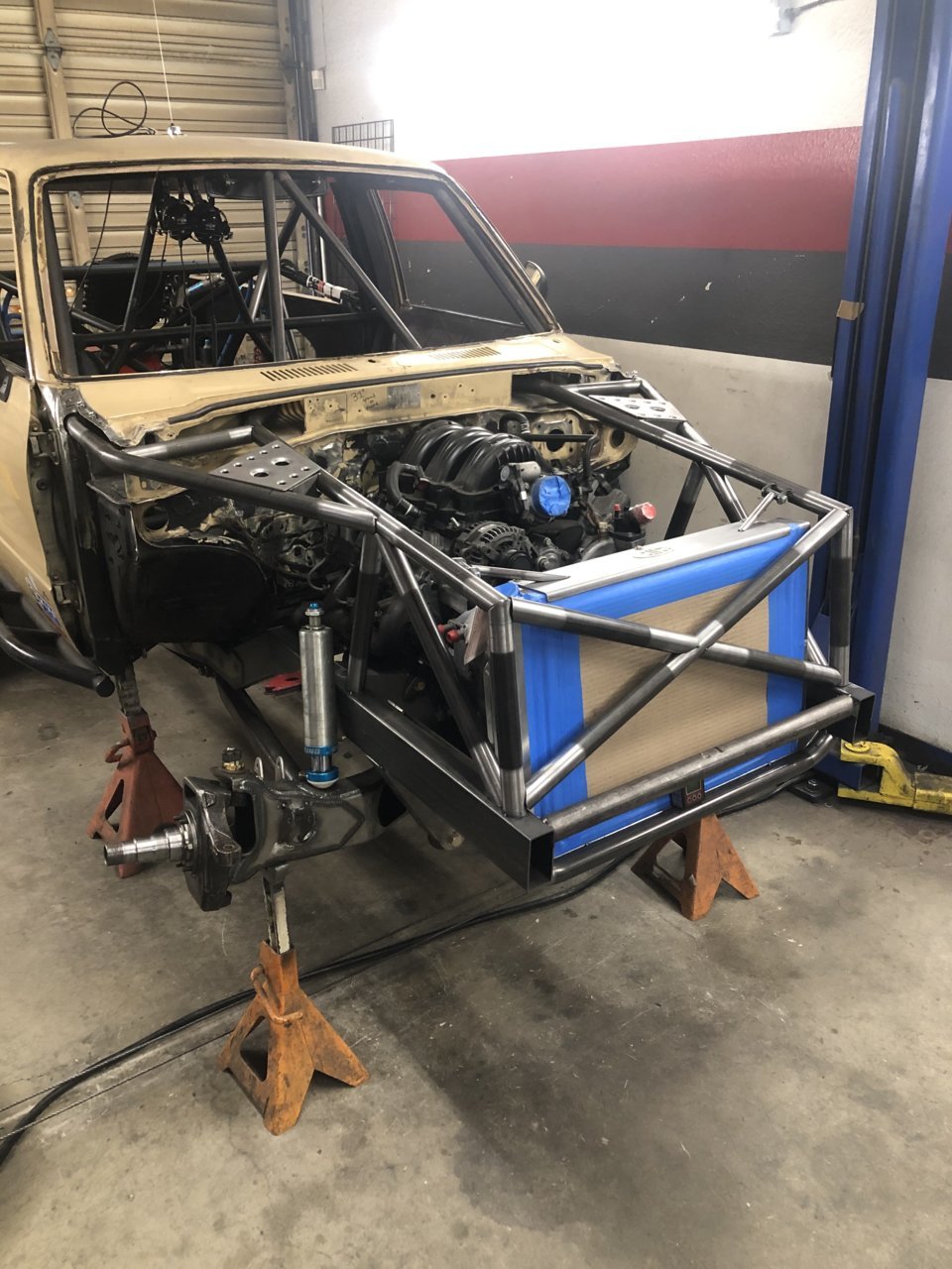

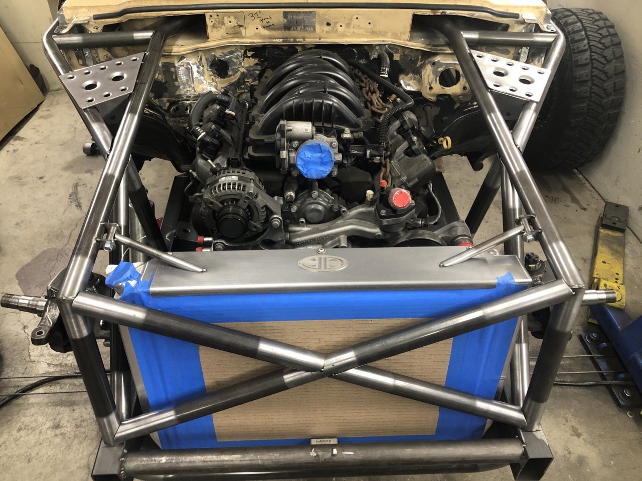

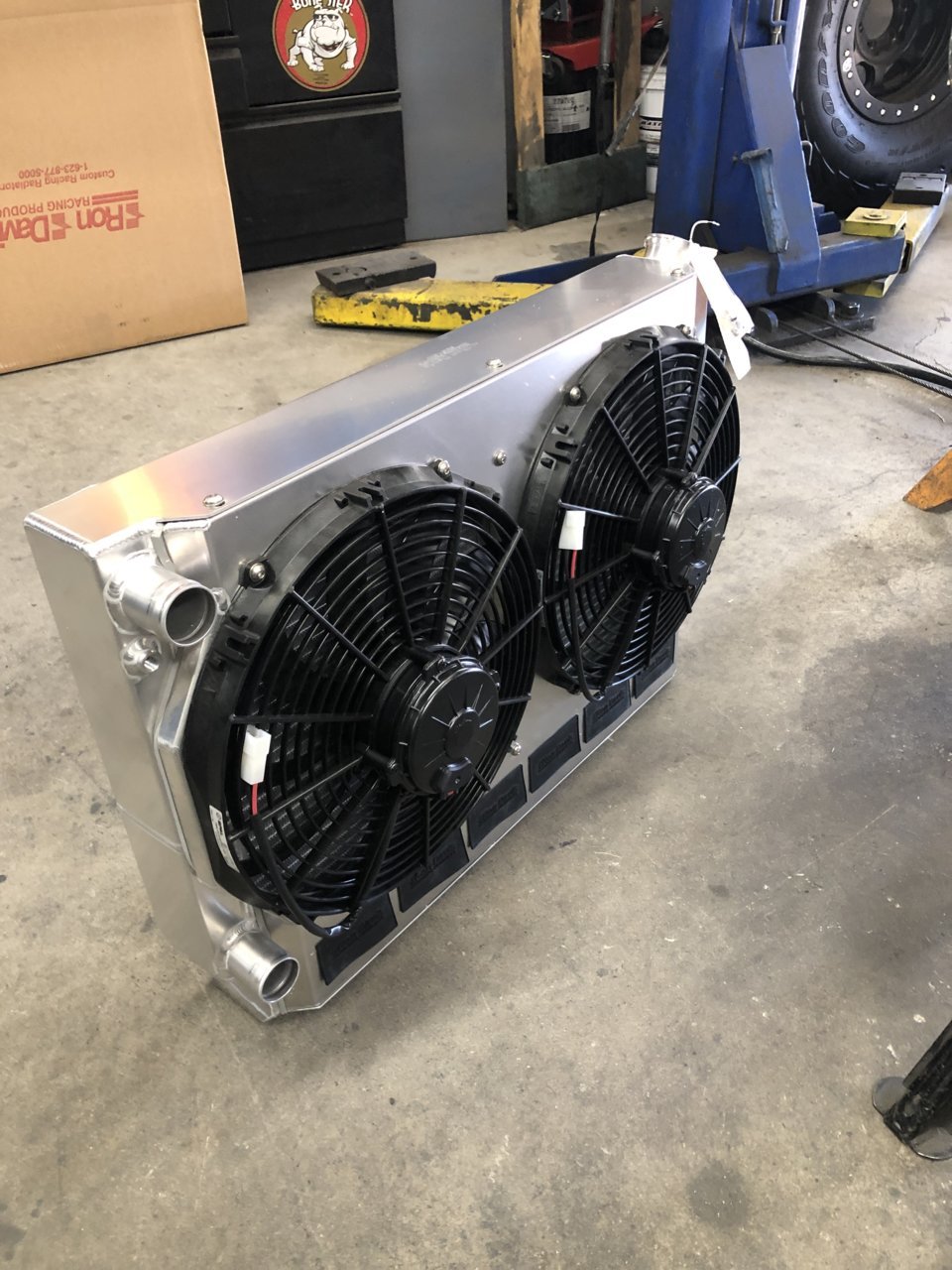

    Found a home for the radiator today and threw in a few tubes for good measure
    Mech1txs, la0d0g, 01 dhrracer and 4 others like this.

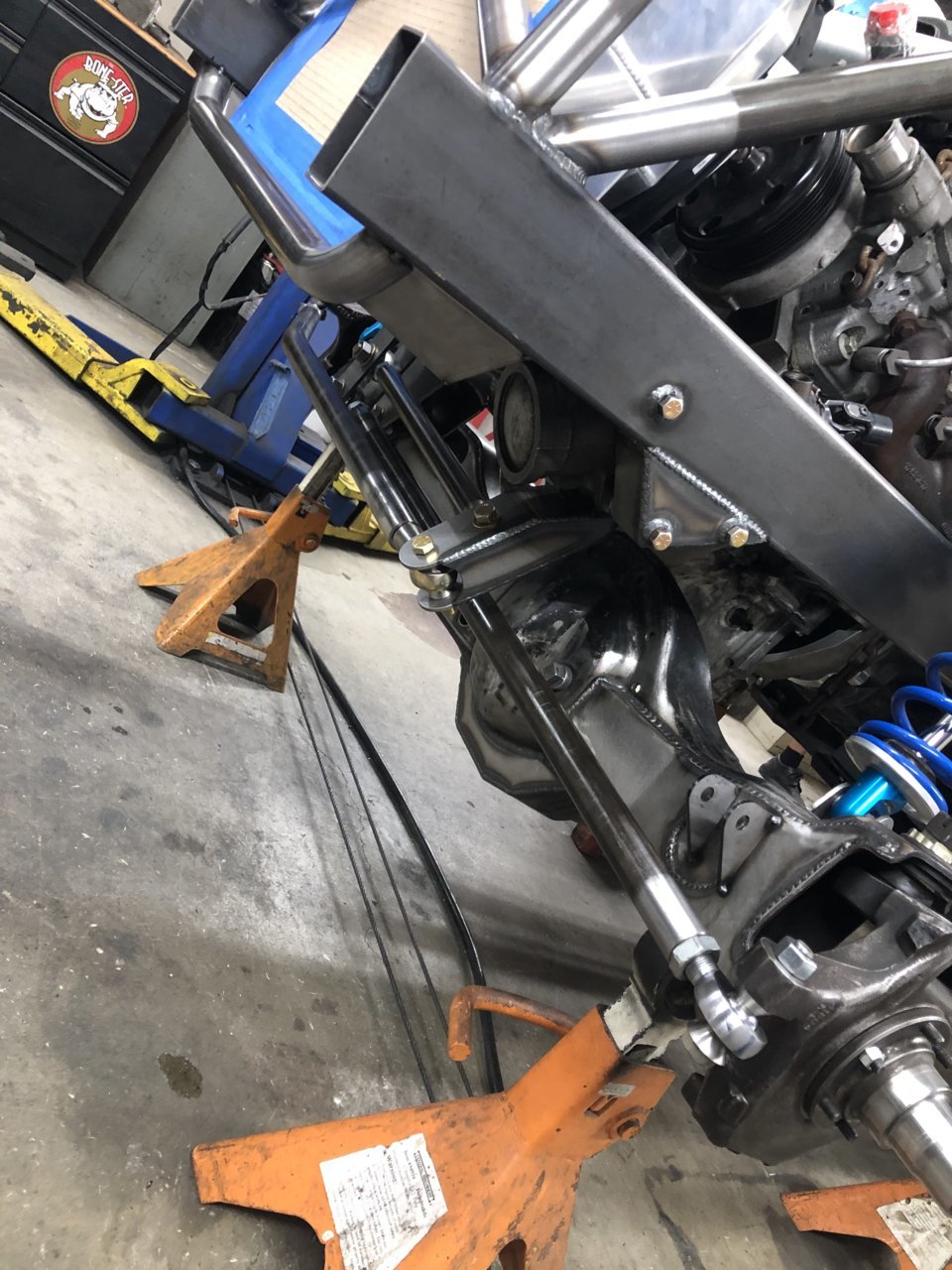

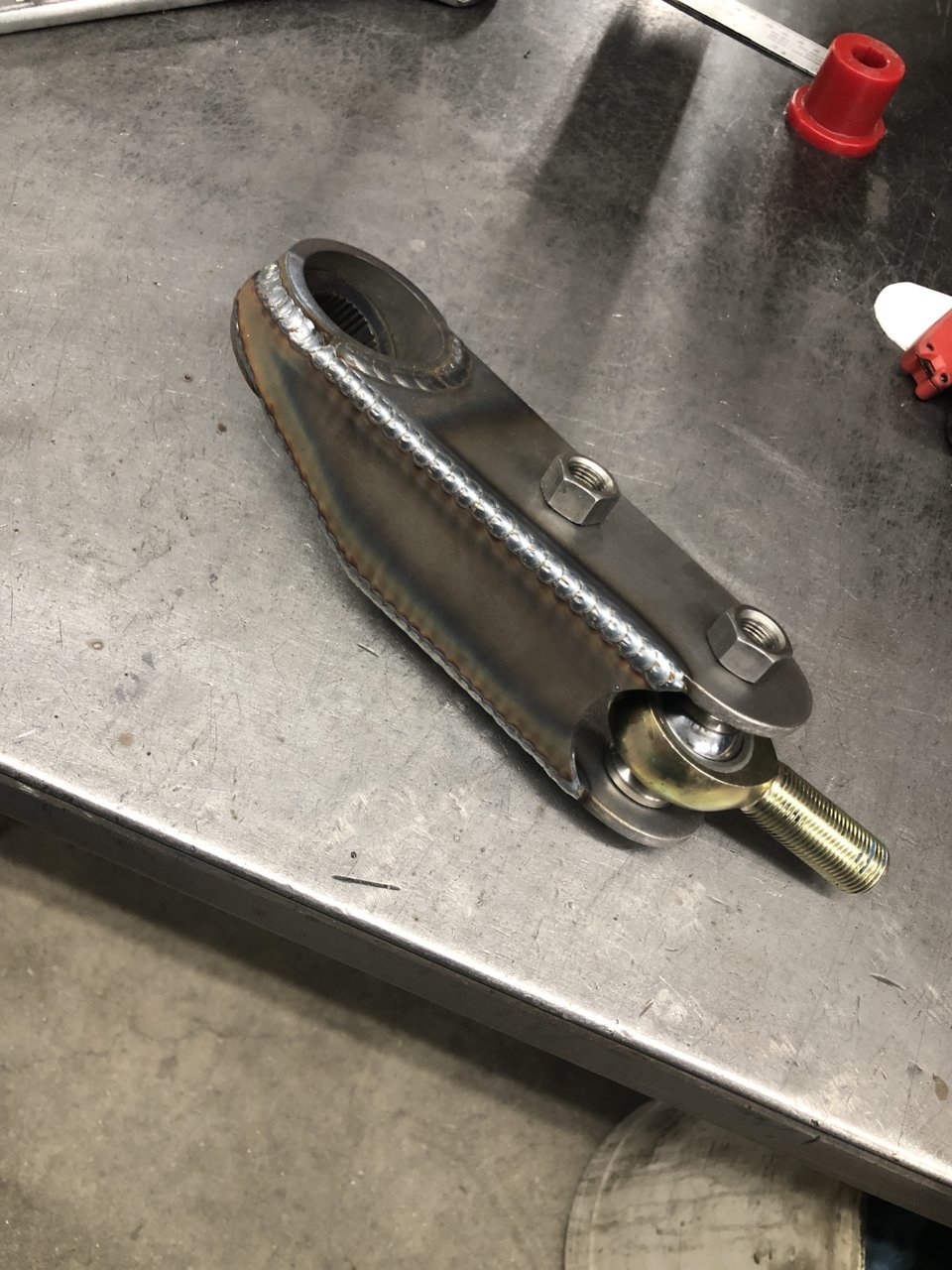

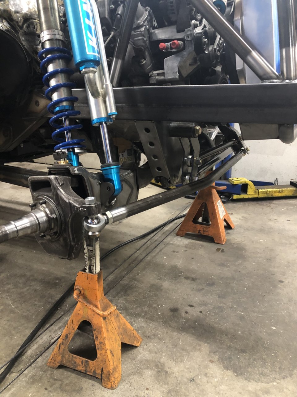

    Got my steering all done today
    Slashaar, la0d0g, 01 dhrracer and 7 others like this.

    So details on shocks and angles. I know this is ttb but some of the tech could be what I’m looking for. Length and size, angle, uptravel, downtravel etc
  15. Sep 26, 2020 at 5:57 PM
    #195
    81Trekker
    Aug 25, 2019
    #303299
    3,750
    La Jolla SD
    I’ll measure the angle on Monday for you. The shocks are 12” stroke and the truck has 9” of up and 9” of dropout
  16. Sep 26, 2020 at 6:00 PM
    #196
    malburg114
    malburg114 Well-Known Member
    Dec 26, 2012
    #93766
    3,784
    Las Vegas, NV
    2001 Toyota Tacoma TRD
    Both 2.5 shocks?
  17. Sep 26, 2020 at 6:03 PM
    #197
    81Trekker
    Aug 25, 2019
    #303299
    3,750
    La Jolla SD
    Yes but the the free bleeds run 3.0 resi and bypass tube

  19. Sep 28, 2020 at 3:36 PM
    #199
    01 dhrracer
    01 dhrracer Well-Known Member
    Aug 27, 2013
    #111316
    1,898
    Palm Desert/Bermuda Dunes
    Still Shopping
    Do you know what your WMS-WMS will be at ride height? Are the beams stock f-150 length and any adjustments to the caster or camber angles on the beams?
  20. Sep 28, 2020 at 7:37 PM
    #200
    81Trekker
    Aug 25, 2019
    #303299
    3,750
    La Jolla SD
    I don’t know the WMS but the over all width is 83” with 37x12.5” tires on 8” rims with 3.5 bs
    yes they are stock width beams with no camber mods because the pivots I made dropped the beams way lower than stock so they sit flat. The caster is 8 degrees at ride height, 17 at full bump and 2 at full drop out
