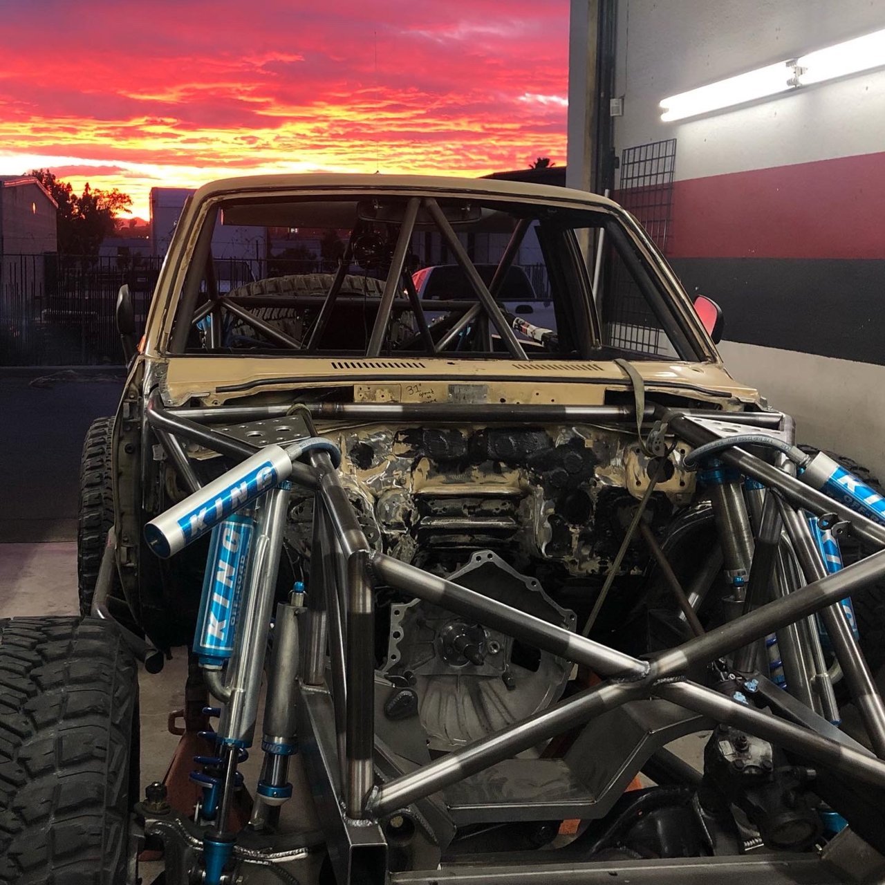

    81 Trekker and 2015 CCSB Tacoma
    Too many to remember

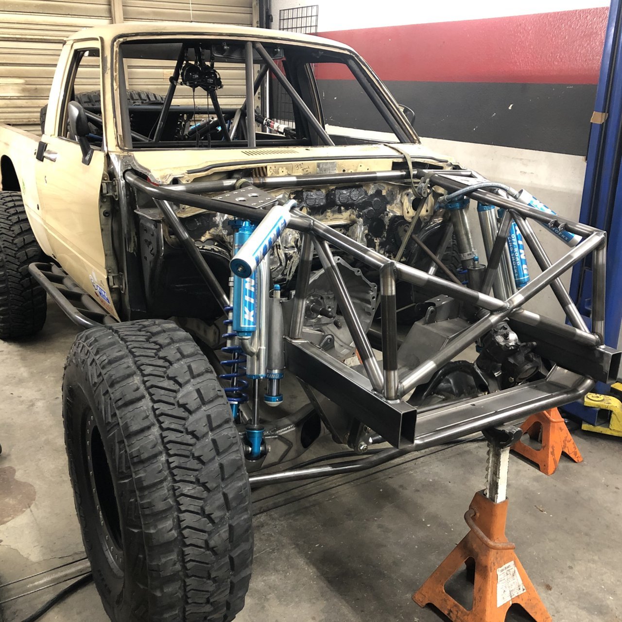

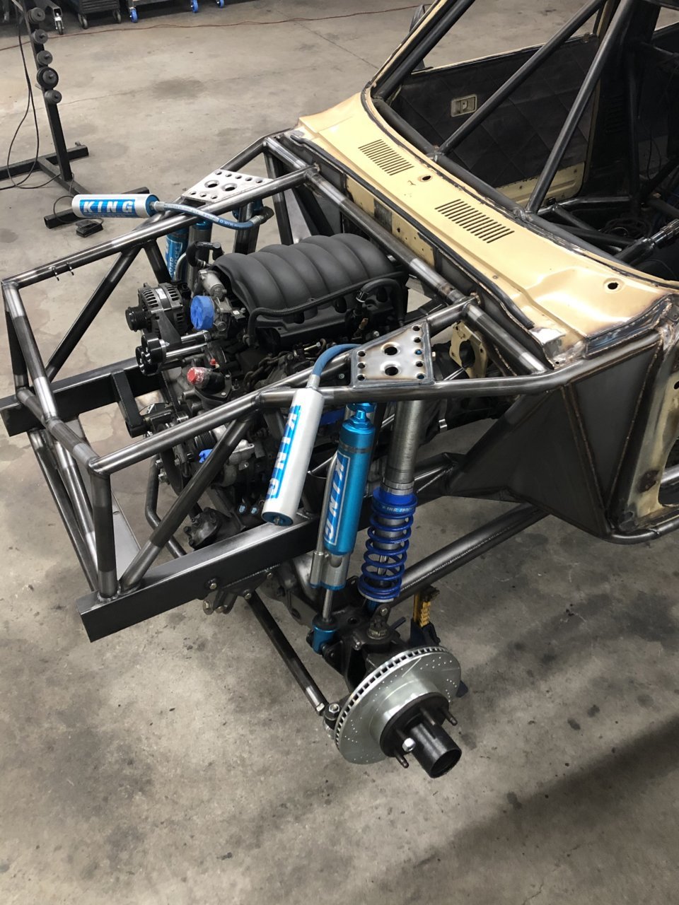

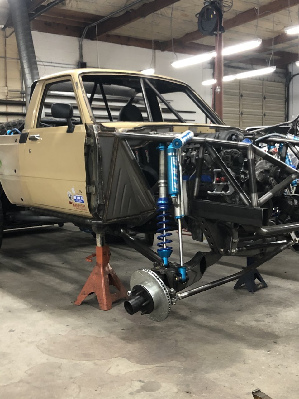

    Got the motor pulled after work so I can start welding everything up tomorrow

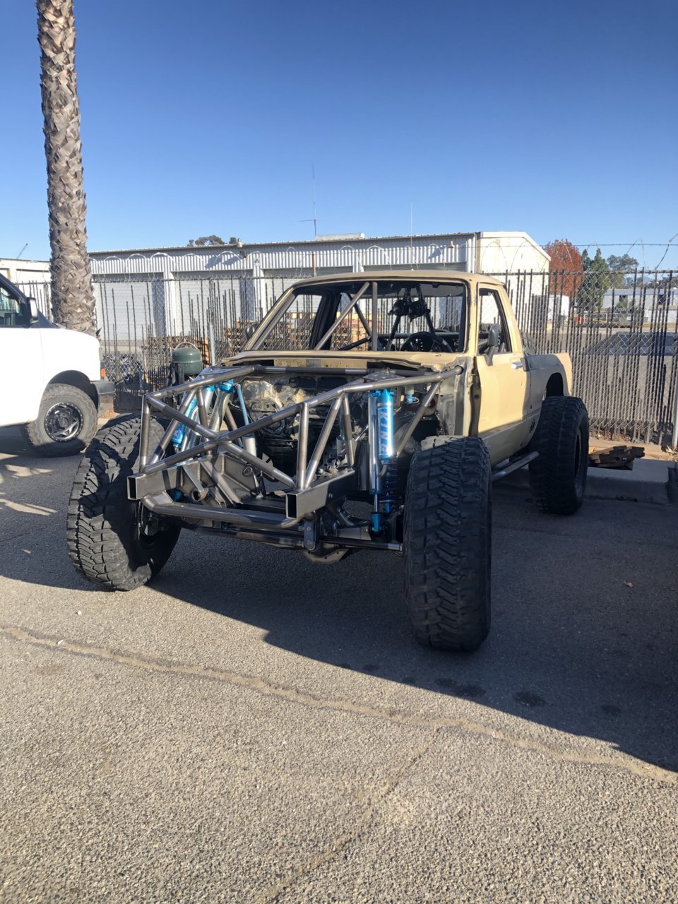

  3. Dec 12, 2020 at 11:23 AM
    #223
    81Trekker
    81Trekker [OP] Well-Known Member
    Aug 25, 2019
    #303299
    3,750
    La Jolla SD

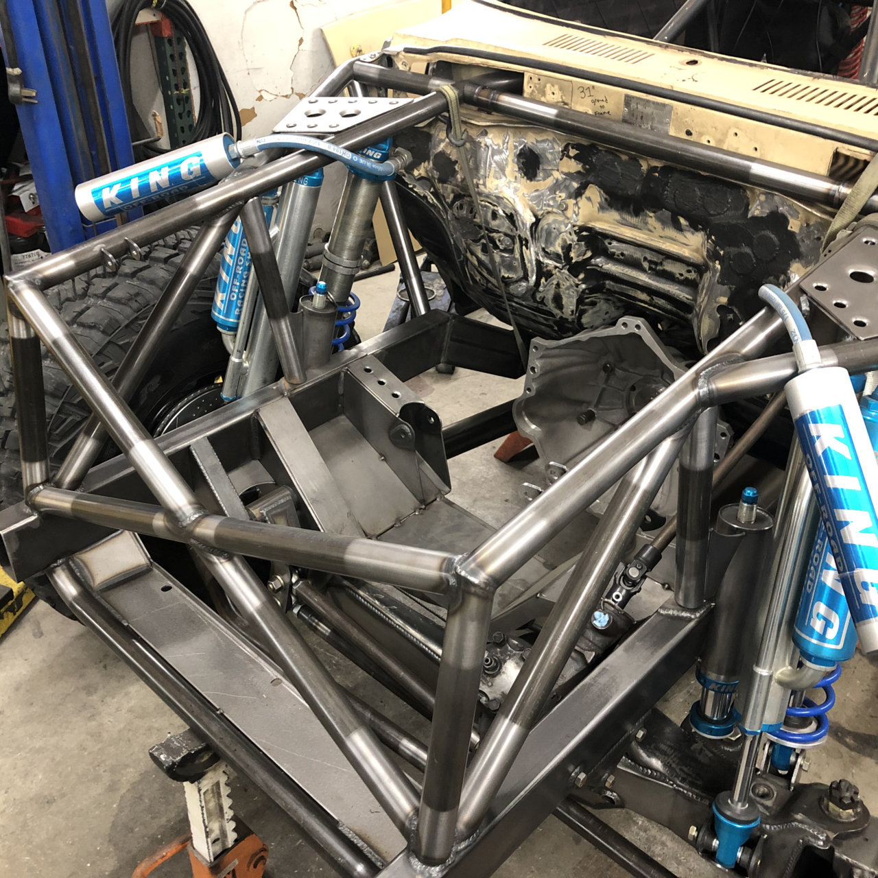

    So much welding...

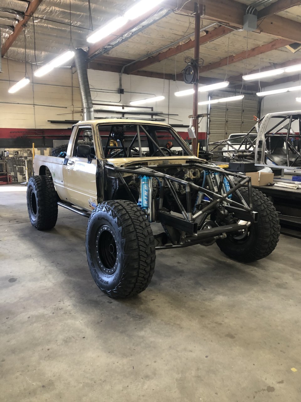

  7. Dec 18, 2020 at 7:05 PM
    #227
    81Trekker
    Aug 25, 2019
    #303299
    3,750
    La Jolla SD
    Outside enjoying the sunlight after 8 months inside

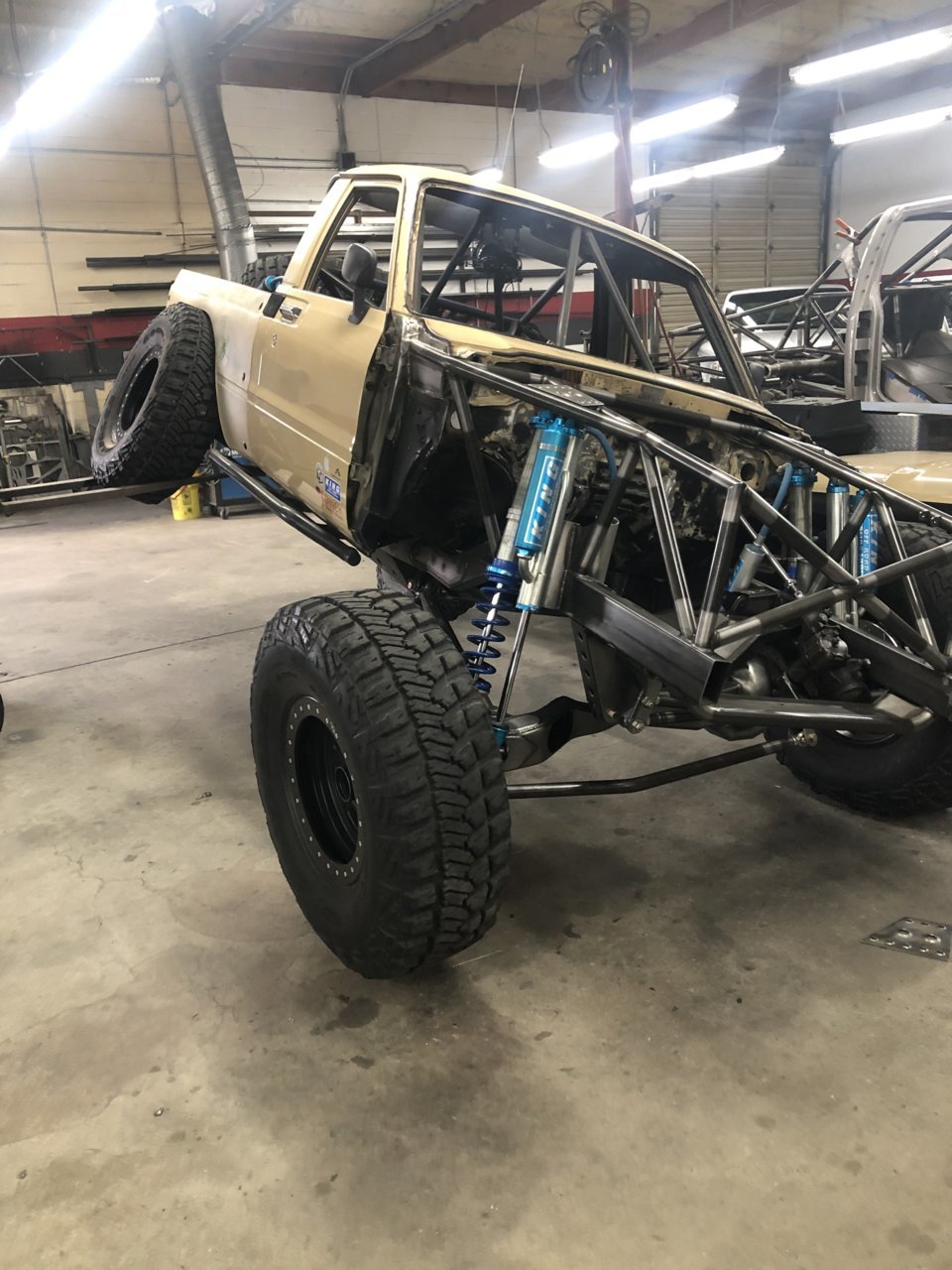

  8. Dec 23, 2020 at 8:13 PM
    #228
    81Trekker
    Aug 25, 2019
    #303299
    3,750
    La Jolla SD

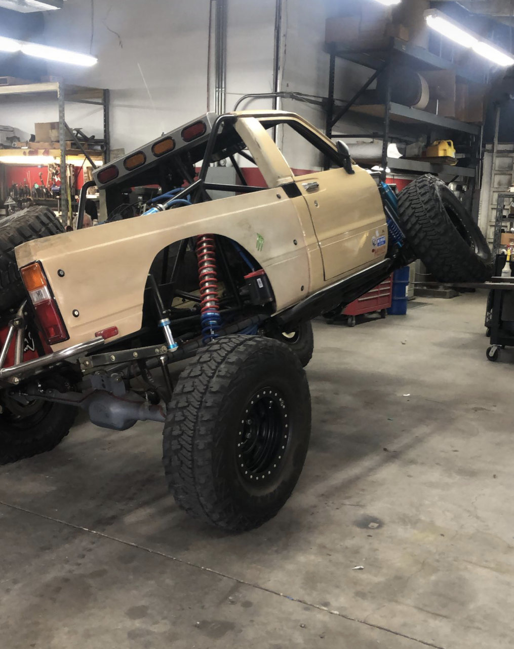

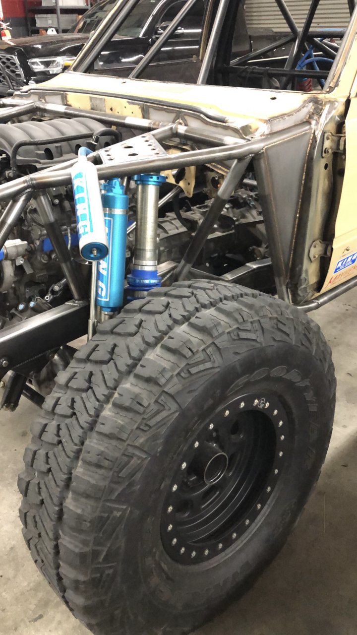

    This should work for the rock donkey stuff

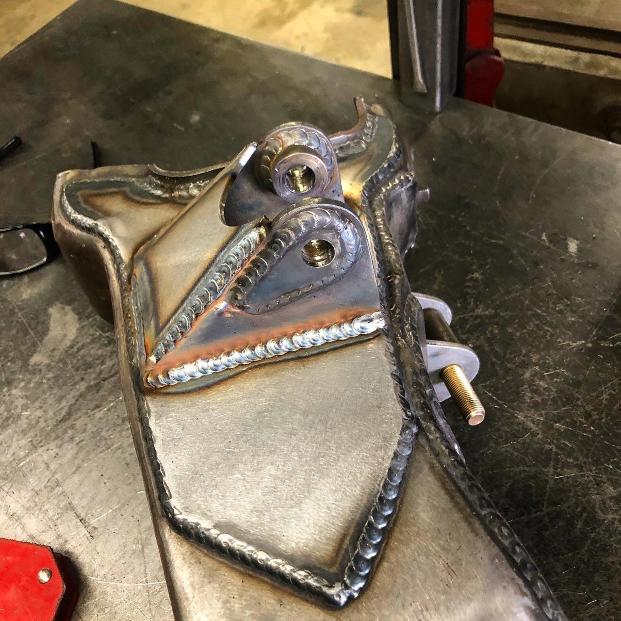

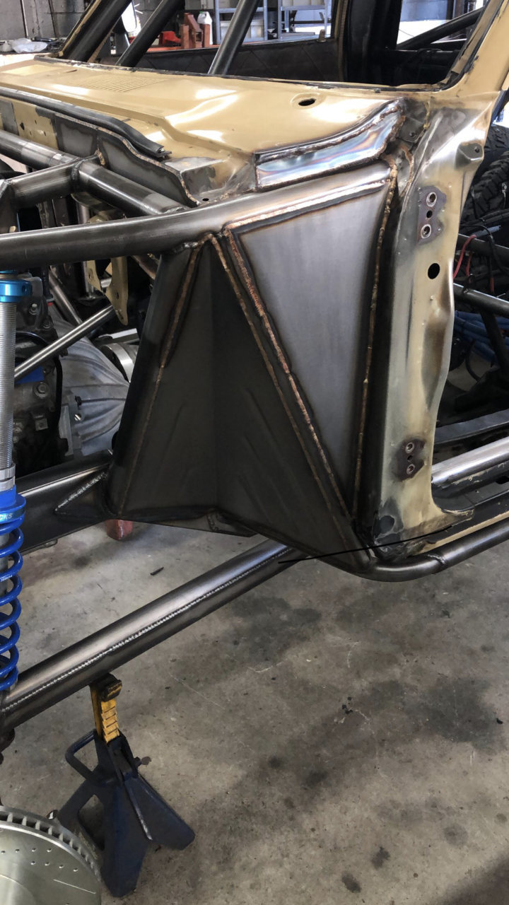

    Silicon bronze Tig patch panels complete

    Tin work ain't no walk in the park. Solid work, as always. Keep it up!

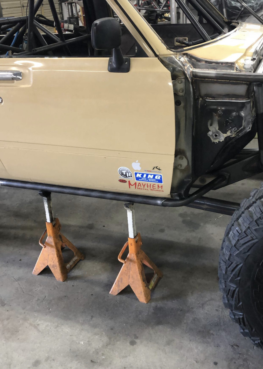

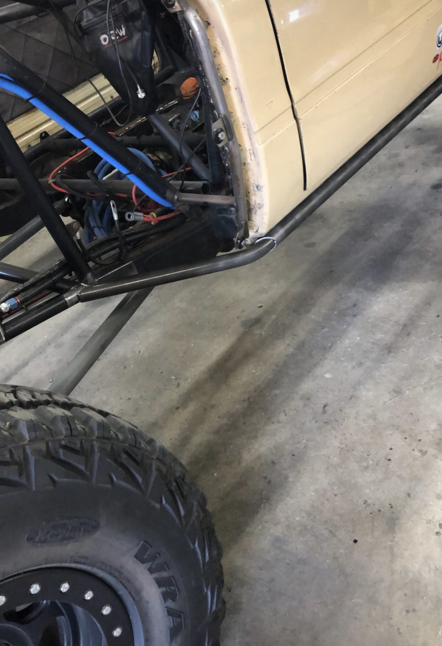

  13. Dec 31, 2020 at 6:57 PM
    #233
    81Trekker
    Aug 25, 2019
    #303299
    3,750
    La Jolla SD

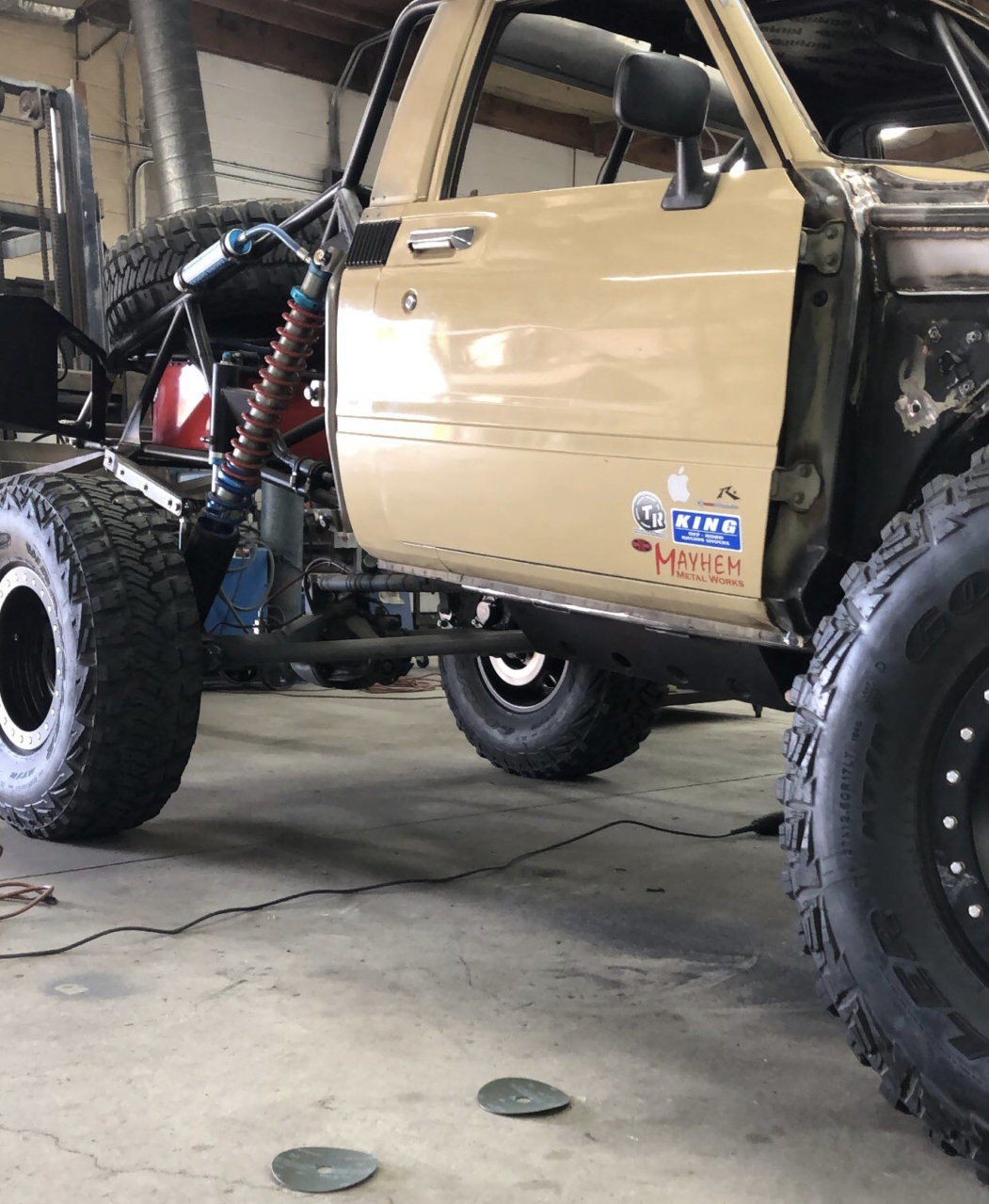

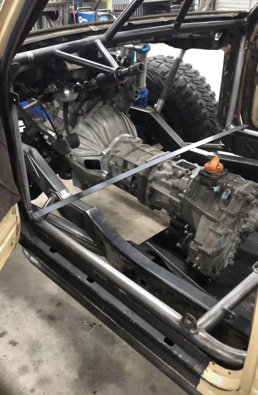

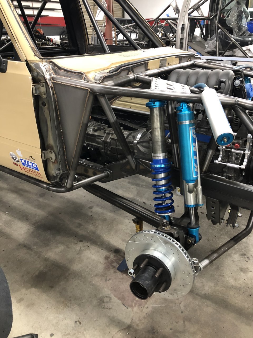

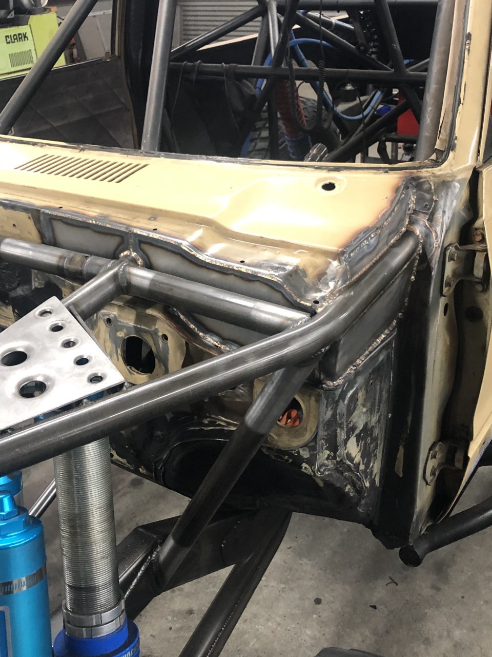

    I finally hacked off the nasty rock sliders that came on my truck when I bought it. I’ve been avoiding doing so for 7 years because of the way they were welded on made it a nightmare. After 5 hours with the plasma cutter, die grinder, sander and DA my frame rails look brand new. I then started my new, low pro sliders that act as a subframe to tie everything together.
    I did the main tubes out of 1.75” DOM and cut the ends at 45’s so I could slip fit the 1.5” ends in. I did it this way so it would fit nice to the 1.5” rear section and it gives it a neat look

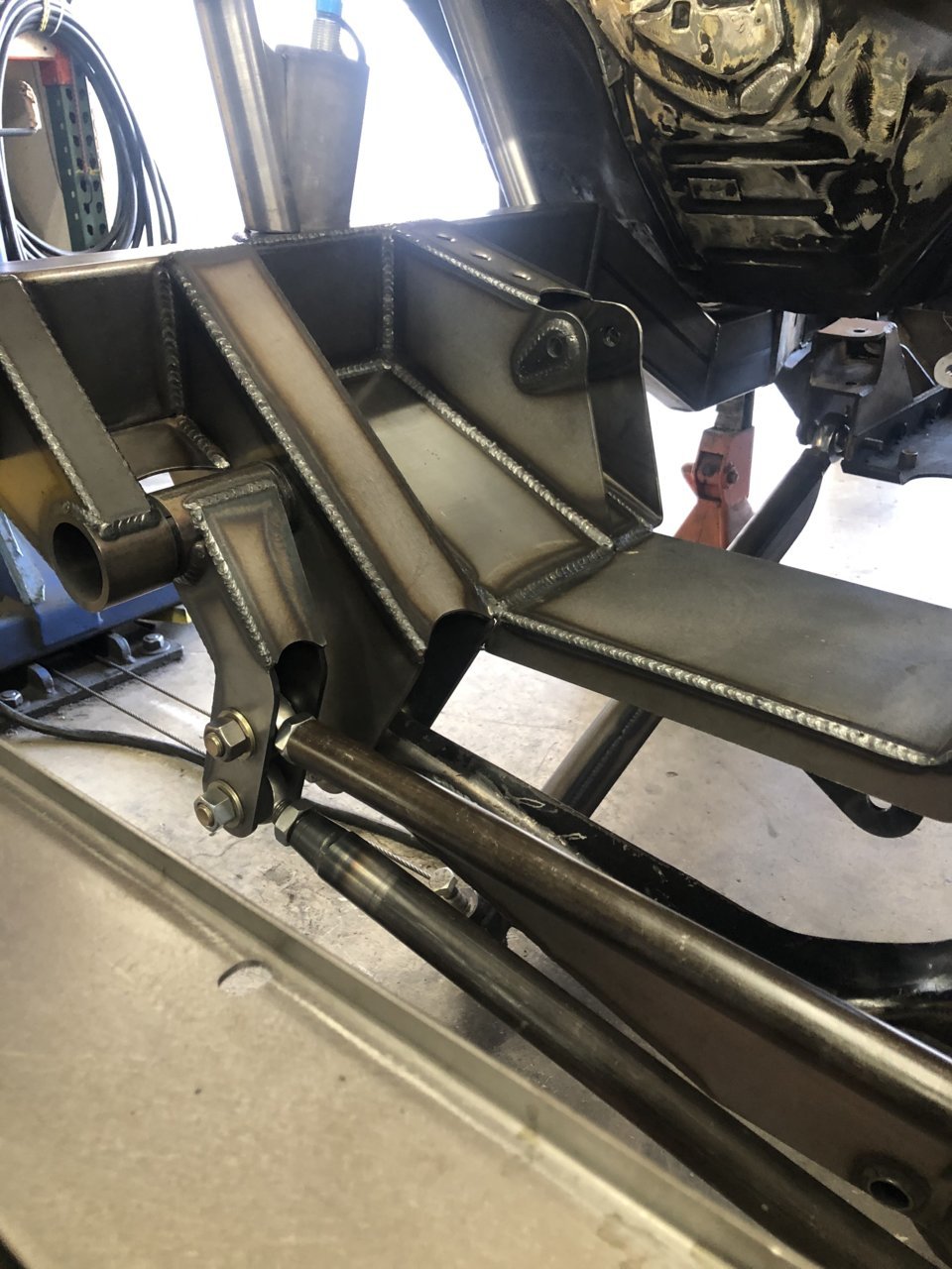

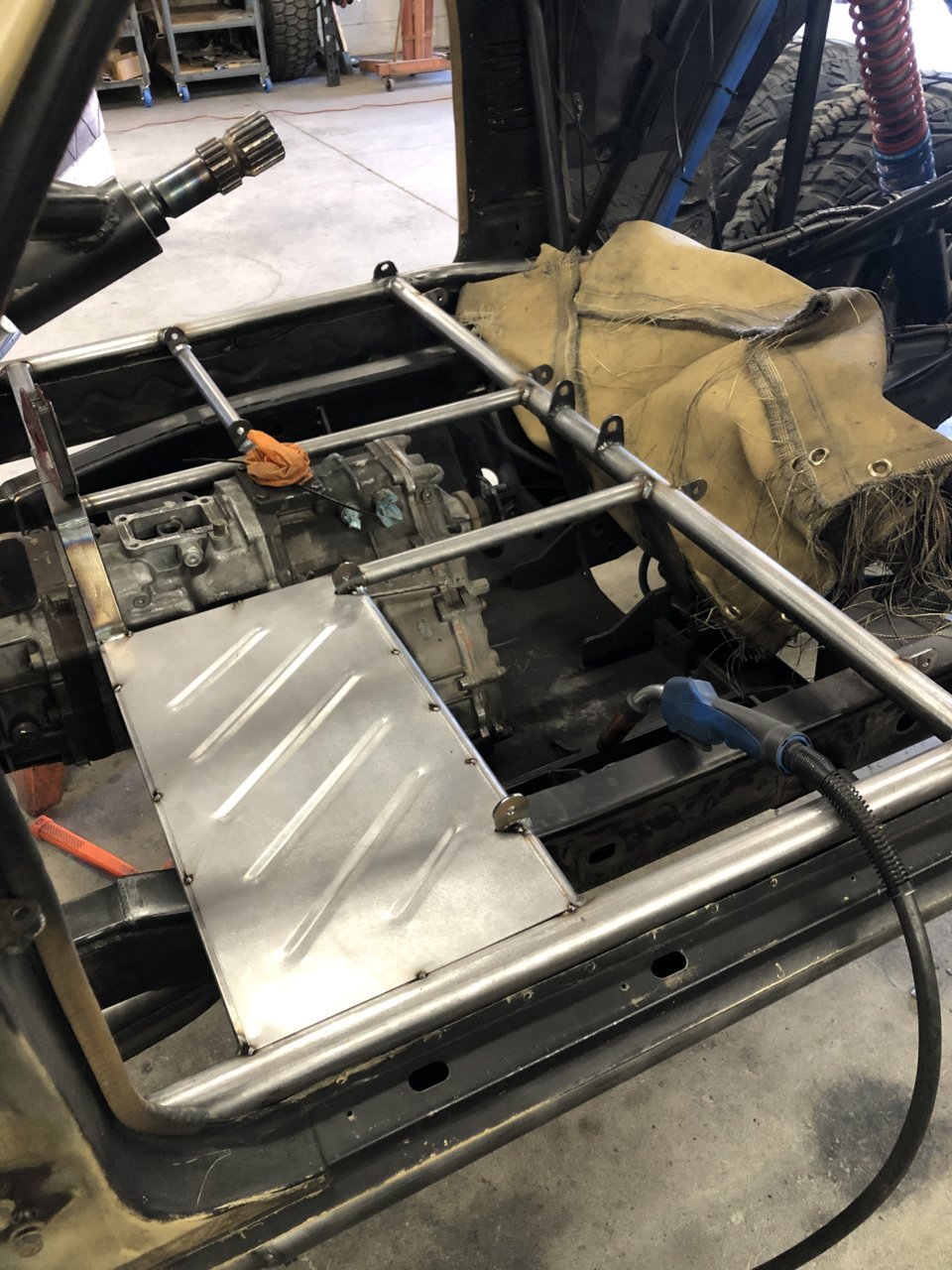

    I just couldn’t help myself and cut the entire firewall/floor out... started building a new one today :)

    Jeez Harry, doing it right. How thick is the sheet for the firewall? same for the pans? So much awesome.

    .045 so about the same... super fun to weld :)

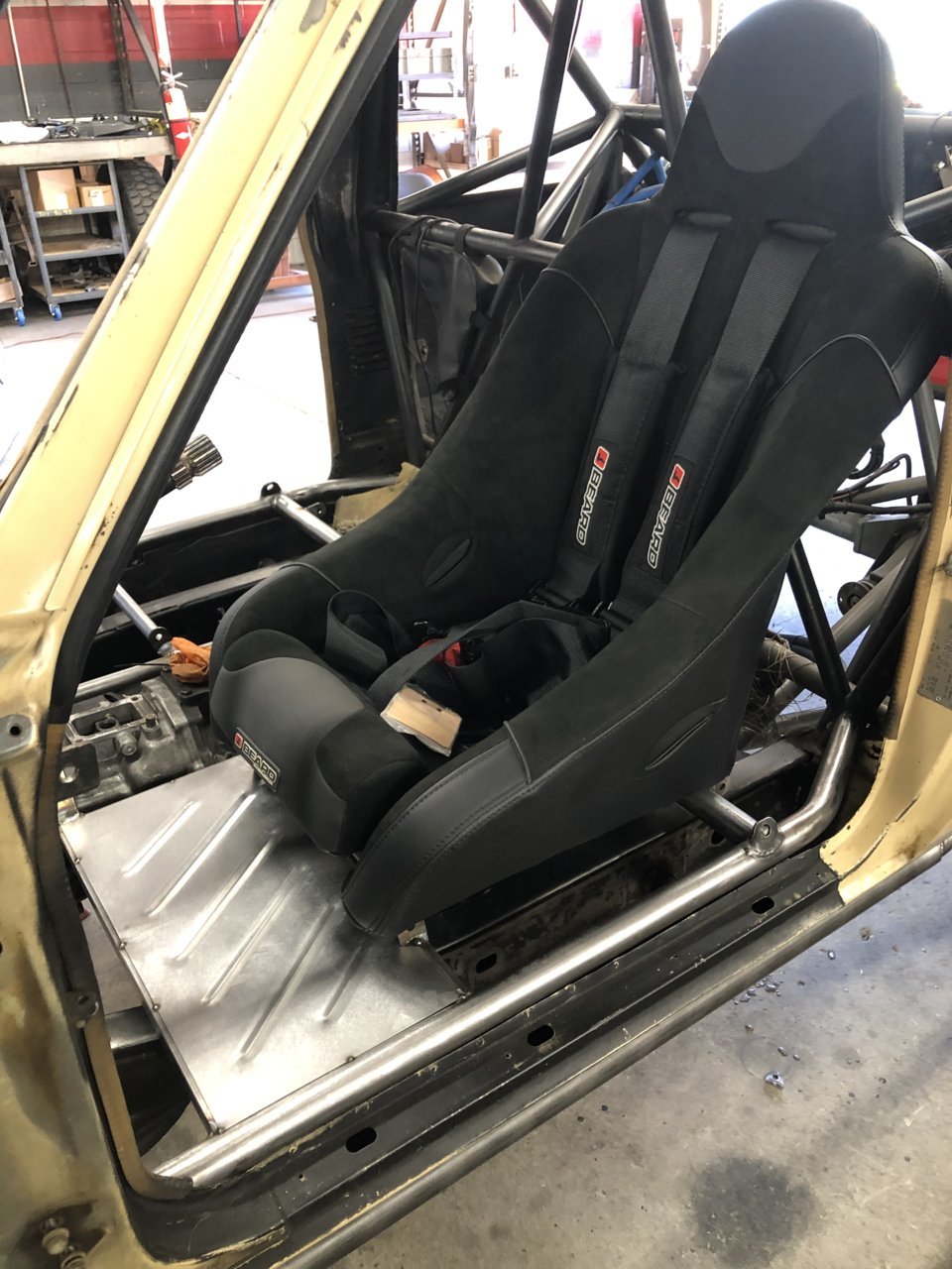

    Made some progress this weekend, got both wheel wells done, seats mounted and started on the floor
