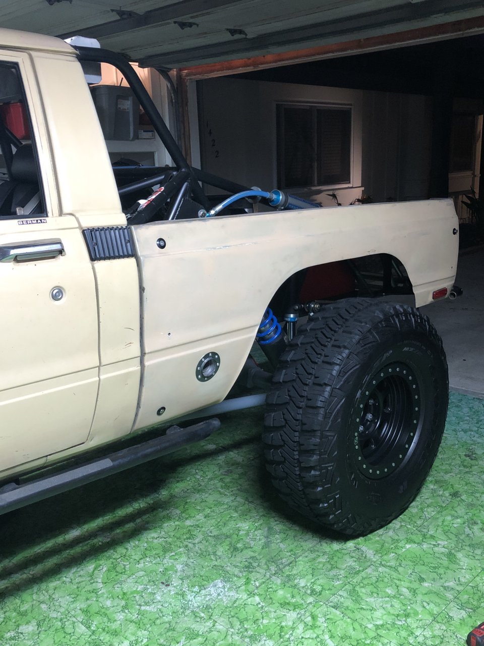

    hey why did you do a 4 link instead trailing arms? Basically I mean why didn’t you mount the rear coilovers on the link instead of the axle?

    Because I’m lazy and building real trailing arms takes forever:)
    Seriously though I did it this way to keep it light and keep the truck balanced. With the axle in the front I couldn’t get more than 13” of travel so it didn’t make sense to have 30” in the rear. With the coilovers off the axle I still got a clean 20” which is more than enough. Also because the shock is close to a 1-1 ratio there is plenty of valving in the single 2.5” shock which also keeps things light. When you mount the shocks off the trailing arms a single shock just can’t keep up.
    The truck works really well with the shocks off the axle because it’s super light, really strong, low and has 37’s

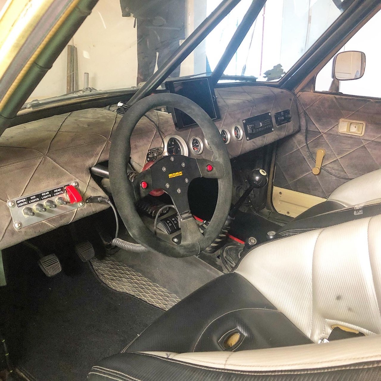

    Finally got around to putting in my PCI race radio, intercom, headsets and lead nav!

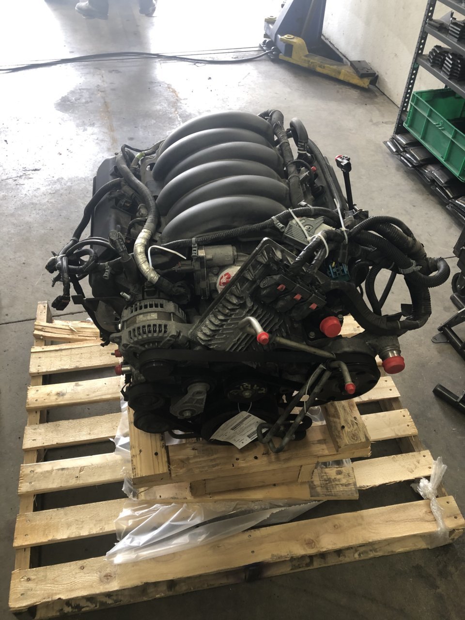

    Got her all stripped down and ready for the Howell EFI harness and computer

    Is that an ls or v6? Valve covers look smaller?

    It’s GMs new all aluminum, direct injection 4.3l V6

    Hp? Torque? Cool/wish it was toyota though :boink:
