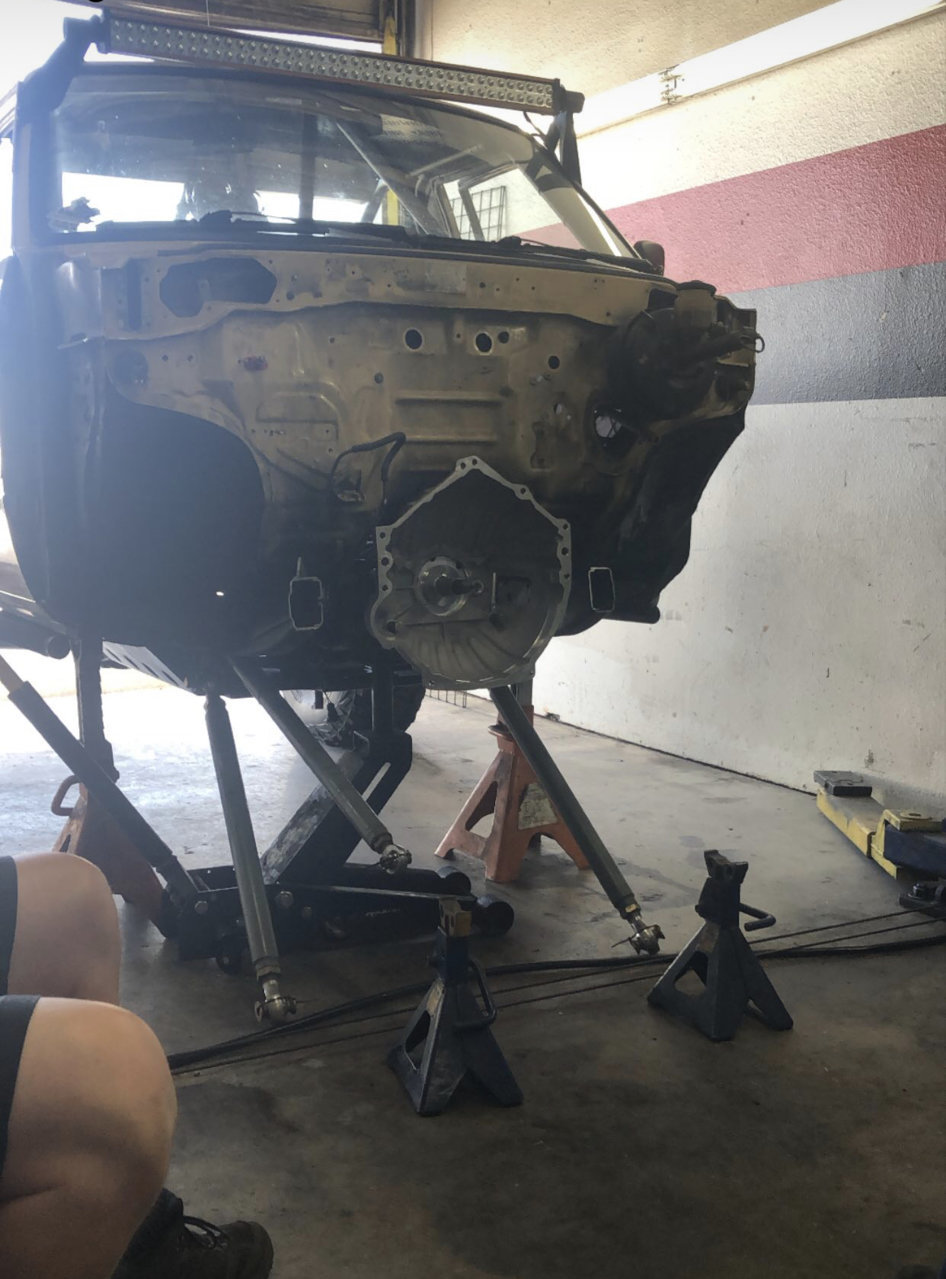

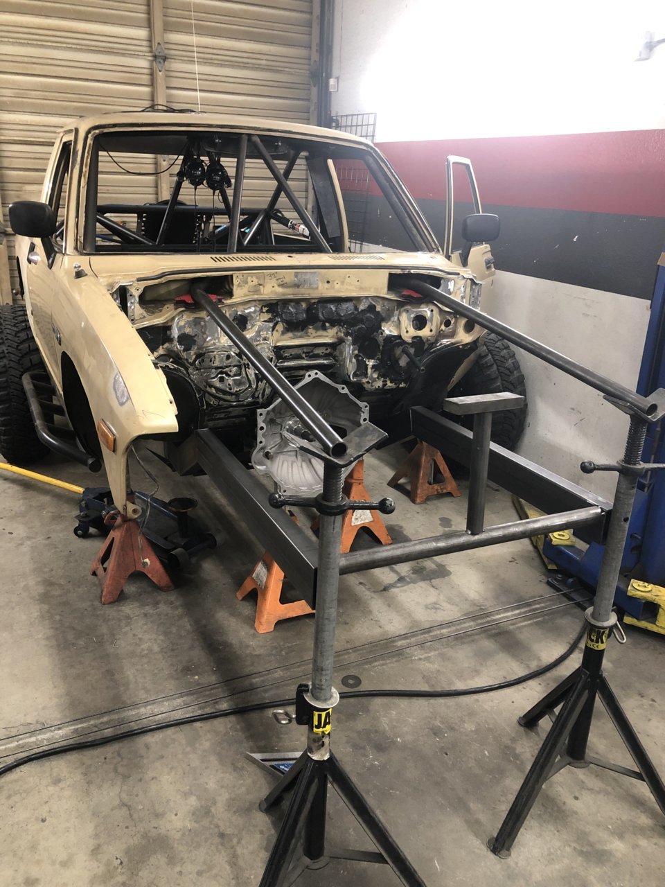

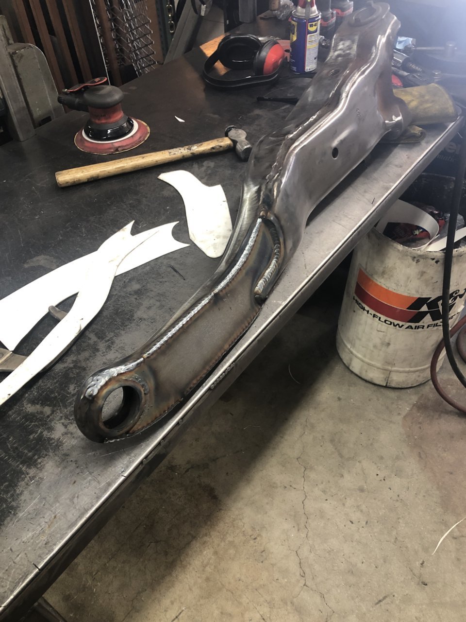

    Got my beams pretty much done, motor is in where it needs to be with tranny and drivers side diff drop. Started on the frame rails yesterday

    How much are you lengthening the wheelbase to fit that bigger motor with beams?

    The wheel base is staying the same as with the solid axle... 4” forward

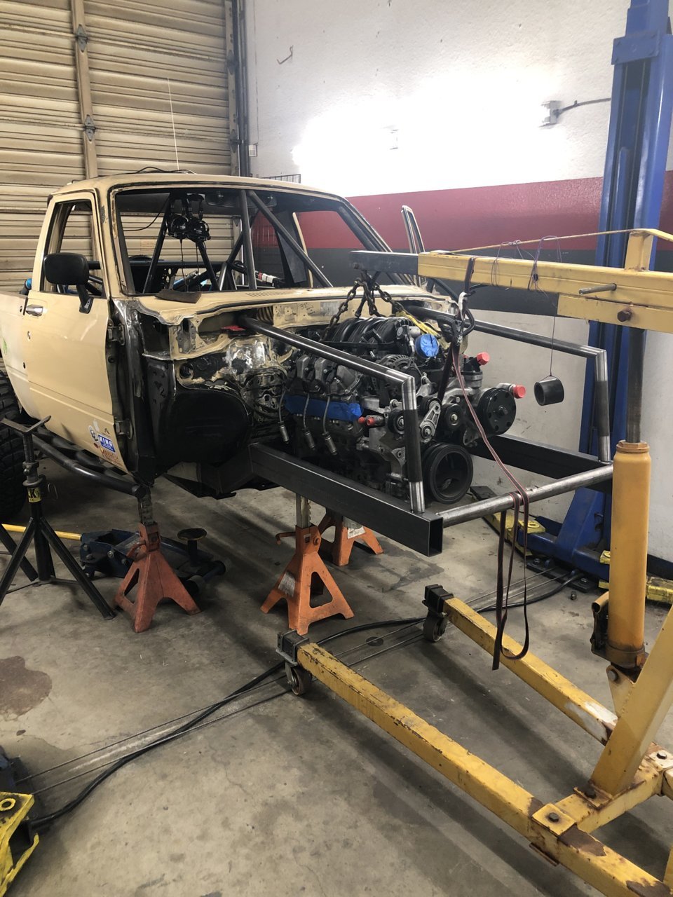

    Got the frame rails all tuned in and started with the engine cage

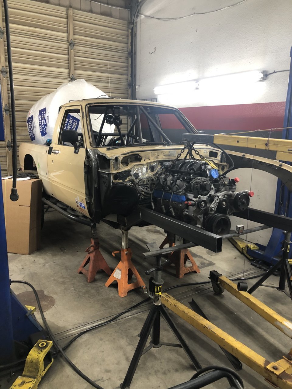

    She fits nice

    really clean. although it doesn't look right without green swirl laminate tile. Looks like a lot of extra space up front, SUPER nice.

    by the time I get the radiator/fans in there I have 1/2” of clearance to the pulley and the grill has to get notched over the engine cage... it’s so tight it’s crazy

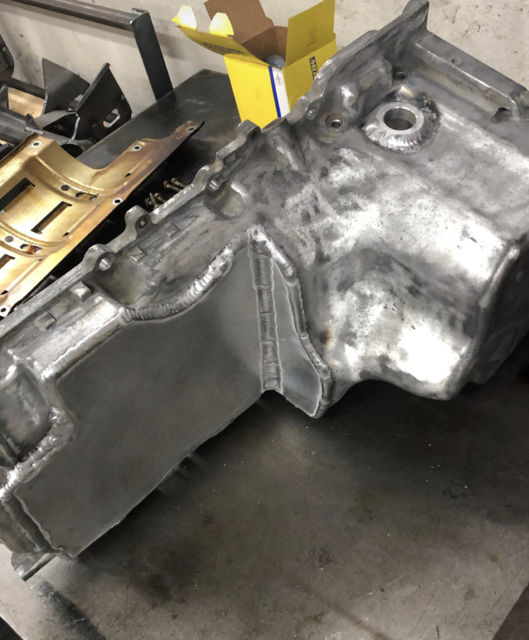

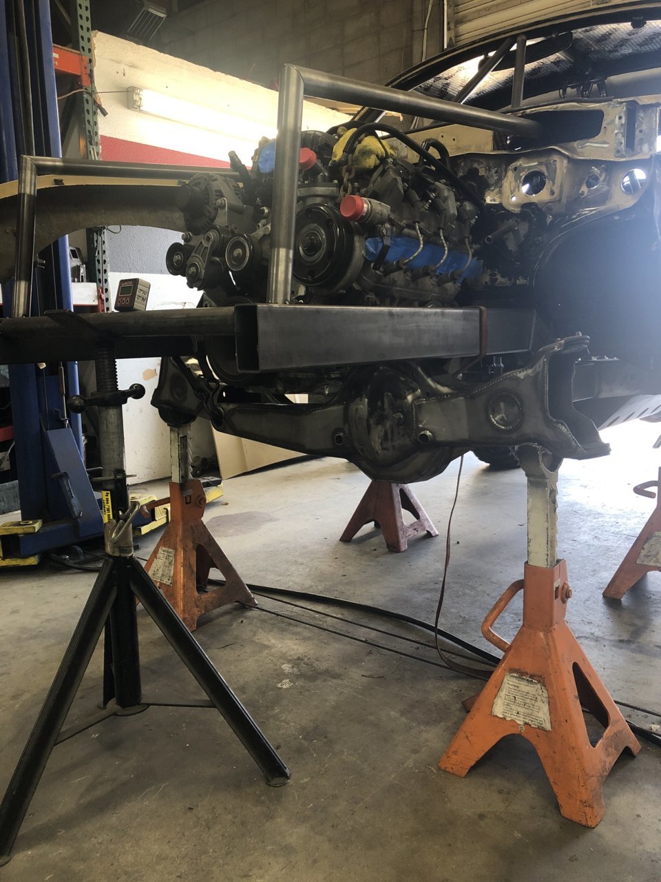

    Modified the pan to get all the uptravel I can. The beams now bottom out on the new frame and the 37” tire touches the bottom of the hood at full bump... gonna have to notch the hood if I want to clear 40’s :)
