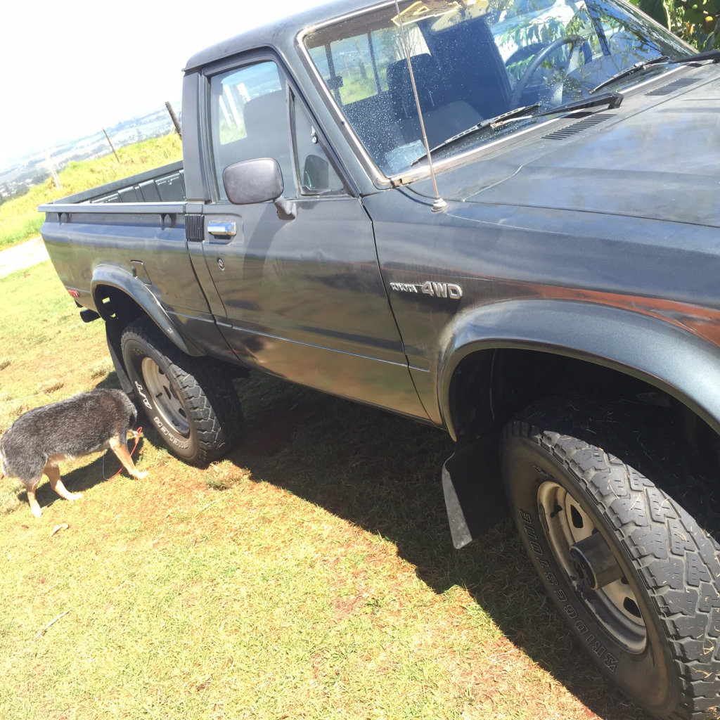

    I'd just add a couple Chevy springs to your existing probably , I'd have to see them for sure, I'd be willing to bet they'd be ok to refresh, probably needs bushings by now tho' with the age... put up some pics if you have any, I miss my '83....

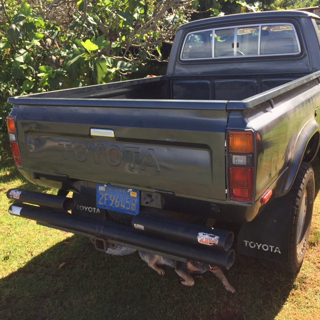

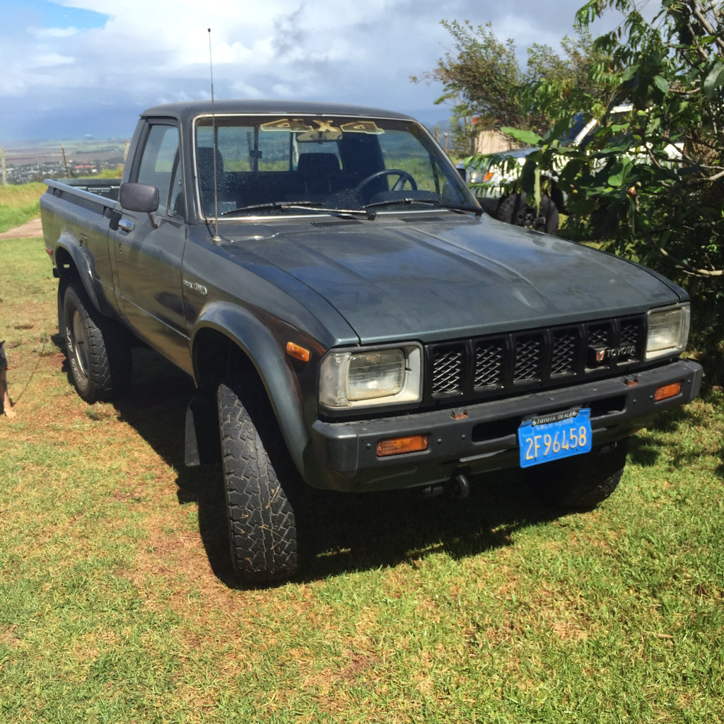

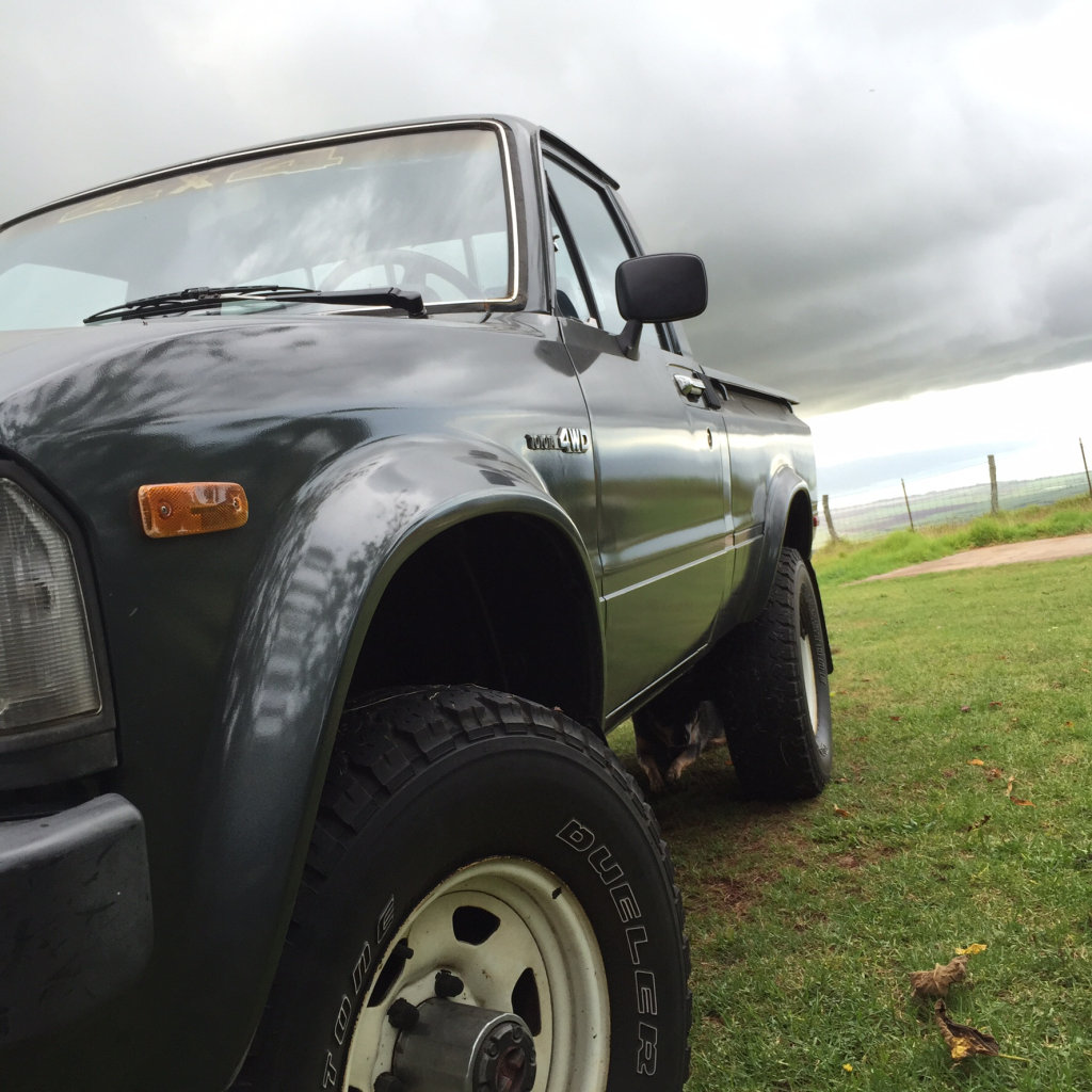

    here are some pictures of it. i haven't crawled under it yet to get pictures of the suspension.
