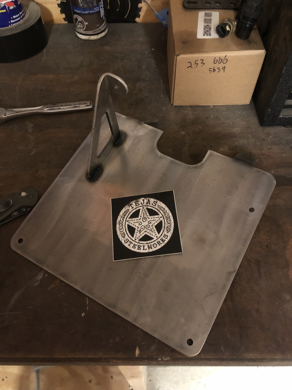

    Tejas Ecu Mount arrived today!

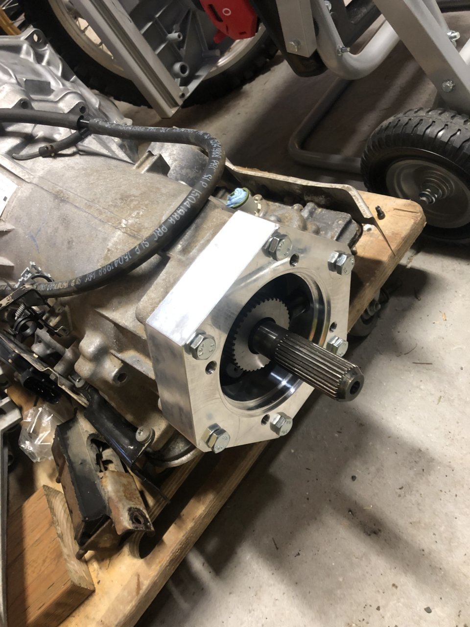

    4l60e to np208 adapter with a built in vss and reluctor ring retrofit so the tranny knows when to shift.
    The stock 06 gets its speed sensor input from the np246 tcase that I won’t be able to use for to its drivers side drop front driveline. This puts the speed sensor and 40 tooth reluctor ring on the output shaft of the transmission so the ecu knows when to shift.

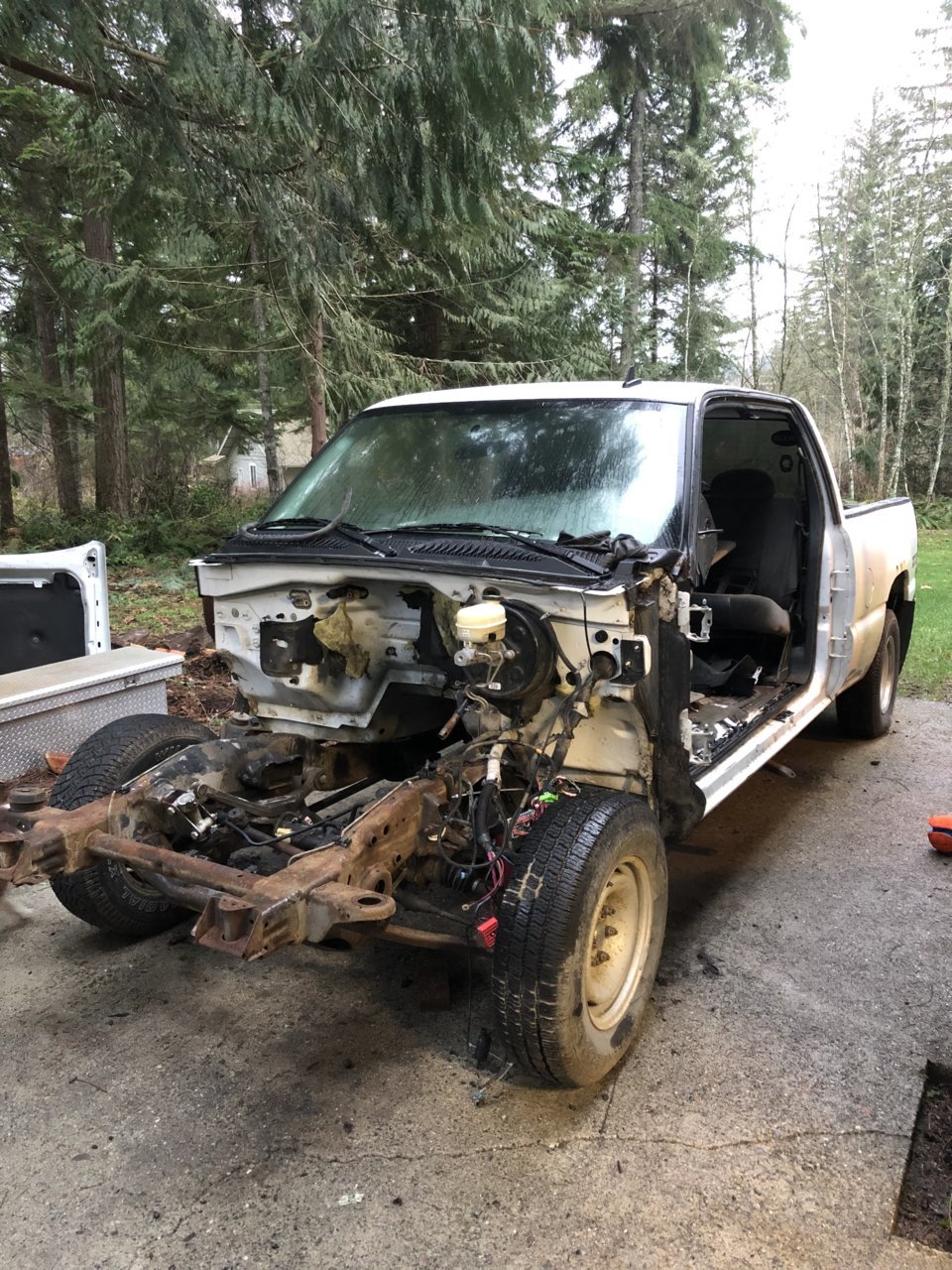

    I can’t believe the interest I’ve gotten in parting out this truck. I’ve already paid off the 500$ for the truck and $200 for gas. Now the moneys going to more ls parts!

    Just got our tax info back and we owe over 6k so taking a break on buying parts for a month or so. But I started working on the square tonight. Torque converter is unbolted, drivelines removed, tcase is unbolted besides 1 bolt, trans-engine is unbolted besides 1 bolt. Exhaust is unhooked. Everything came apart really well I haven’t touched much of the motor and trans since back in 2012. Probably going to start working on getting the wiring unhooked tomorrow and draining fluids. Should be able to get the motor ready to pull. Selling lots of parts off of the 06. Got people buying stuff multiple days a week.
    Anyone in Washington need a low mileage 305 and a perfectly good working 700r4? Motor could use a hone and ring and some better heads.

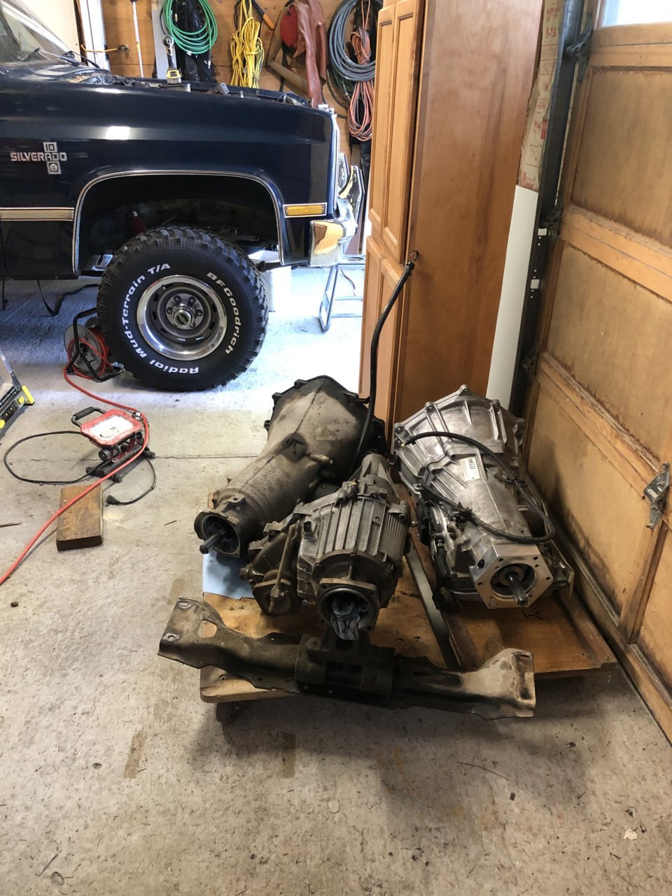

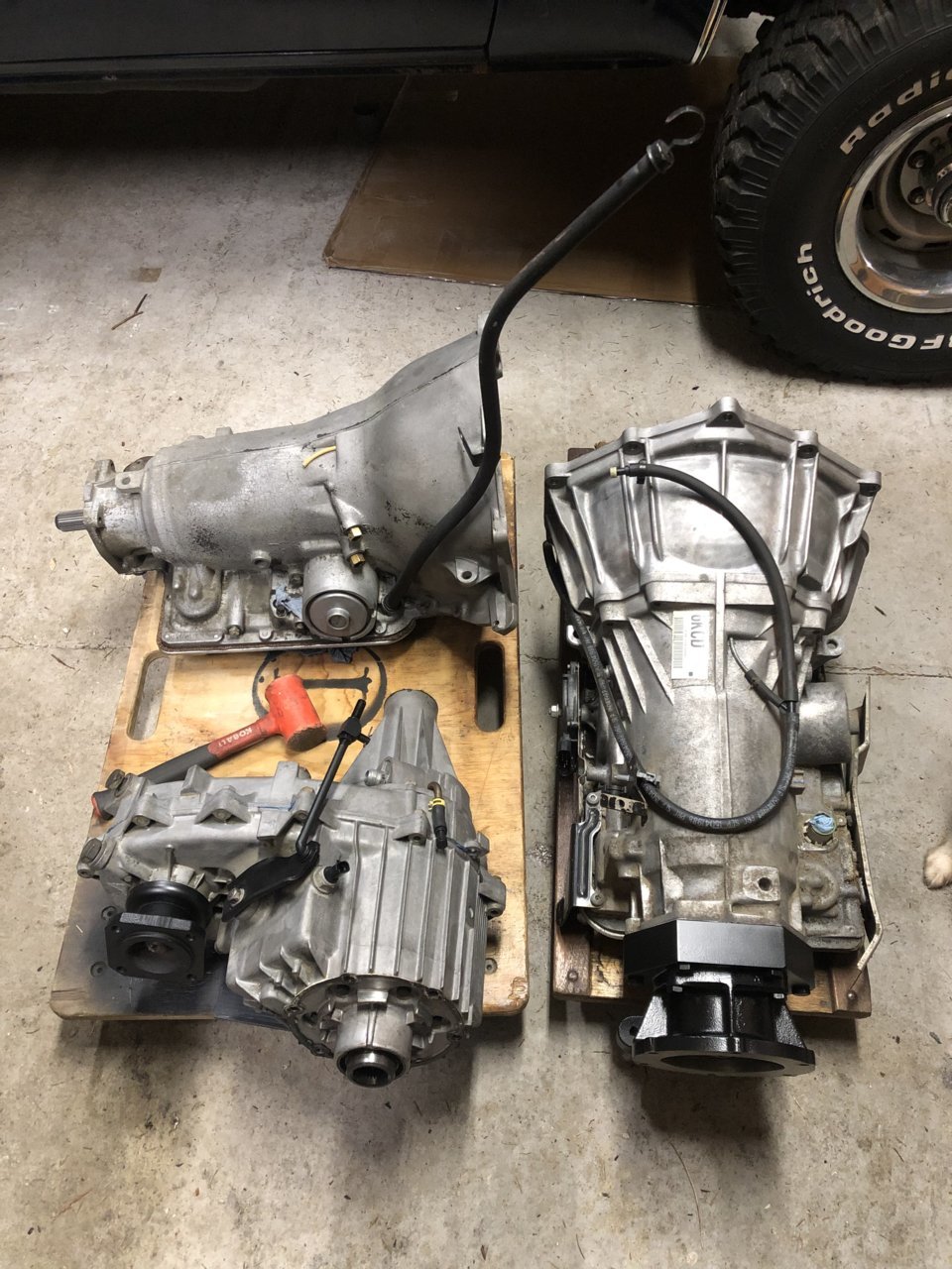

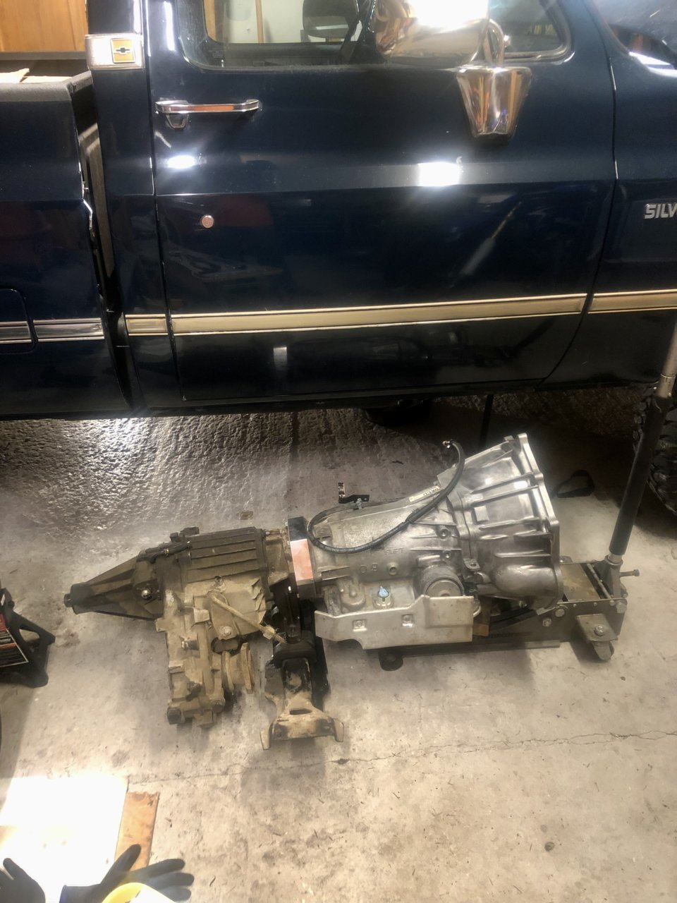

    Dropped the tcase out of the 84 last night and got it mates up to the 4l60e temporarily to make sure the adapter is correct and the spline count is the same.
    Going to clean it up real good tonight and hopefully drop the 700r4 out of the 84.
    jdmjustin likes this.

    700r4 out. Getting a stack of parts

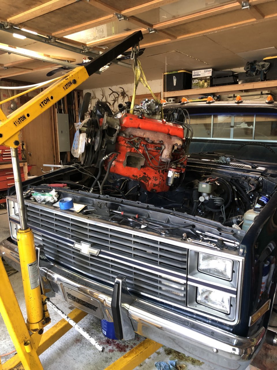

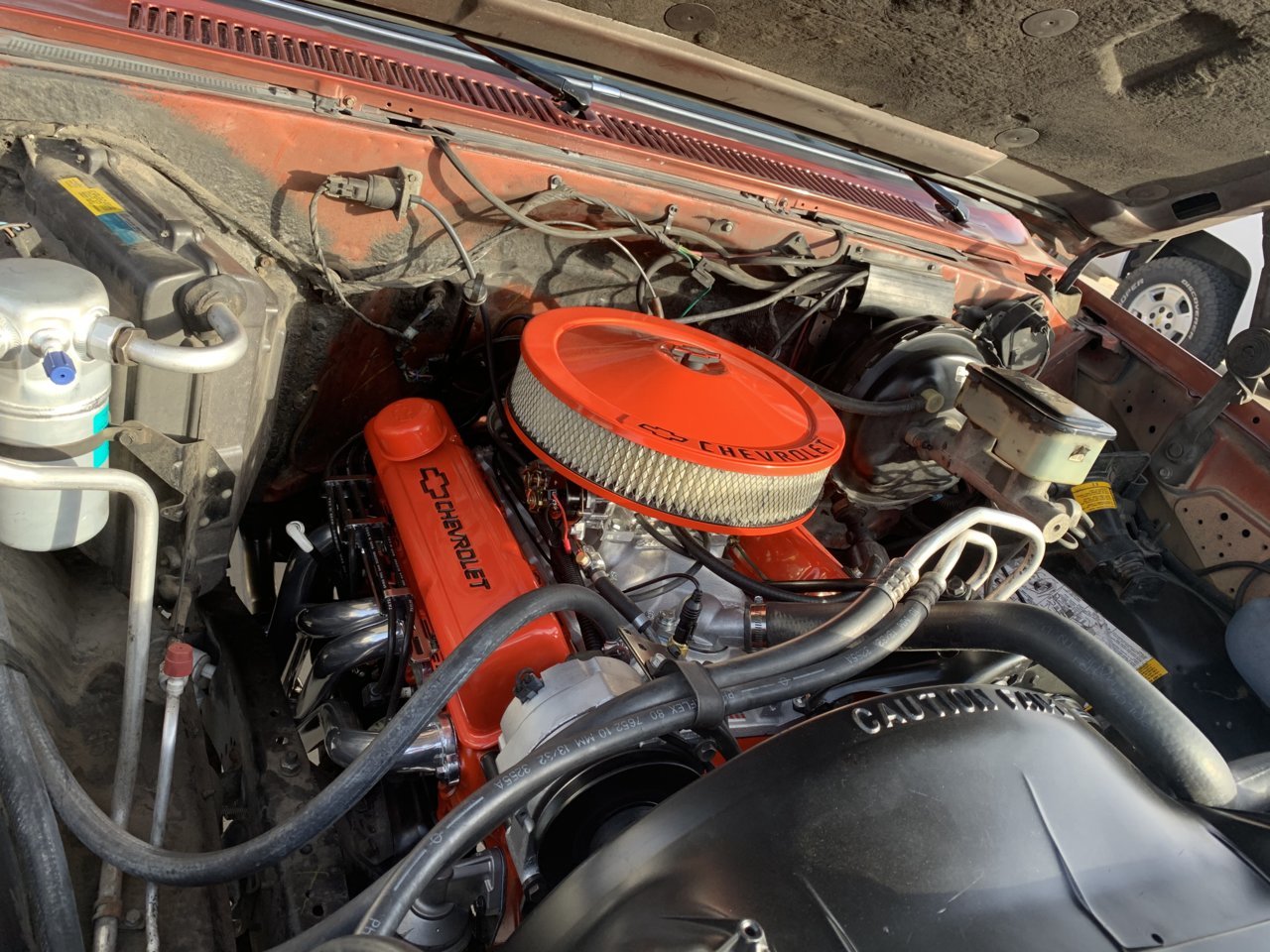

    Motors out!

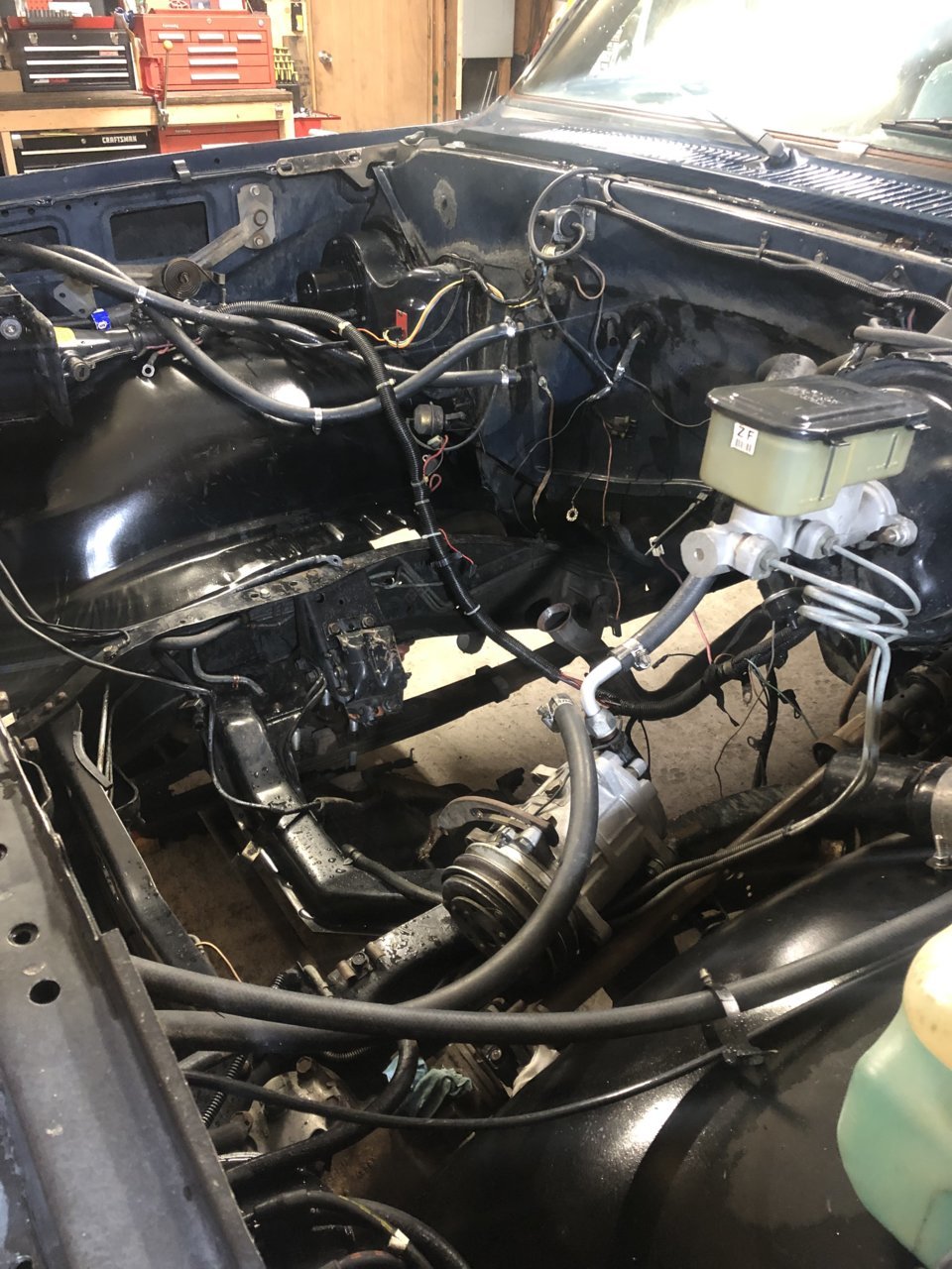

    Round 1 of engine bay cleaning got done tonight. Just waiting for the machine shop to get those motor finished up.

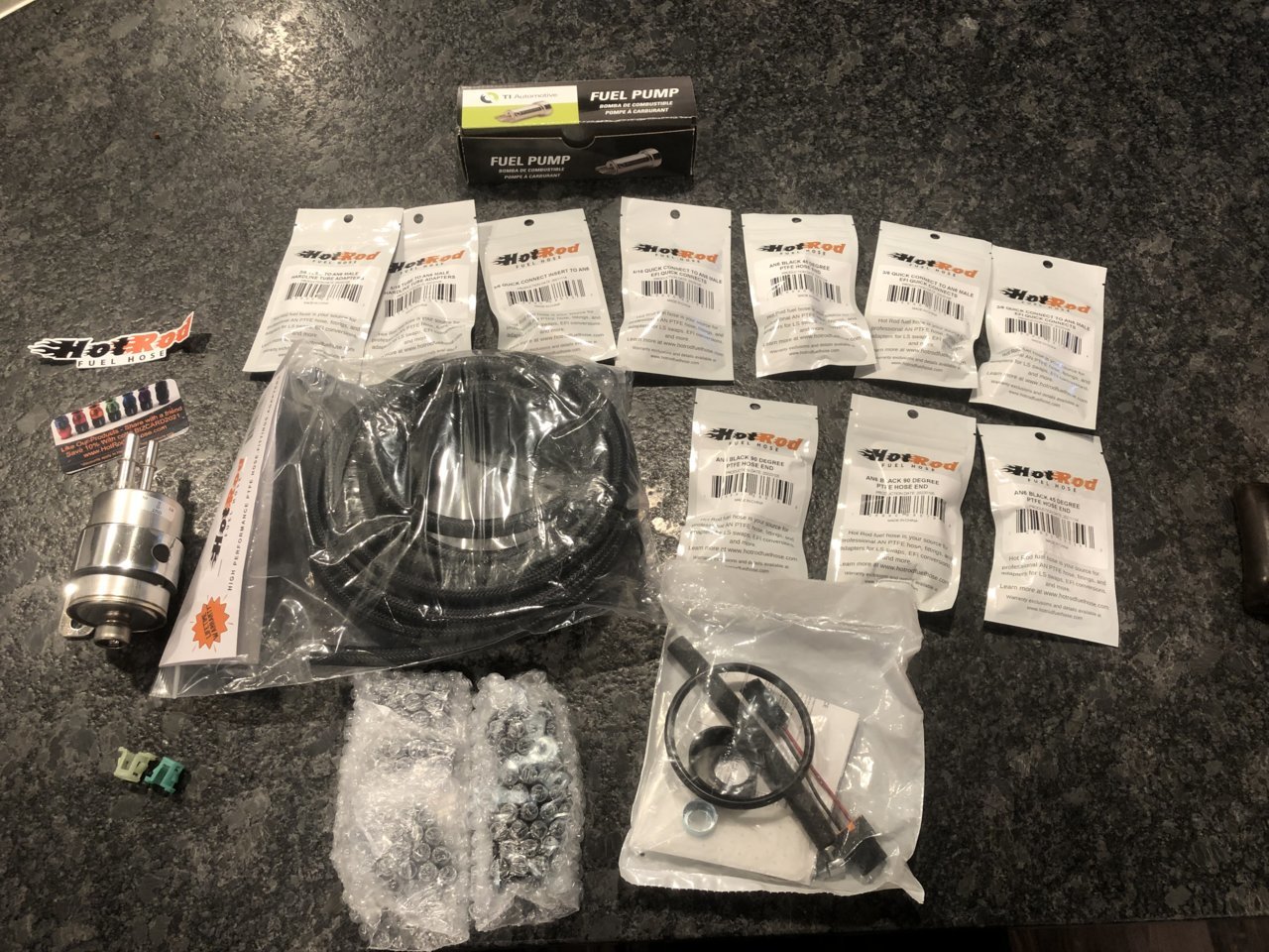

    Ordered up the hotrod fuel hose kit tonight along with a walbro 255 pump. Should have what I need to plumb the fuel system now.

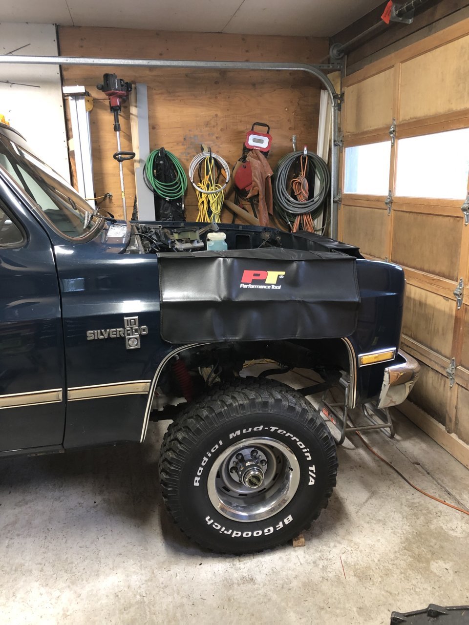

    Nothing to awesome but got some fender mats so I’m not beating up the paint to bad during the swap. Also got some gear wrench socket adapters.

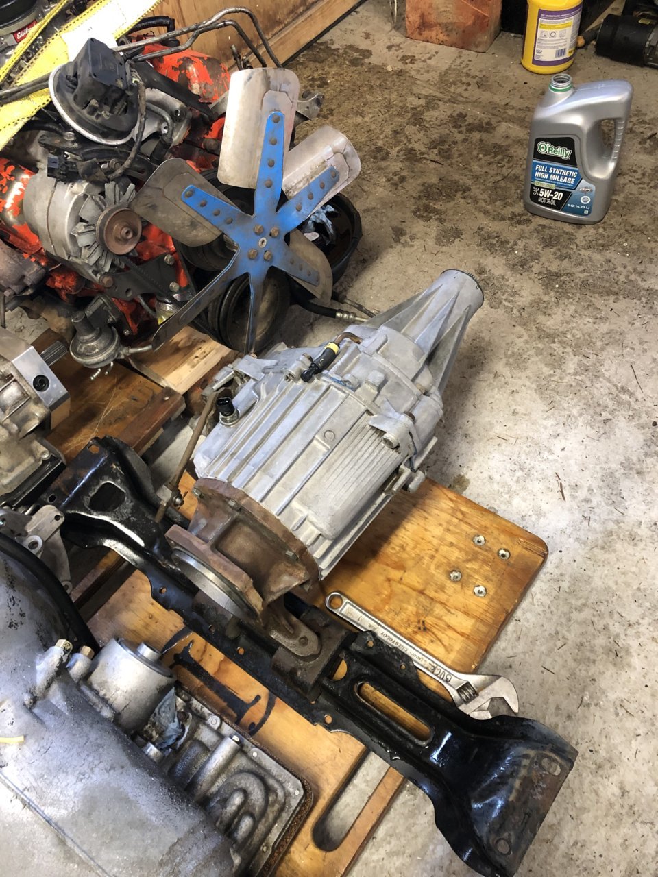

    Cleaned up the Tcase and painted the linkage, adapter, and crossmember today.
