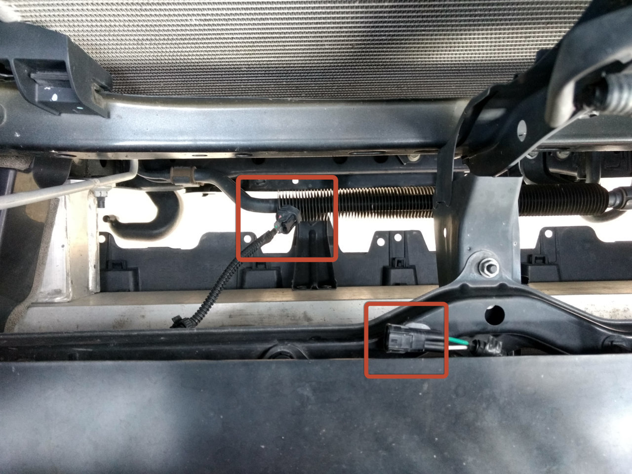

    so i took this picture look straight down in front of the radiator looks like a connection came apart, does anybody know what this connection is? Obviously I'm no mechanic but those look like they should be together. Anybody know what that connection is?
  11. Jun 26, 2018 at 6:21 PM
    Joe23
    Joe23 Canuckistikian
    Oct 5, 2015
    #165909
    11,299
    The Great White North
    2017 TRD Off-road DCSB
    just checked mine looks connected, try plugging it back in if they go together?

    1,057

    See if the plug matches up. If it does put it together.
    Vehicle plugs are much like computers. Unique to reduce errors.

    I put the plug together and went to the store, it indicates 61 degrees still pretty low. I will check it tomorrow I'm losing light outside. I will see if i can find the actual sensor tomorrow.
    Thanks for everybody's input

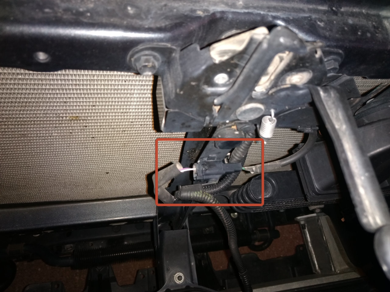

    I this the actual sensor?

    82
    2017 TRD Off Road 4x4
    lol no

    found it
