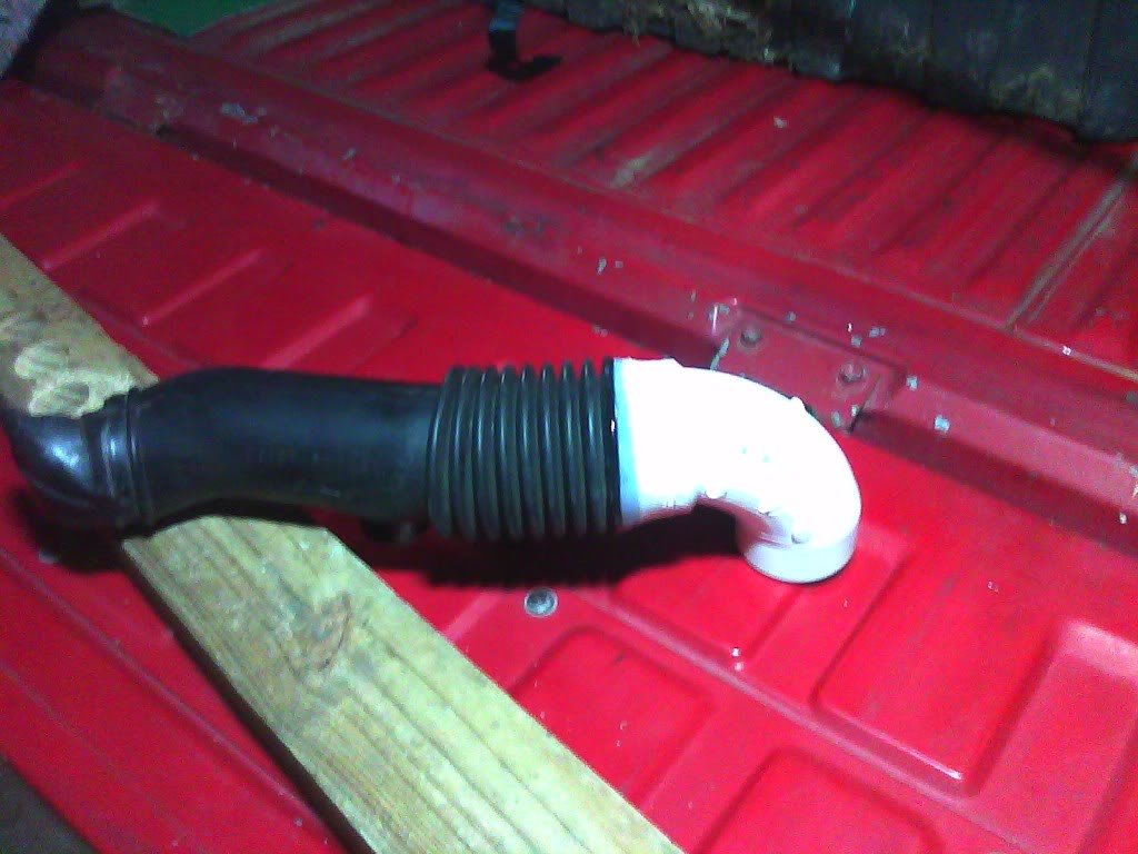

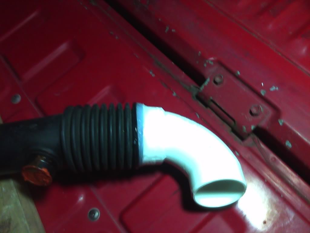

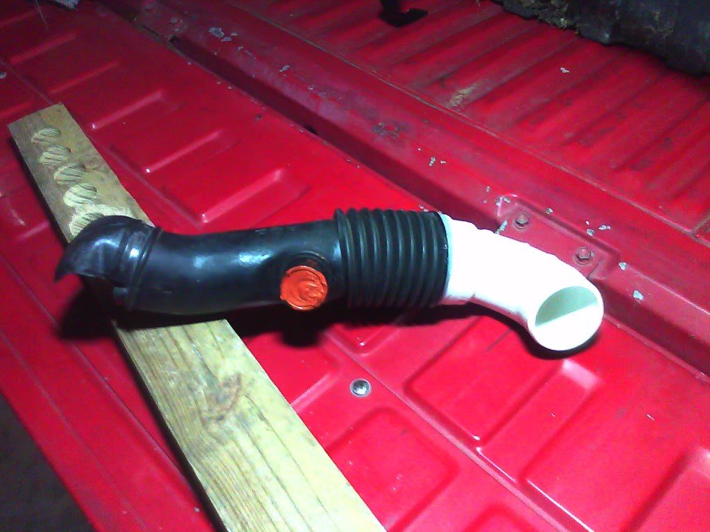

    Granted mine is a 22re this is what I did. I used a 22r intake tube an cut it to plumb into my air box.
    So this is what I came up with for my air box intake tube. I used a 2" PVC street L and the intake tube from a carbed 22R. I had to plug the extra port on the tube and put the 2 tubes together with a bead of silicone. Im letting it cure now and installing after that.
    Try a Pick and pull or ebay for a carbed intake tube. There is a thread on Marlin's forum called Practically anything you want. They have everything for 1st and 2nd gen trucks and 4runners.
