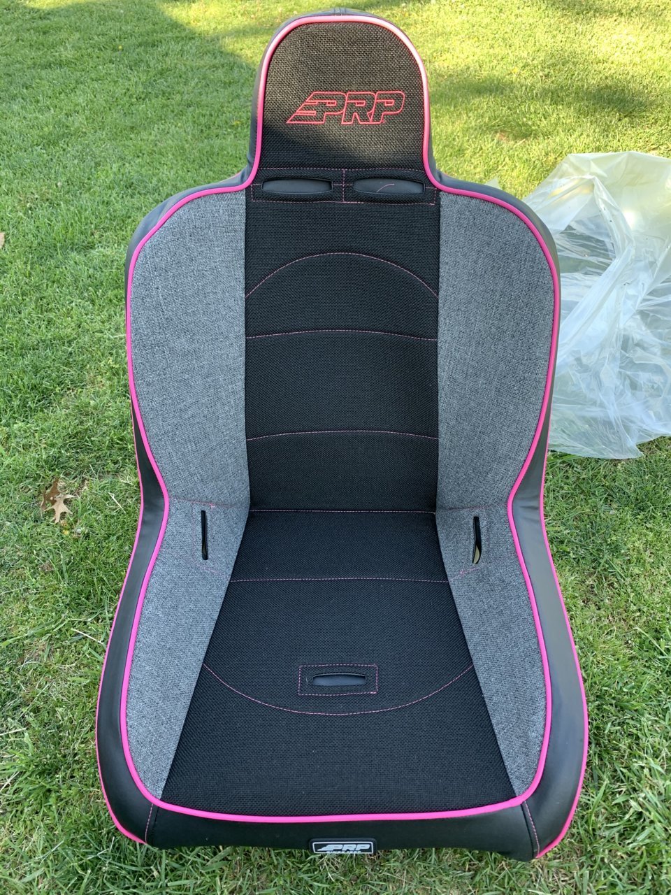

    God I need to update this. I went a few different routes. 1CD26AD9-125F-4400-AB5F-9B8E11A1A4C7.jpg
    these are the seats I went with along with new to paint to match them lol and new rubber and wheels. Went up to 17s.

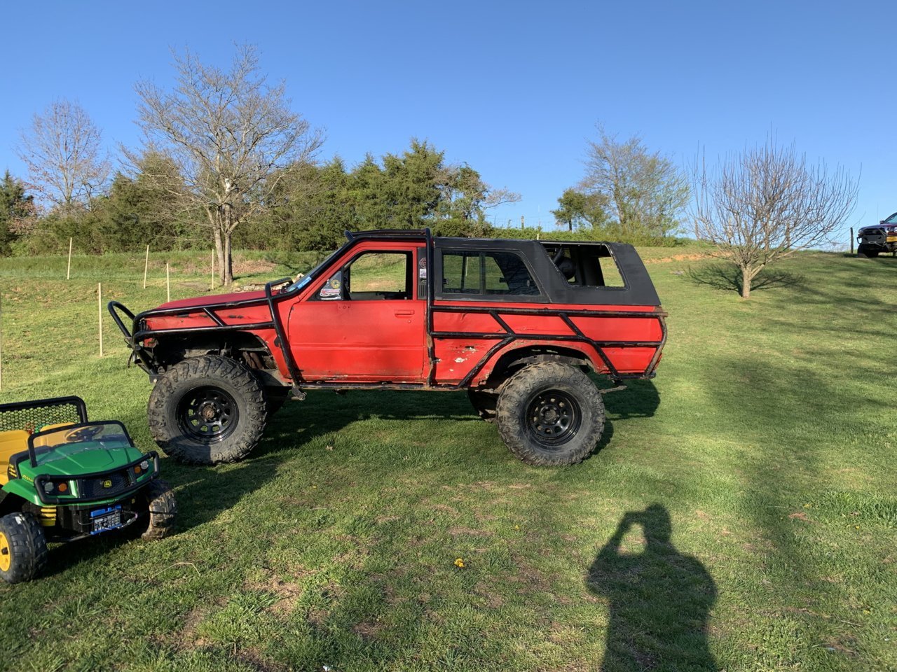

  5. Sep 10, 2020 at 4:57 AM
    drunktaco
    drunktaco [OP] Well-Known Member
    Aug 25, 2012
    #85509
    1,787
    Sage
    Southwest Va
    Icon ext travel C/O's, Total Chaos UCA's, King R/R shocks, All-Pro leaf pack, lights, RCI skid, Brute Force sliders, ect.
    New tires on it before I went beadlock and custom rear window vent installed via trail DAD87CA9-A346-4BFD-8752-BDCB5FBD83F7.jpg
