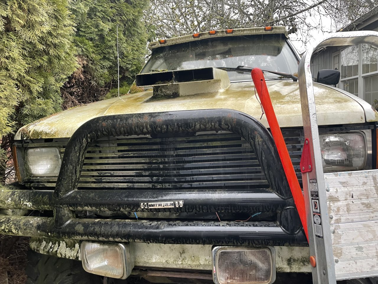

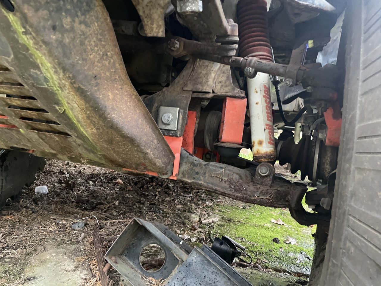

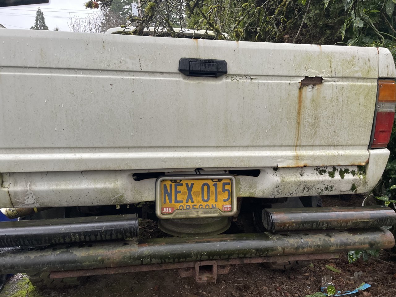

    I’m getting an 86 pickup 4x4 with the 22R (someone is giving it to me) and it’s been sitting outside for 30+ years (since 89). The truck has 22k miles on it and it has a manual transmission. I was originally going to use it as a Gambler 500 vehicle but am having second thoughts on that. I might just put it back together and add some miles to it every once in a while.
    The back window fell out years ago so it’s been getting rain inside for who knows how long. The bed has some rusted out spots towards the back (might convert to flat bed later on).
    I have a while before I can work on the vehicle but I would like to have a general idea on where to start. These are the only two pictures I have right now. 462C0888-0FD5-4518-860C-7832387F9C67.jpg0F00EE14-D07A-46EA-AA4F-424304FEAC61.jpg

    Sweet, change all the fluids, all of them, radiator, brake, everything. Take the plugs out, get new one's, pour some motor oil into the spark plug hole to lube the rings and cylinders, turn the engine over by hand with a big socket and wrench on the pulley bolt, if it doesn't turn over by hand, try the starter, if no go,....... now you're looking at tearing into the engine to see what's up.

    I just got my 86 going after I wrecked it 10 years ago. Definitely drain the tank, most likely you’re going to have to remove it and get it cleaned or replace it. Replace the fuel filter, change first the motor oil and antifreeze as well as the spark plugs. Fuel does sit in the carb and I’m sure your carb needs cleaned but I would try to start it at first without cleaning it. A little oil in the cylinders would be good. My truck has 345,000 original miles, your truck is just barely broke in. This is just what I think you need at the start, you’ll have a lot more to do to get it road worthy.

    I agree. Makes it look like a Lego truck. A56CE43E-1FA7-4182-AA0E-B16D78599356.jpg

    That hood scoop is so bad it's kind of awesome. I would keep it

    Neat old truck. I have restored a couple old cars over the years and it sounds like your getting good advice. Check that frame over real good before you start tearing into it.
    The hood scoop would look great if there was something under the hood. I laughed when i saw that because it must have been a popular item to put on Tacoma's back in the 80s. My brother in law had a red 86 with the same scoop. He still has most of that 86 sitting under a 93 now. The hood went to the scrap yard with most of the body when he did the swap 2 years ago.
