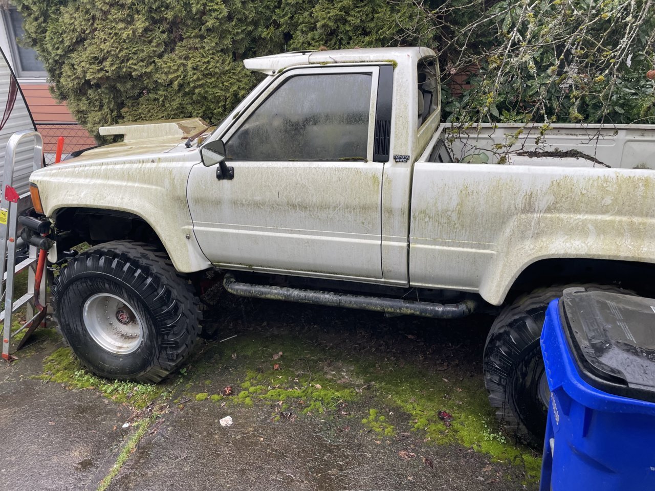

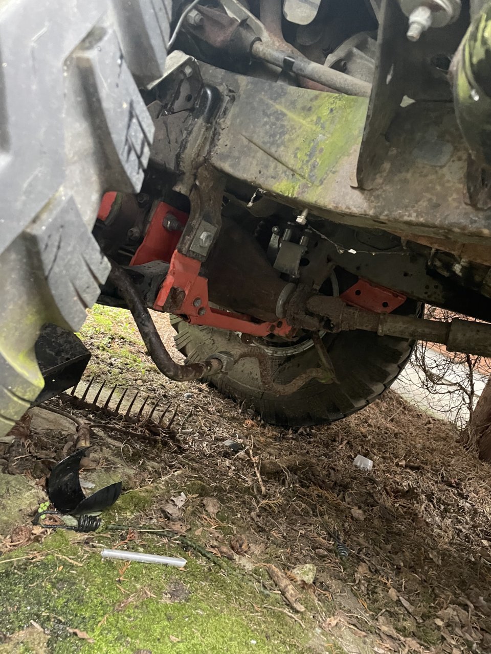

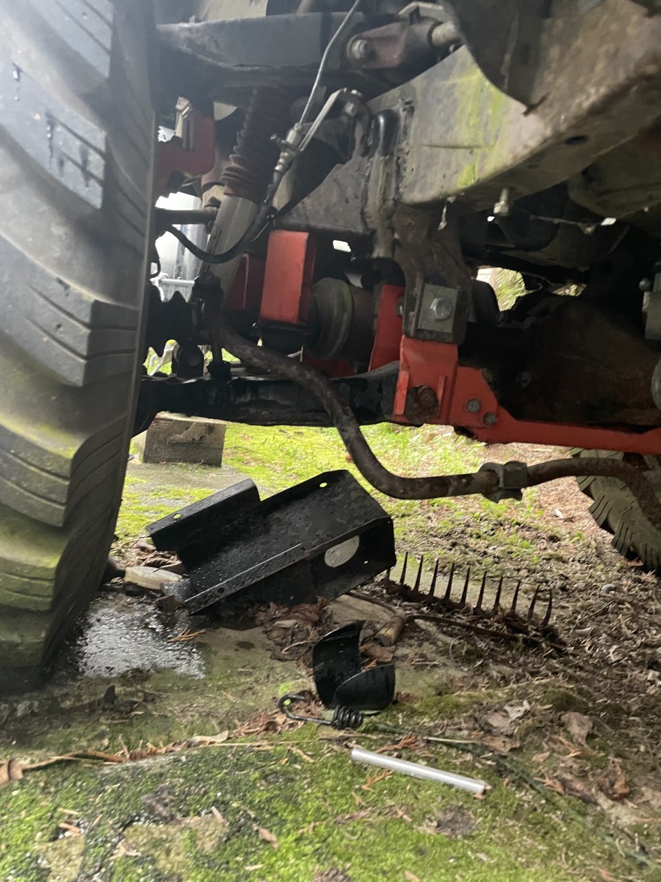

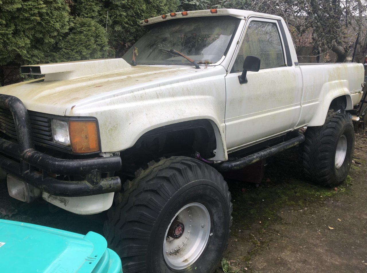

    Truck looks to have 4” suspension and 3” body lift on it.
    Lift kit is a Trailmaster and it is kind of a pile. Bad part is it is a bit of a challenge to go back to stock. You will have to track down new spindles and (IIRC) steering arms.
    Would also have to fabricate some of the front diff mount as it gets cut to install that kit.
    It does take all OEM balljoints and tie rod ends though.
    If you lose the bodylift and relax the torsions a bit, 33s look good on it.
    My garbage has the same kit on it.

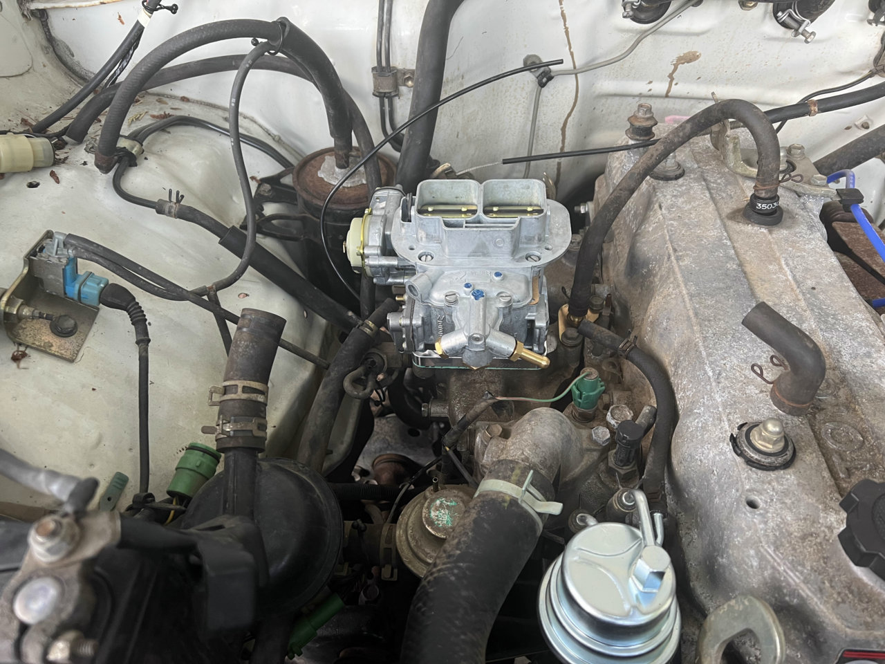

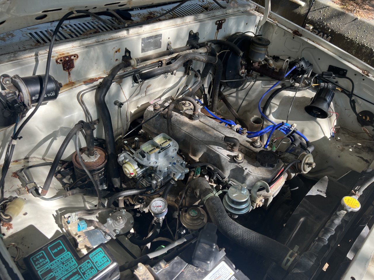

    Weber carb came in and I was able to start the install. I removed the old carb, installed the EGR block off plate and secured the Weber carb on the manifold. I thought it was going to be a plug and play but I need to get a few fittings/hoses sometime this week. I also need to find a good spot to mount the fuel pressure regulator and gauge. I'm having a hard time with all of the emissions/vacuum lines. From what I understand, I need to run both vacuum lines from the distributor back to the carb. Which one goes where??
    As for the rest of the emissions/vacuum lines, do they just get capped/removed from the vehicle. Most pictures I've seen are similar but have slight variations that make me unsure of what to keep and what to discard. Ill get some better pictures tomorrow, but here is what I'm working with right now.
    oldtimertoyota and RustyGreen like this.
  11. Aug 3, 2022 at 5:39 AM
    #91
    la0d0g
    Jan 25, 2011
    #49903
    19,908
    running for the hills
    For crawling not hauling
    Block off the front and run the back one

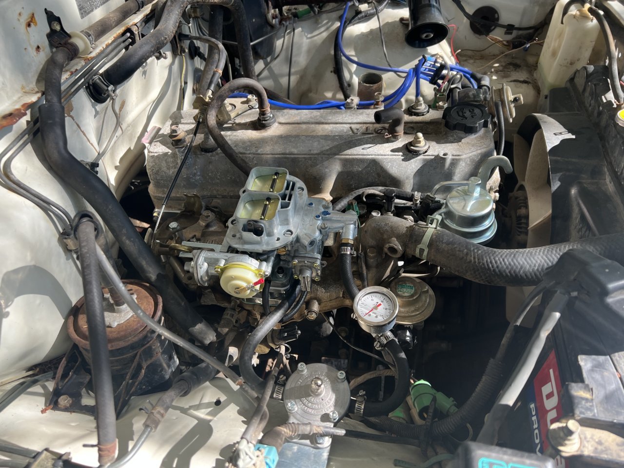

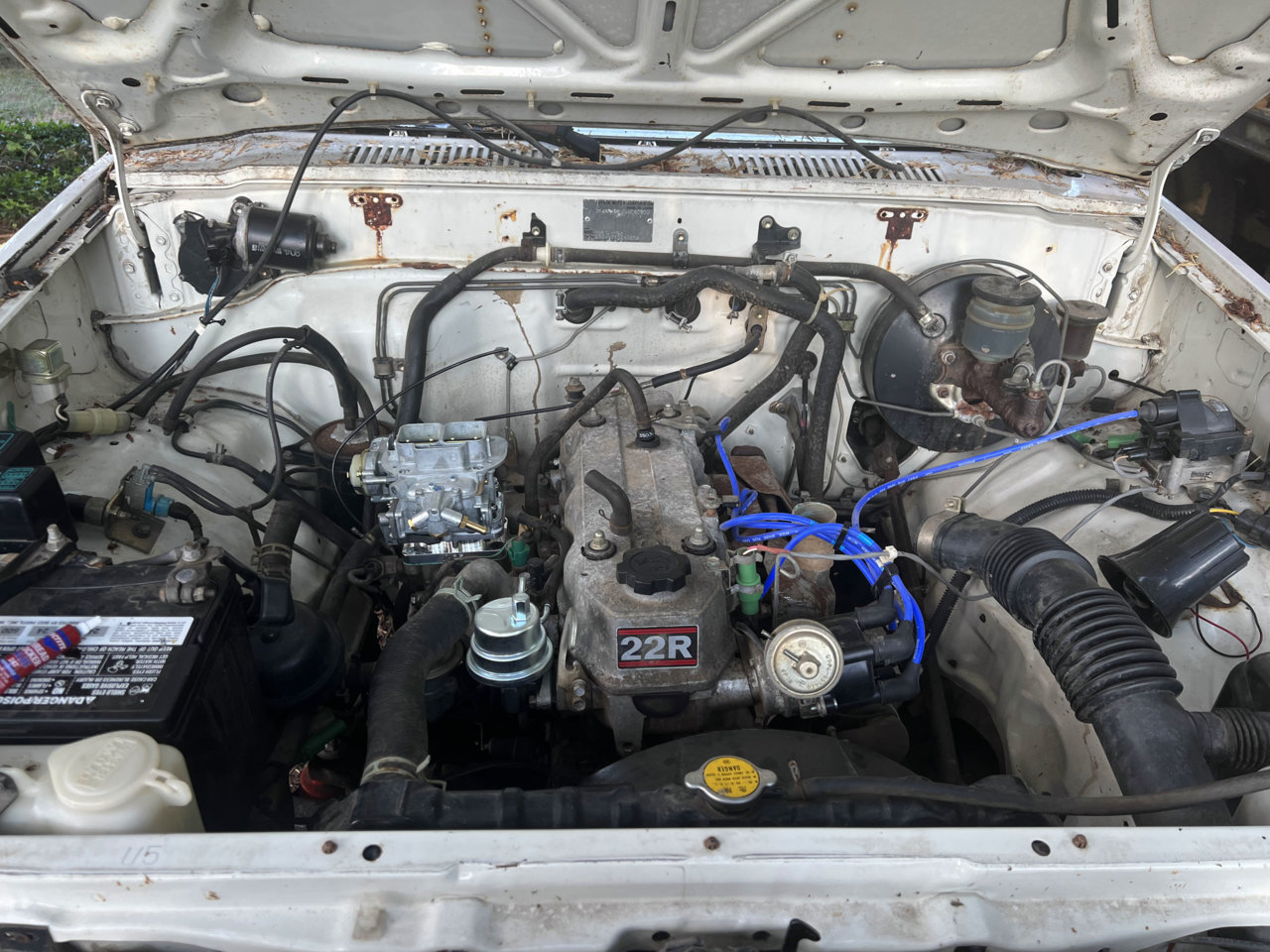

    I need to clean up the engine bay and remove a few more items.
    Capped a few vacuum ports and installed the Fuel pressure regulator as well as the gauge. If I’m missing any steps or I can remove anything else let me know. I don’t think I can take off too much more without needing block off plates but I could be wrong.

    turn the key and see if it starts....:popcorn:
    following this thread with much anticipation..

    Looking like it's coming together!
