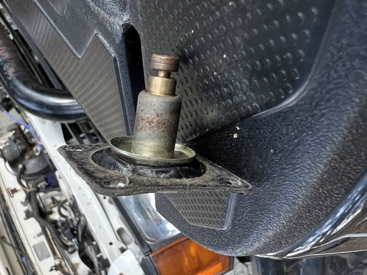

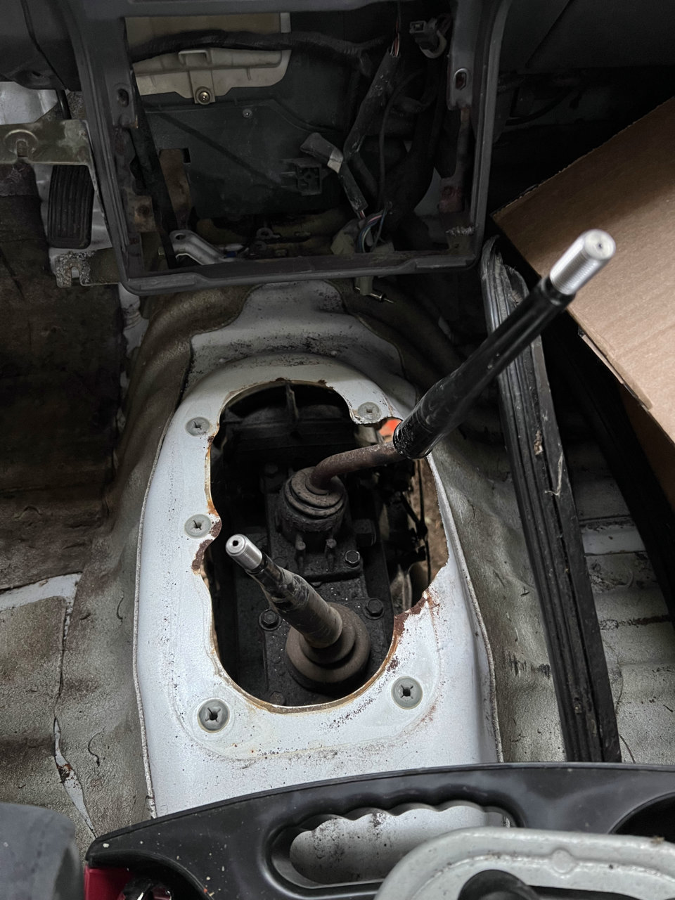

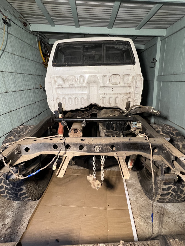

    Cranked it to make sure there wasn’t any leaks. Started without any issue. It started and felt completely different than with the stock carb. Also added a picture of one of the carb plungers. It had zero elastic properties from sitting so long.
    I’m looking into going back to stock suspension for the time being. Keeping the lift is going to be the same headache as trying to put it back to stock except with unnecessary strain on the drivetrain. I reached out to someone local that has just about everything that I need to put it back to stock. Still trying to figure out the piece that was cut to accommodate the diff drop.
    I pulled the cover off around the shifter boot and the transmission seemed to be sitting straight. It looks like the cab was cut to accommodate the shifter being so far over in 5/6th gear. Or is this how it comes from factory?
    Quick video of it starting. Don’t mind me trying to figure out which side was up.

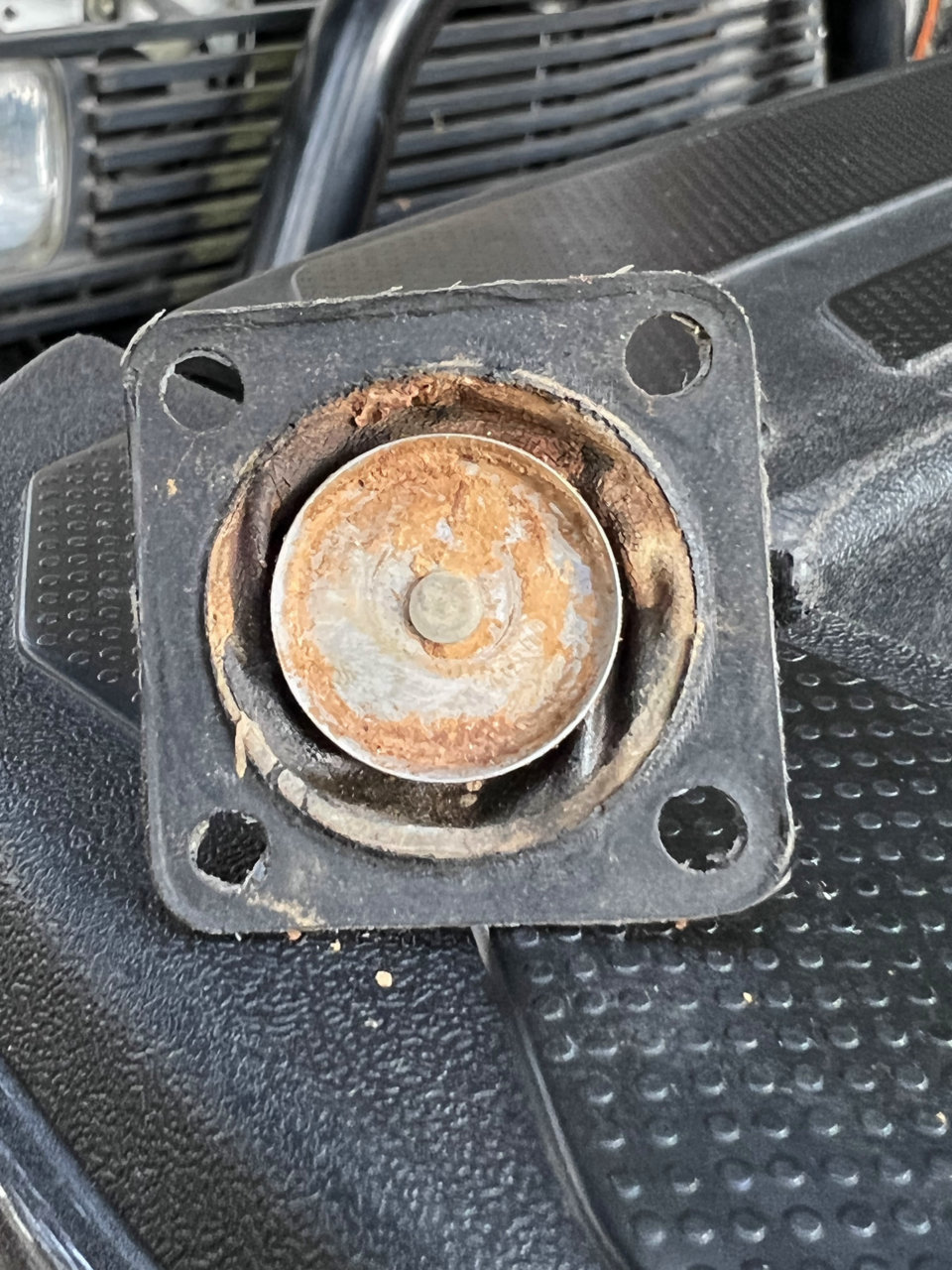

    Looks like it was cut to account for the body lift. They usually come with shifter extensions but if the installer can’t or doesn’t want to cut/weld, they have to enlarge the opening.
    The part that you have to recreate is the tab that holds the front crossmember that carries the diff.
    Here is what a stock one looks like and here is the lift kit one. It is the mount on the left that gets chopped off.

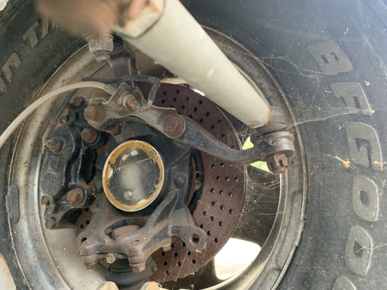

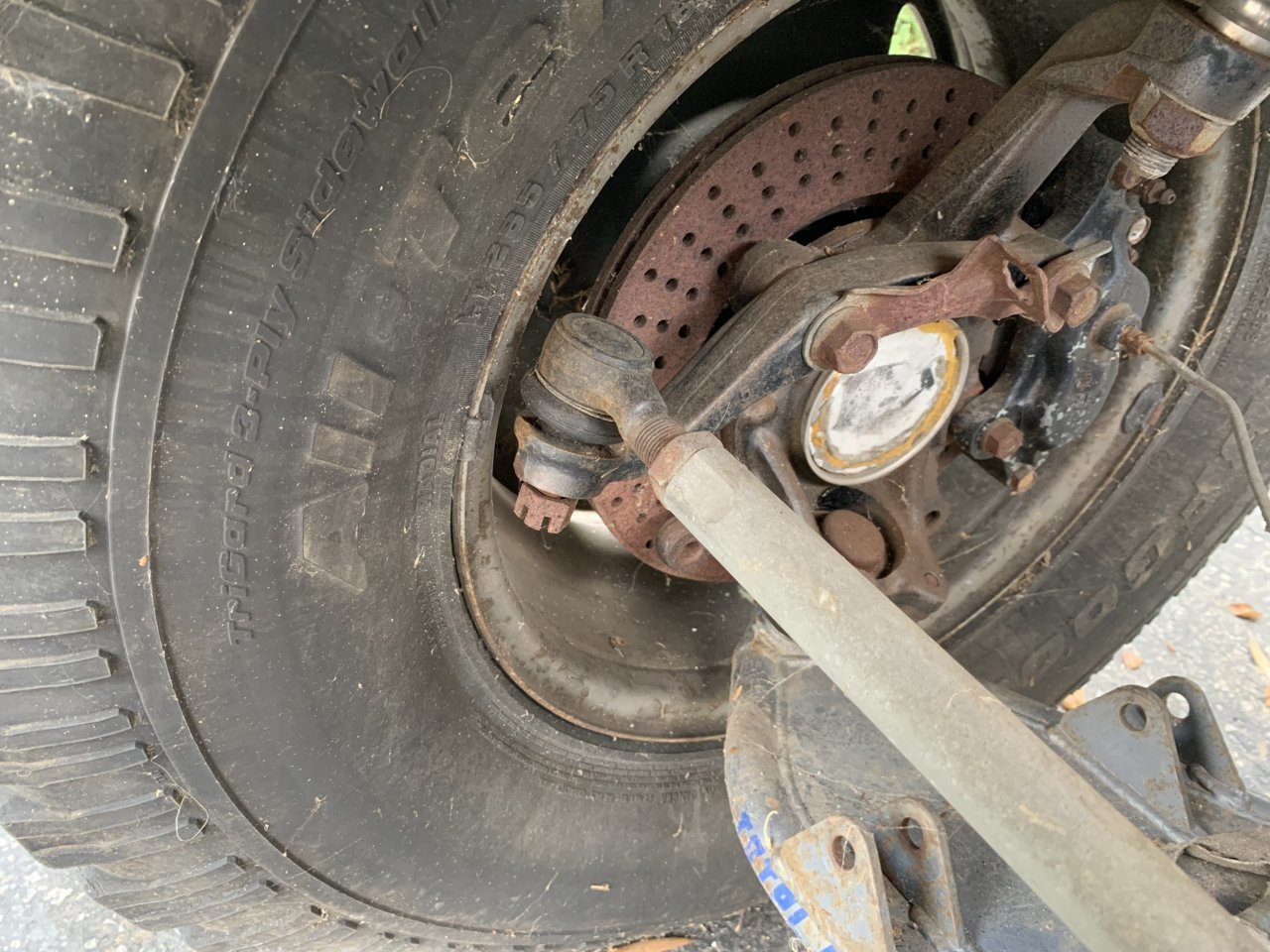

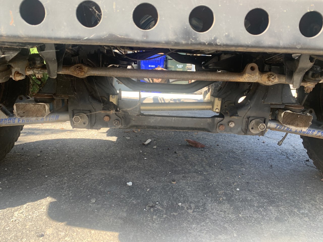

    3EBDAC71-C6A0-4B5D-9EAE-5C86A5F87C49.jpg 49D688D2-4722-411C-A6F5-08B109546384.jpg
    Havent had much time to work on the truck. Prepping for a move these past couple of months. I don’t think I’ll have any more time to work on it for a while. I cleaned the undercarriage and sprayed it with fluid film.
    I might just order parts while I’m away and install them when I get a chance. Can you take a picture of the front side of the spindles/knuckle? I’m trying to figure out where the tie rods connect to on both sides. I’ll upload a picture when I get some better service of when I’m confused about.

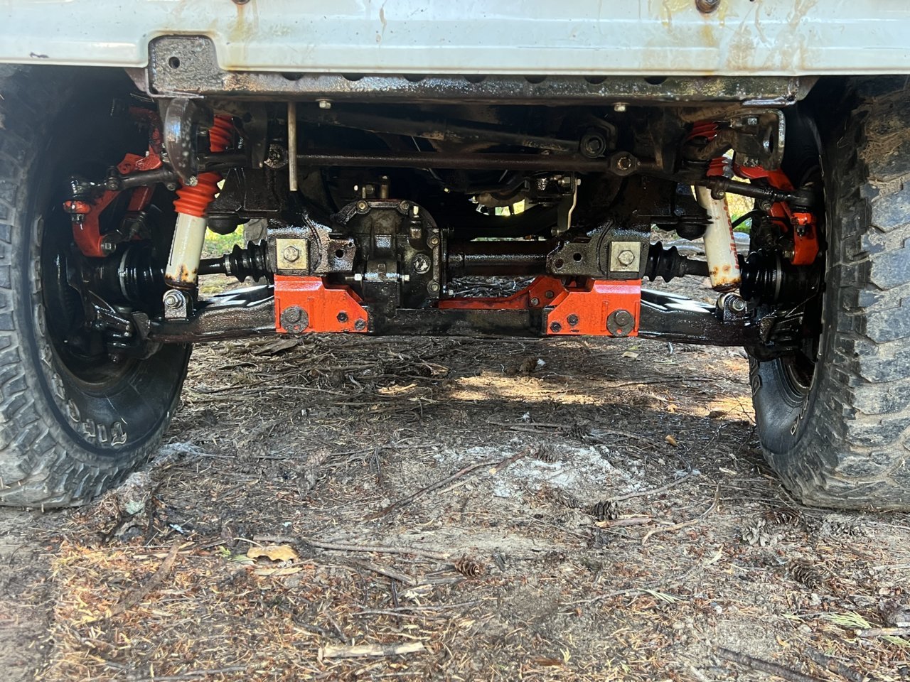

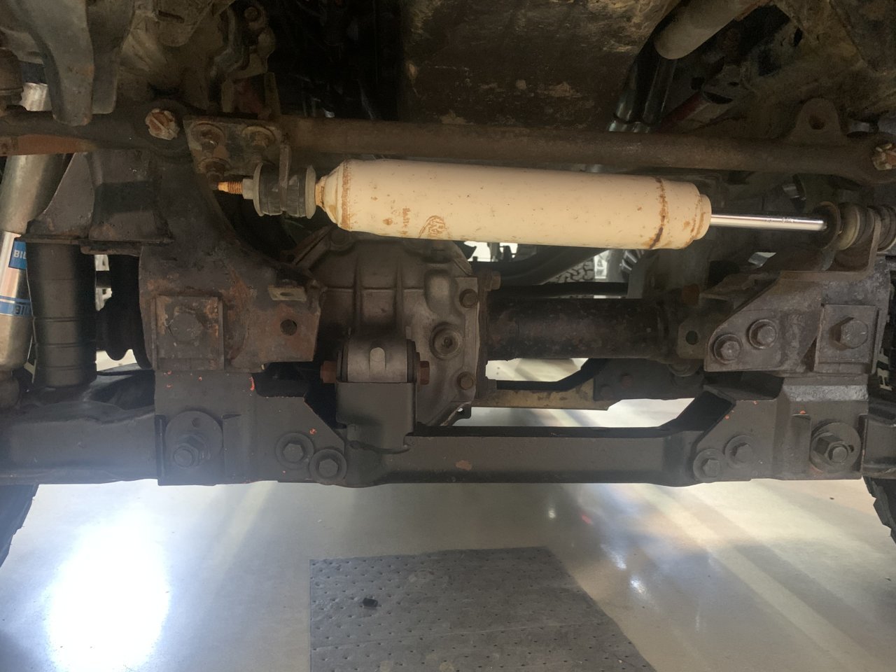

    Here are some pics of the spindles and steering arms.
    Keep in mind this truck has aftermarket upper/lower arms on it and is missing "a few" parts (like a drivetrain).
    ETA: I just noticed that your truck is missing the bumpstop extensions. If you were to bottom the suspension out on with that kit on it, it would be using the shocks as bumpstops (with predictable brokenness). The extensions on mine (chunks of square tubing) were bent so I replaced them with some aftermarket bumpstops (I think they are for an XJ or something, I can look).
