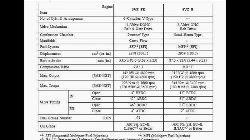

    Manual recommends 91. Says 87 minimum somewhere though

    Yeah 91, my chilton book says something along the lines of only use 87 if a higher grade is not available, I've been running 93 as of late as Im about to get a lil snail lol

    That means that those numbers were achieved using 91 octane, not that it's required. Your 3.4l engine was designed to run on 87 and will function just fine on it. You're only required to run higher octane if you're running with forced induction.
