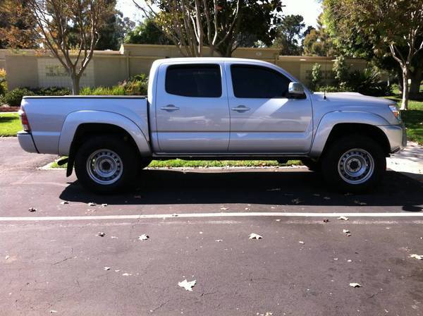

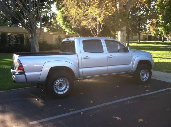

    Sorry, my photos are not that great. I will try to take some better pictures that show some more detail, but I snapped these with my iPhone facing the sun...
    in any case, my truck is level. With the 883, it wasn't level and I could feel it driving and braking. I haven't done anything to the rear of the truck other putting the new shocks on, I'll take pics of the rear when I take pics of the truck, I can't remember if mine came with the TSB or not.
    I dont have hub to fender well measurements...
    - No, the first pics (post #8) are with 883, you can see the pitch, the second set are with 884. If you look at the pics from post #8, middle picture, take a look at how the rear line of the bed dives to the front of the truck.

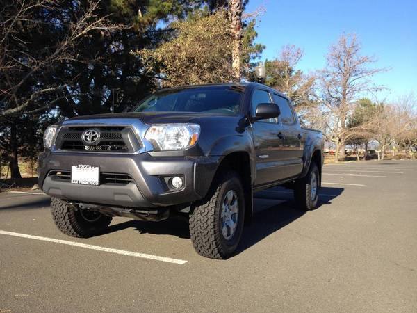

    Here are some pics of my 2" lift:
    It turned out perfect. Perfect stance and no problems.

    Nice, looks pretty good with stock sized tires too. now I just have to come up with $800, haha. How long did the install take you? Any snags while doing it?
