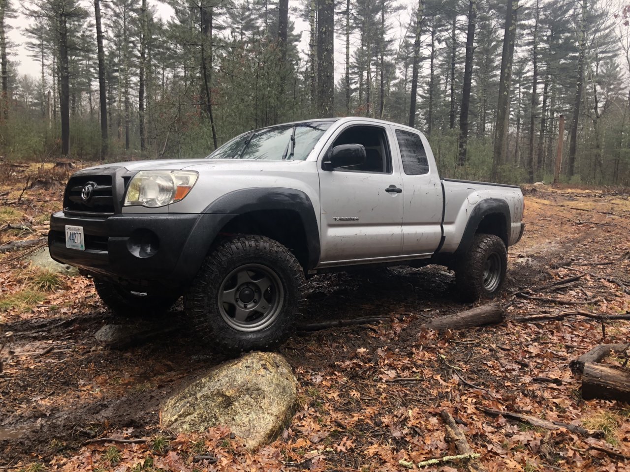

    She’s doing great so far! Not a big fan of the bilstien 5100’s /884’s upfront though, feels great onroad but bounce around like crazy even on gravel roads.

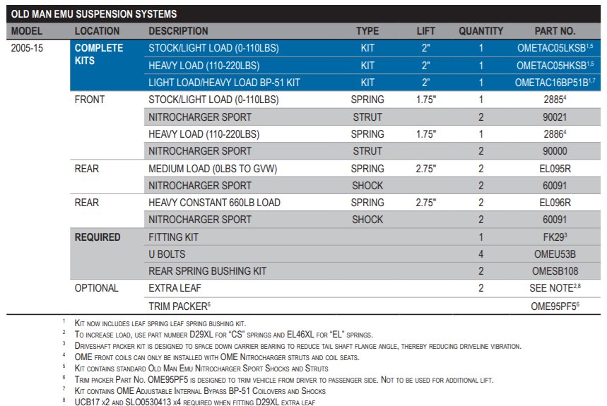

    Chiming in a little late but i ran 4600/884s on my 2005 AC TRD OR, and 4600/885s on my 2015 DCLB TRD Sport until recently going to 5100/521600 ....
    It was my understanding to run 884 on RC/AC, unless adding weight (bumpers, dual batteries, etc) then go to 885s
    885 on DCLB, unless adding weight (bumpers, dual batteries, etc) then go to 886s
