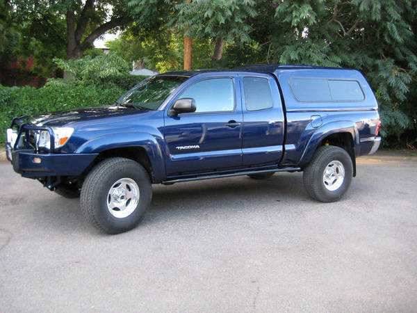

    It depends on your usage and off-road mods. I'm running 886s and with full armor, a shell, & ARB bumper they required 1" Toytec spacers to maintain even lift.
