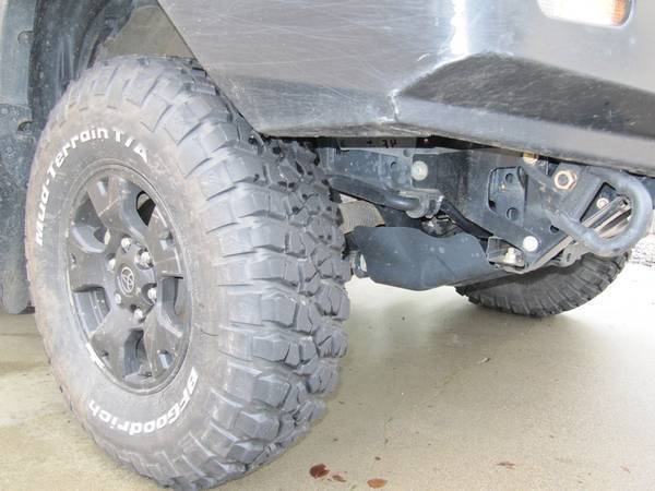

    I have run 255-85R16 BFG KM2's on it for my mud tires but now I run 245-65R16 Toyo M/T. The 255 were real close to rubbing but did not. I just didnt like the MPG loss and the re-gearing. So back to stock sizes now. I run a different set for Hwy use. They are 265-75R16 Toyo A/T.
    I have had the lift on for about 2.5 yrs, have had over 1200 lbs in the bed and tow a 7x14 fully enclosed trailer with quads in it. That trailer totals about 4000 lbs. I have no sagging in the back end of the truck. But I run all 7 leafs on my setup. I do have a slight lean towards the front as like stock is. But I like that setup for me. Some prefer the level look.
    Now the front has settled maybe a 1/2" but the back has not so far.

    The 1200lbs in the truck was just that. I didnt have the trailer on it at that time. But it was level on the truck. The back springs are a great setup. Here is a couple of pics of the tire setup.
