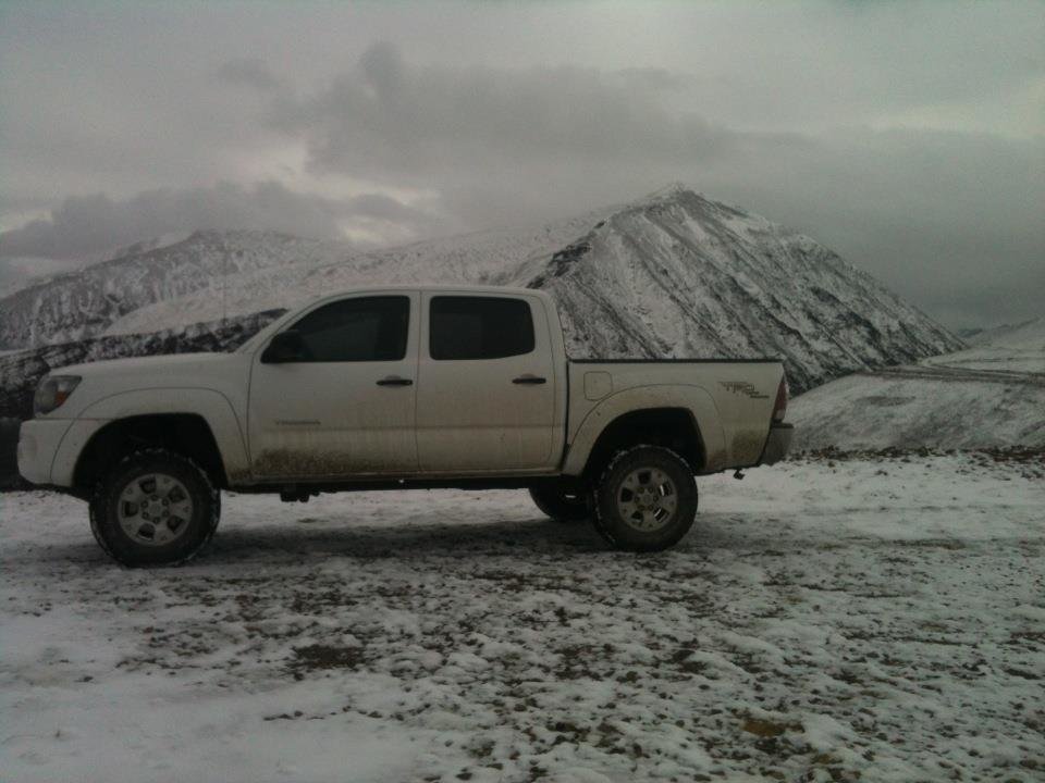

    i have dcsb with no armor and am running 886x's(no top plate spacers) and dakars. its not as bad as a ride as people make it out to be. i did not measure before and after so i dont know EXACT amount of lift, but id say its between 2.5-3"
    heres a recent picture... factory tires.552006_10151142566523762_2112160583_n_fc95a54a22da5151d6372fca6614cd392a26b167.jpg
