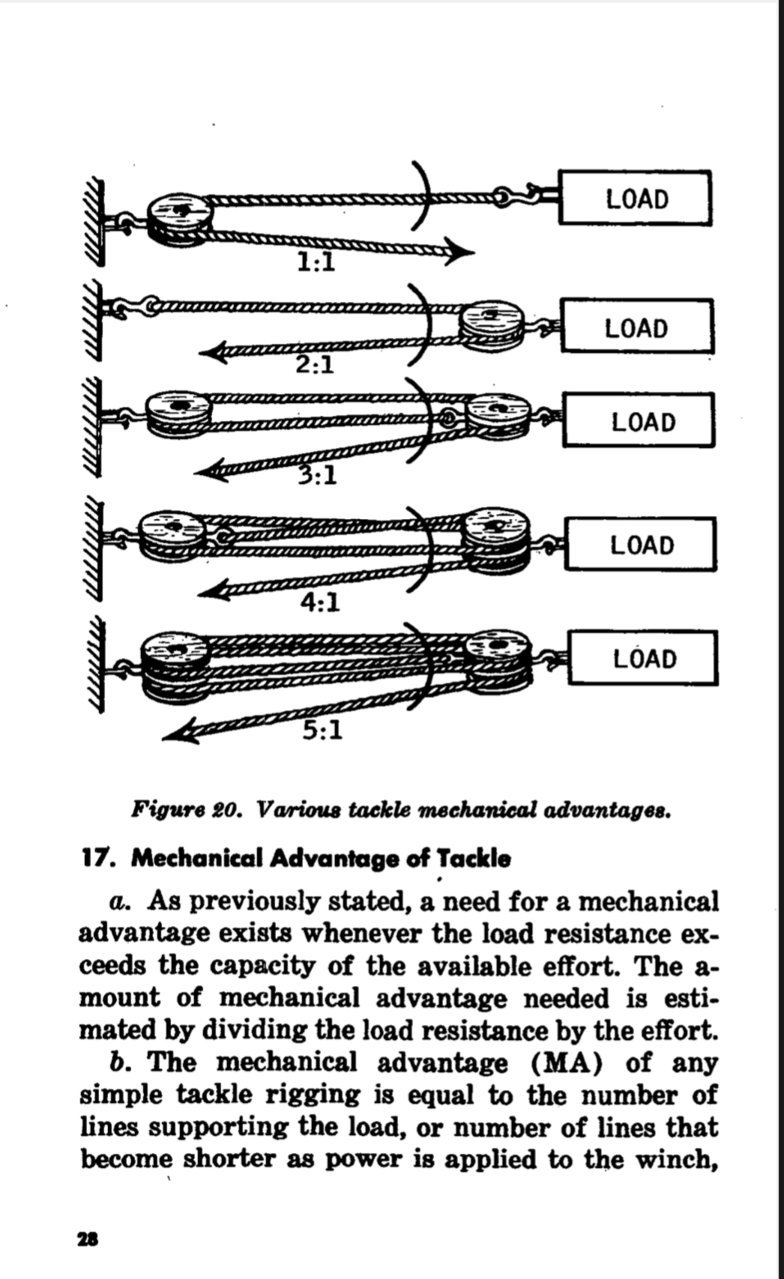

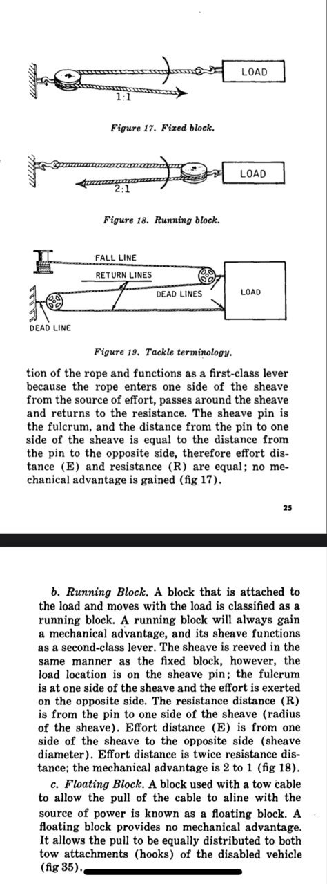

    Show me how. From FM20-22 page 14
    or watch until 2:10
    a single pulley/snatch block will not provide any mechanical advantage, it only changes direction of pull

    your truck is the resistance, right? the effort is the winch, right?
    Are you saying the Army has had it wrong since 1962, and all the guys doing all the videos who teach physics and stuff are wrong?

    here you go, right from FM20-22. It’s a 2:1 mechanical advantage. You are both attached to and pulling from the vehicle.
    https://www.steelsoldiers.com/upload/misc/FM20-22.pdf

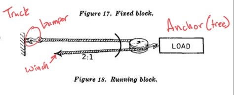

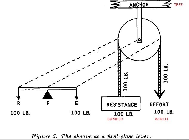

    OK, lets start small here.
    Do you agree that in the illustrations your truck would be the LOAD (the item you want to move)?
    Do you agree that your snatch-block would be attached to a non-moving anchor (tree, rock, etc) ?

    Accurate. Anchor is seeing the full force of the pull where your bumper attachment is feeling half and your winch is seeing half
    This is not an accurate representation of what your forces are doing when you're attaching to the same load. Sum of all forces must equal zero in a static situation. Anchor point (tree) sees the full 8000lbs where the winch (truck anchor point 1) and your shackle mount on your bumper see 4000 lbs each. 2:1 mechanical advantage.
