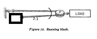

    Question for you since you have some good points on this. If I don't have a winch but do have a snatch block and cable or synthetic rope, I can still get double the pulling power? One end to a fixed point, the pulley on the stuck vehicle and the other on my truck pulling I can get 2 to 1 pulling power, correct? I never go where I would really need a winch so thinking of just getting a snatch block and cable/rope just in case. I never would've thought of this until you posted these pics. :hattip:

    Yeah. It’s all about how you rig the system.
    I’d get a recovery donut and some soft shackles. Then some winch line extension. You’d have a pretty versatile kit in a lightweight package.

    The lines need to be parallel, but yes. There’s some frictional loss from the block, so even if they’re parallel it isn’t quite 2:1. The greater the angle from 0* the smaller the advantage becomes. I don’t remember the exact math, but I think anything more than 30* off the block it actually begins to put more load on the anchors than the load.

    Throw a second pully in your kit to get to 3-1 or to have more cable out on a close anchor. Pay attention to any side slope.
