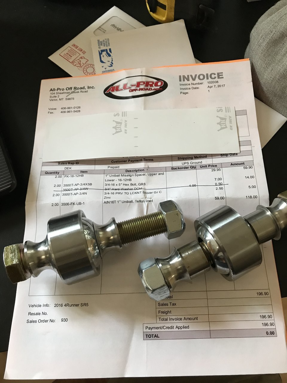

    I’ve got an extra set of bolts, spacers, and bearings for sale. Special pricing for TW

    Nice, I don't think I need Uniballs yet.

    I might need them after all

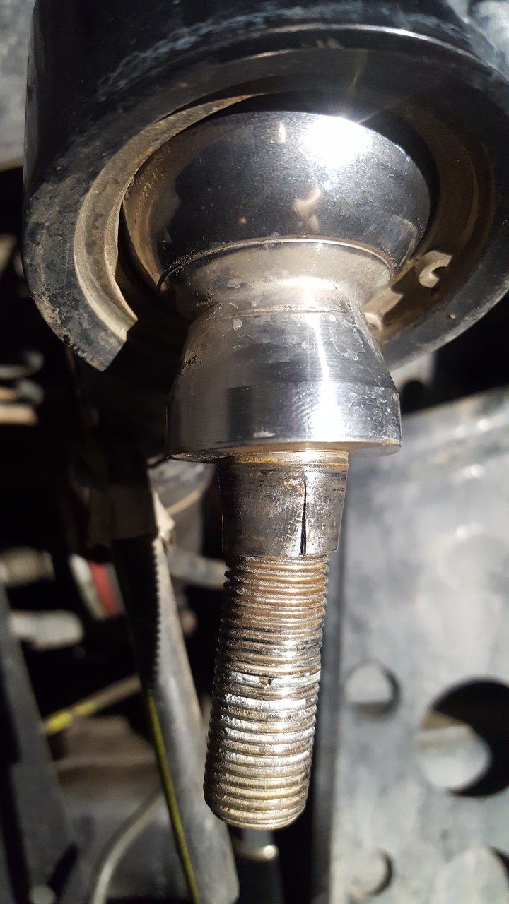

    You have that tapered sleeve to fit in where the ball joint would be. That a 3/4” bolt. My spindle is drilled out to 3/4 to get rid of the ball joint taper.
    Think you have a 9/16 bolt.

    Bump stop too soft. Hitting upper side of fender wall. New spacers/bolt and limiting up travel should do it.

    Drill your spindle out to 3/4" so you won't ever have to worry about that again.
    Nevermind, Mike said it first.

    I think I need new Uniballs too. :mad:
    How do you guys drill to 3/4 on the spindle?
    I really don't have time to take the spindle off the truck right now. I'm actually gonna run the truck with the same bent spacer until I decide what to do. (New spacers or 3/4 route)

    I just hit the spindle with a 3/4” drill bit and wd40. Slow speed. Want a tight clearance. Takes forever to do. A step bit might be faster or a 5/8 bit first. Never tried it on a spindle yet.

    A 5/8 bolt would be an option too. Future proyect maybe.

    Whatever size it takes to drill out the taper if doing the switch.

    If you’re gonna go through all that work, might as well go 3/4 and be done with it.
