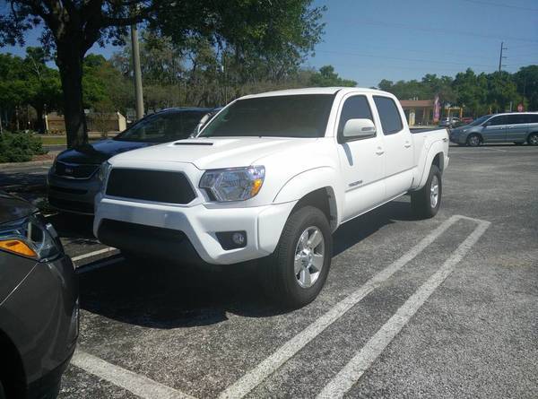

    40% Llumar CTX in the rear and 15% in the front. Not legal, but I've never had problems since we live in a place where sun and heat are big issues, and most cops tend to be understanding as long as you play nice (protip: if ever pulled over, especially at night, roll all windows down and turn the domelights on the moment the cherries light up behind you. Makes the cops feel MUCH safer. Also provide CHL immediately and be proactive about any firearms in the truck, even if you're not legally compelled to do so). It's also the only combo in that tint that provides less than 2% VLT difference between the front and factory tinted rears when installed. Tint was purchased precut from tintzoom, which is an awesome retailer with great prices and customer service. Did the install myself - it's fairly easy on trucks as there are no compound curves that require the tint to be shrunk to the glass.
    Not the best pic to show the tint, but you get the idea. I also have an obvious love of white cars with hood scoops :D

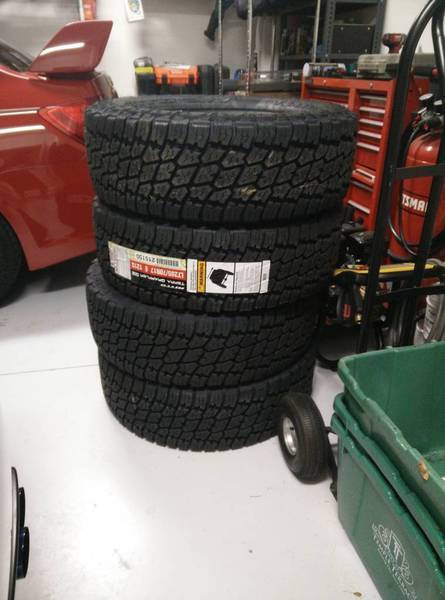

    LT285/70/17 Nitto Terra Grappler G2's. These were picked up from a family member who deals tires a week later. I got in on the Wheeler's Icon group buy for a stage III lift and ordered a set of Pro Comp Rockwell 5034 wheels. They should both be here in the next couple weeks (wheels were backordered, group buy took awhile to close). Bonus shot of the wife's [car's] butt.

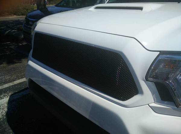

    Grillcraft MX upper. Being that this shot was taken nearly at night should explain that this install took me a lot longer than I expected. I was apprehensive about cutting out the center section, but that ended up being easier than I anticipated. A dremel with plastic cutoff (more like melt off) wheels, a couple sanding barrels and a utility knife made short work of it. Tough part was getting the holes drilled in just the right spot so the grill fit perfectly.
    Here's some better pics from the next day

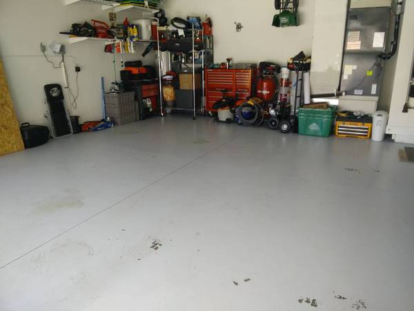

    Garage cleaned up. Not shown, lots of beer on ice.

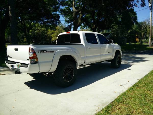

    All done! Found a lighted parking lot to take this crappy pic. I was exhausted.
    Initial impressions:
    A lot of rubbing, but this was to be expected, especially before the alignment. I didn't have any severe steering stiffness that some others have reported with uniball UCA's, but the truck did feel quite stiff overall. Surprisingly it tracked fairly straight, and I was very happy to find zero driveline vibrations. No diff drop or shims, just properly torqued u-bolts (73#, not 37# per the FSM!) As it sits with the coils at Icon settings, I'm about +2 front and +1.5 in the rear.
    Back from the alignment shop early the next morning. I had the tech set the caster to 2.4 on each side per recommendations on here. This did indeed clear up a lot of the rubbing, but there is still some plastic that will need to go, and I will probably need to beat down part of the pinch weld. Luckily, I don't think I will need to touch the cab mount, but we'll see once I can get them fully stuffed on the trail.
    I put about 500 highway miles on it over the next 36 hours. The suspension definitely changed its character over this time and the stiffness subsided. I was getting a lot of high frequency harshness from the road on my way out of town, but on the way back it was an order of magnitude smoother. Still no driveline vibrations all the way up to 80mph. Speedo reads about 2-3 MPH slow and fuel economy was down about 1.5 mpg when corrected for the odometer error - all within expectations. The Terra Grappler G2's are a bit chatty, probably more so than the BFG AT KO's I ran on my old truck (albeit on stock suspension), but reasonable considering the tread pattern, and nowhere near that level of a MT tire The uniballs and stiffer UCA bushings likely transmit more NVH from the tires than the factory setup as well.
    Overall I'm just smitten! I can't park it now without looking back at least twice and smiling :D

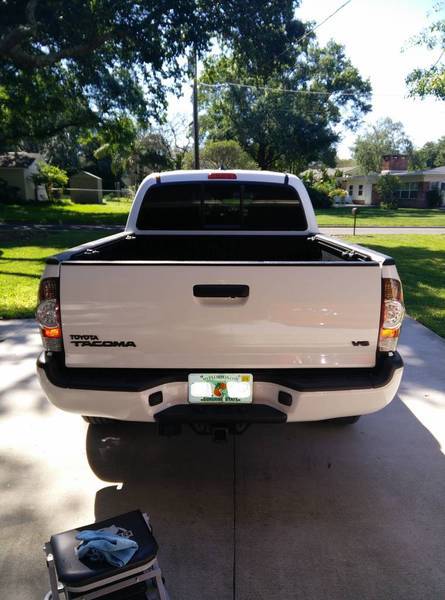

    About 1700 miles on since the lift and no issues to report. Icon had shipped the wrong sway bar drop kit, so I got that figured out and reinstalled the sway bar today. Considered leaving it off, but I'd rather trade articulation for a little piece of mind, especially considering the amount of highway driving and towing I do.
    Also laid down a couple coats of wax this morning to prepare for shitty lovebug season. So today it looks nice, so I took the SLR out and got some decent pictures.
