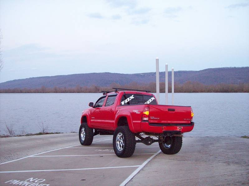

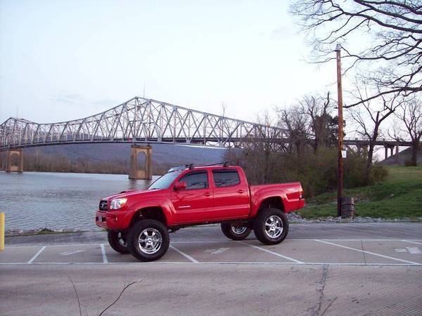

    Yeah, i asked him a while back and this is what he did.
    Like said, its probably possible but its going to be ridiculously tall IMO. Besides, you'll need some 37 or 39" tires to fill it out proportionally and tires that big are going to be really hard on the Toyota axles and you'd need to regear really low to maintain any power and driveability.
    Im not even sure what the lowest these trucks have available because the front diff is exclusive to the current FJ, Tacoma, and 4runners. i'd say with tires that size you'd want 5.29 gears if they have them. That'll be another grand+install there too and the suspension lift will run 2500+installation for a 6" stage 2 kit, then the $250 3" spacers on top of it and the bodylift and labor for the install. Throw on some wheels(600-1000 probably) and some tires that large, I'd estimate this as being a $6000-8000 project!:eek:
    DEFINATELY not somthing i'd do to my truck. I personally want a 6" but bigger than that is kinda pointless IMO. I think you need to think about this long and hard before going for it.:cool:
