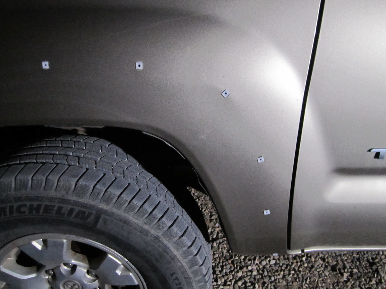

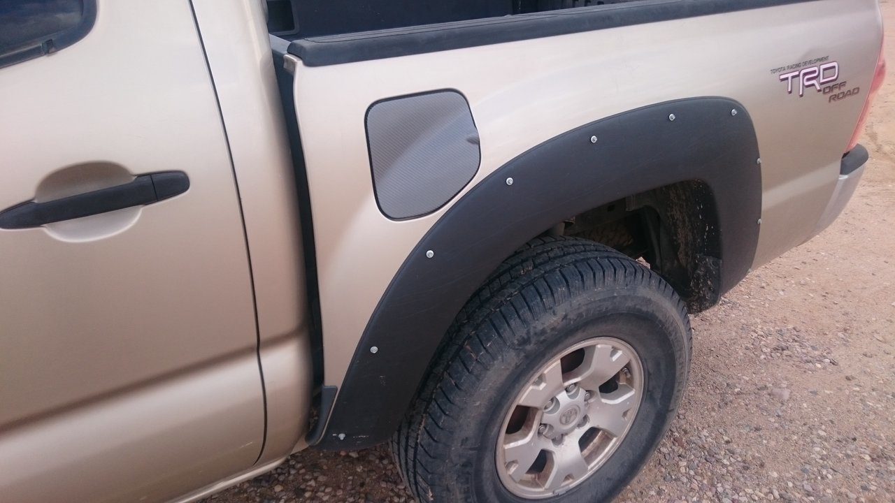

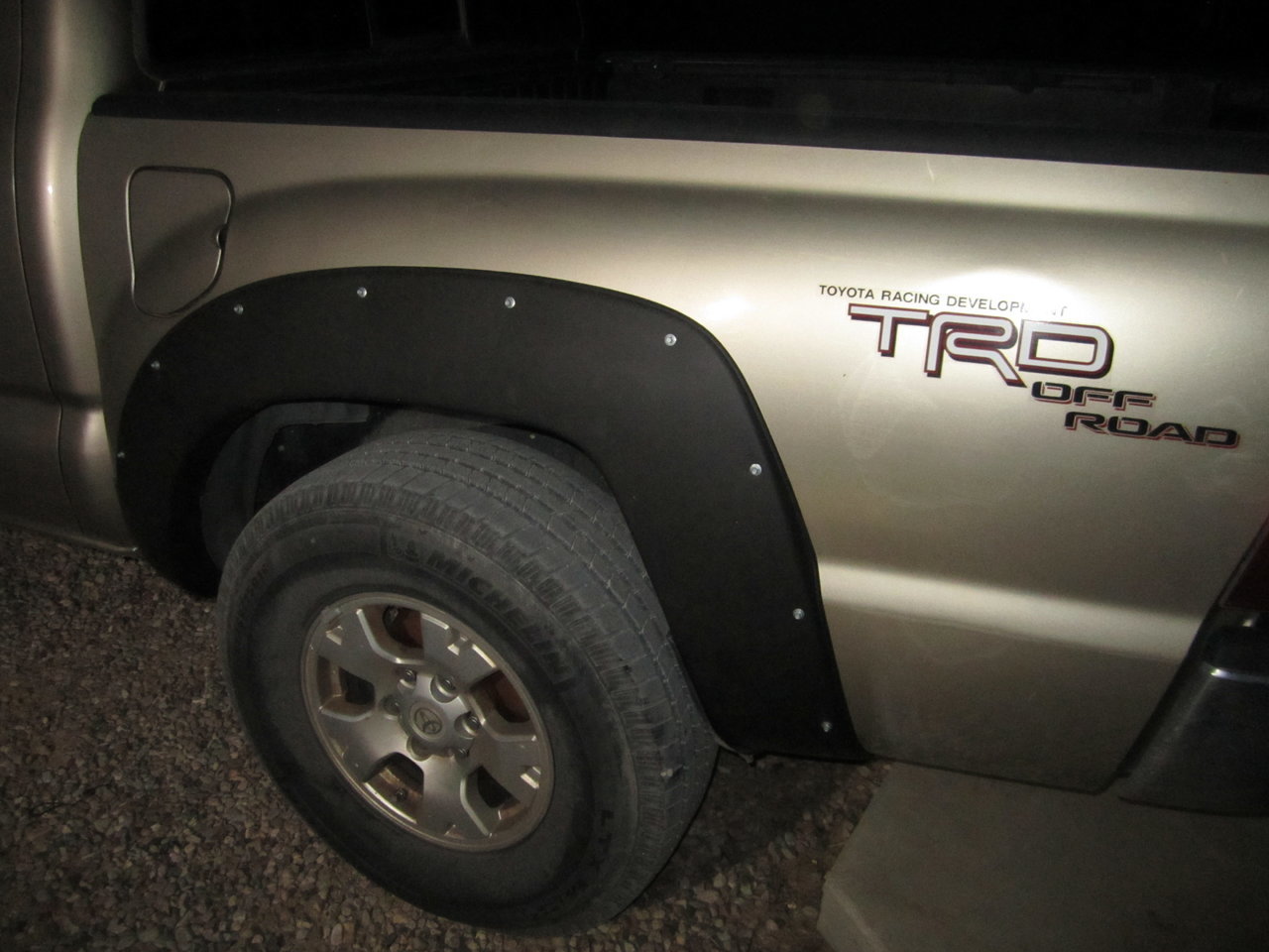

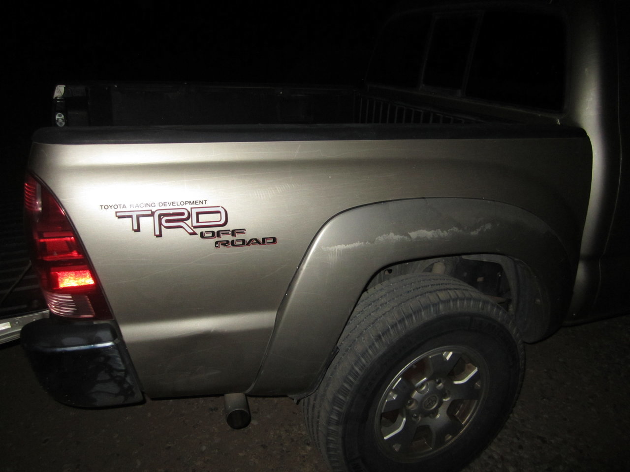

    Pictures tell 1,000,000 words so I'm just going to let them speak for themselves. After 11 years in the Arizona sun they were looking rough and the clear coat was gone on the top half.

    They're the stock ones, I just painted them black and since so many of the clips were broke I mounted them with the screws instead. It was pretty easy to drill the holes, I did it from the back side so I could center them over where the stock tabs were. If you drill from the back it could take a little more to clean up the hole but I just drilled slowly and didn't care if it wasn't super clean as the screw was going to cover it. I'm pretty happy with it all and all for $9 total.
    $4.44 when I purchased them - http://www.ebay.com/itm/100-Bumper-...e=STRK:MEBIDX:IT&_trksid=p2057872.m2749.l2649
    $4.90 when I purchased it - https://www.amazon.com/gp/product/B000PIEWLA/ref=oh_aui_detailpage_o03_s01?ie=UTF8&psc=1
    $19 when I bought them (for an actual roofing project I was doing) - https://www.amazon.com/gp/product/B00YZCUY78/ref=oh_aui_detailpage_o05_s01?ie=UTF8&psc=1
    The fuel door cover is just a wrap but I'm super happy with how it turned out. Here's what I used:
    $9.99 on Amazon prime when I bought it - https://www.amazon.com/gp/product/B00FXY5I96/ref=oh_aui_detailpage_o02_s00?ie=UTF8&psc=1

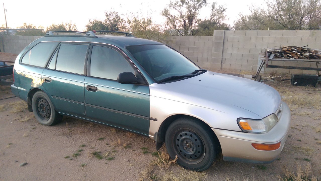

    As a side note, here's the last car I bought before the Tacoma. 1993 Corolla wagon, I bought it completely totaled with 124k for $780, spent $400 on a parts car, took what I needed off of it, sold the rest of that for about $500 and all and all I was into this for $700ish. Drove it for two years then sold it to a friend for $1,000 two years ago. It now has 170 something on it and hasn't had one issue in four years. Are you seeing a theme? I tend to shop values and amazing running vehicles without concern for how they look. I might be silly but I'm driving the thing from the inside so I never understand caring what the thing looks like for other people. IMAG0035.jpg
