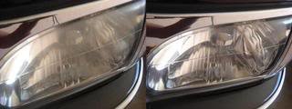

    00 Taco 4x4 Ex cab 2.7 sr5 AT
    New Pioneer stereo, and all 4 speakers with Infinity components. Sirius satellite radio. Deckplate mod done. Door buzzer silenced forever thank God, tinted windows, vent visors, hood protector(bug guard), ceramic pads and new rotors, dechromed EVERYTHING. 2" Lift front 3" rear. Skyjacker AAL's and replacement leafs(and front spacers) from Fatbobsgarage.com. Skyjacker 7000 Hydro rear shocks, those Bilstein 5100 fronts are coming soon!
    Best stuff I have ever seen/used is this....
    http://myheadlight.com/
    NOTHING can do better than this stuff. And it has an acrylic sealer so it won't go back to yellow, or fog back up, and a lifetime warranty. $20 well spent. I have been using it on all my cars here in FL where the sun ruins everything.
    The headlights on my Taco were really foggy and going yellow, look at my pics after using this stuff...
