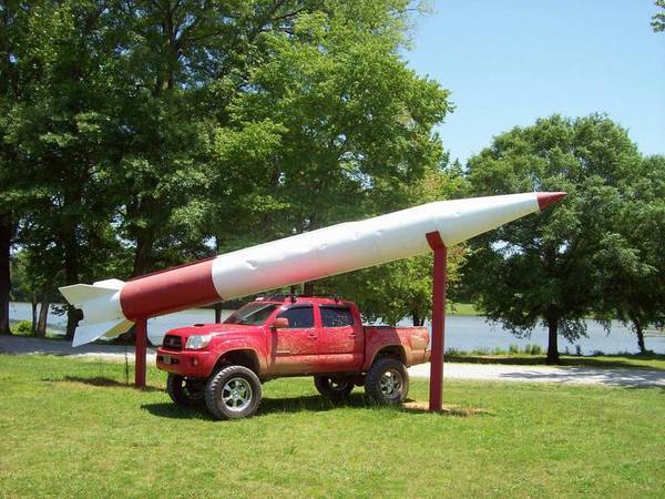

    You'd have to do quite a bit of trimming on the fenders and cab mount. I know that the guy I'm about to show you recently got Fiberglass Fenders and Bedsides. This truck is completely sick. If I had access to a shop and the cash available, I would run 35"s
    BruynBoys Taco with a 3" Donahoe lift and 35s.

    damn that is a crazy ass lift, looks kind of dumb

    05TacoTRd Thanks for posting that. I'd love to have 35's but I do believe thats too much trimming for me.

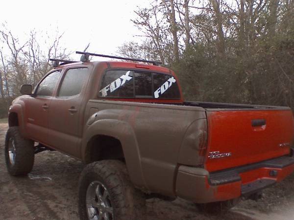

    9" and 37's my truck

    i have a 08 tacoma dc with a six inch lift where did you find a nine inch or did you have it custom made? the truck looks great thanks for the post

    9"... 6" procomp lift.. and 3" with the coilspacers w/ aal

    do you have any drive shaft problems or cv axle problems in the front or do they make an additional drop for the front chunk?

    well the cv boots rip all the time it sucks. I still have to get a drop for the front. and only have small driveshaft viberations when accecerlating from about 7-10mph. nothing really just have to take it easy at first when taking off from say a stop sign or a stoplight
