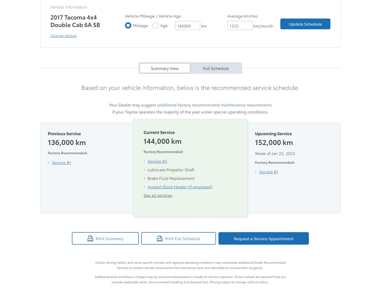

    They are supposed to do it. Its written right in Toyota's maintenance schedule. "lubricate propeller shaft"

    ExGunner [OP] Well-Known Member
    Nov 6, 2017
    #235239
    234
    Paul
    2017 Tacoma TRD Sport Blue
    Thats true. Im going to stat checking their work. I caught one of their mechanics just filling in the tire pressures and not actually checking them. I made the service manager come out and verify the numbers his mechanic reported. They were wrong. I mark bolts that they are supposed to remove to get certain jobs done and if they didn't they have to answer for why before i pay my bill. I guess I'm going to have to add checking the zerks as well. I was the Training NCO they recruits hated to see walk in the barracks for an inspection and i guess i have to reprise my role .:santa2:
