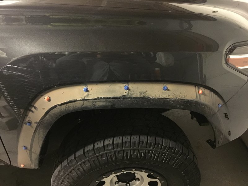

    Unfortunately I don't but I do have before and after pics of the fender to just get an idea. There is no possible way of fitting without cutting unless you are doing a 6" drop bracket lift.

    Oh perfect. Thanks for posting those. I knew you cut the flare but didn't put it together you cut the fender. That's fine with me. My last car was a BRZ that I cut into with only a few hundred miles. :)

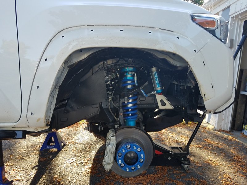

    Any idea how much lift you have? I think I'm a little over 2.75 in the front of mine. I'm not familiar with King to know if that's a spacer up there or just part of the coilover.

    Ha. Look at that. All I had to read was the first post. Looks like I'm ordering up some 35's!

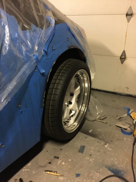

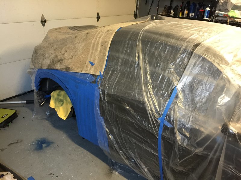

    Not to derail the thread, but here is the last vehicle I cut to fit bigger/wider tires. No going back on this one since the rear cut into the body where there's nothing you can swap back to stock. :eek::rofl:

    Sounds good. I'll cut first. I think I even have some trim left from my last car. And I can imagine. The fender not so much since you hide under trim and the flare. But the flare on the other hand. I'll be sweatin making that cut.
