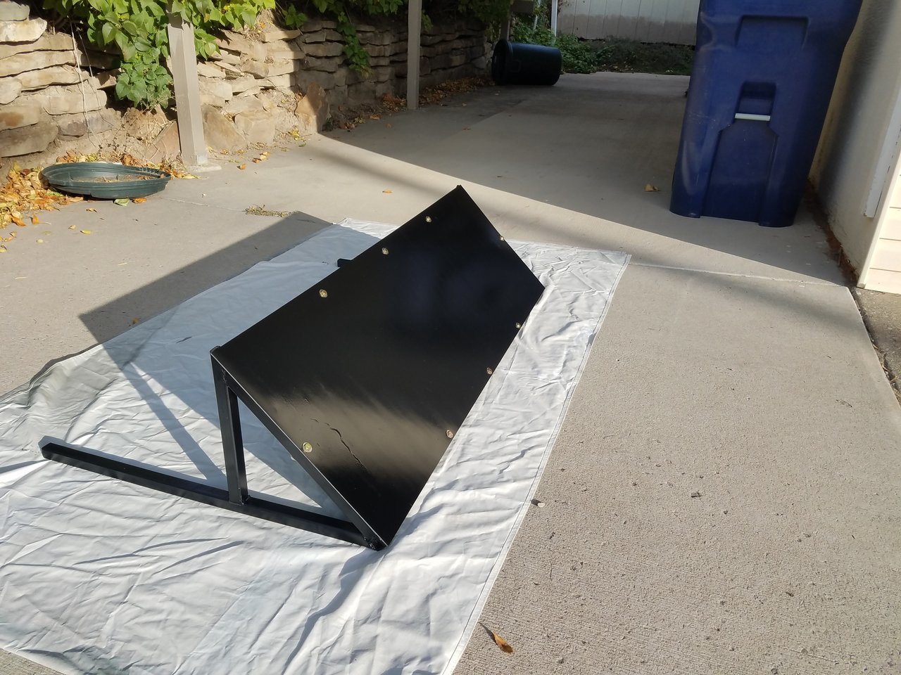

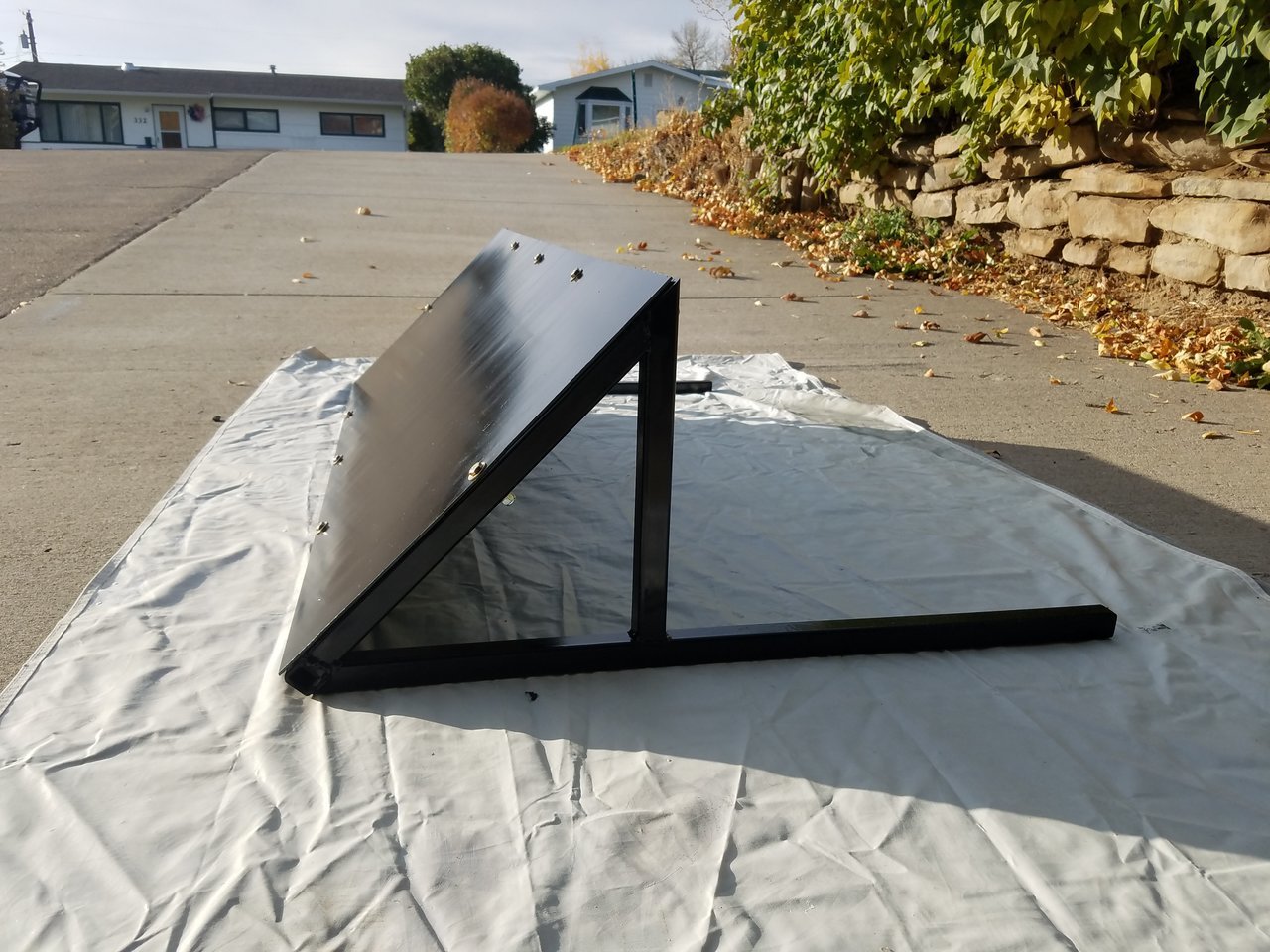

    That wind shield is a solid idea.
    I'd sticker bomb it, and add a light bar, but I'm known to make bad decisions.
    bski22 and 90yota[QUOTED][OP] like this.

    Put the sheet on this morning. Going to let it dry longer. Got some fingerprints on it

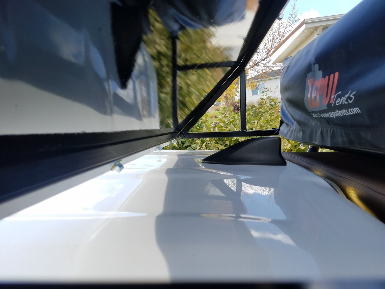

    Looks good man, I assume it will attach to the top of the roof via the stock holes? If that is the case, may not be a bad idea to make some stubby legs to keep the middle part elevated off the roof section.

    It's going to be attached to the bed rack so it should be elevated about 2-3inches off the roof.
    Coot83[QUOTED] and ChadsPride like this.

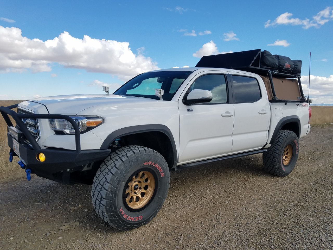

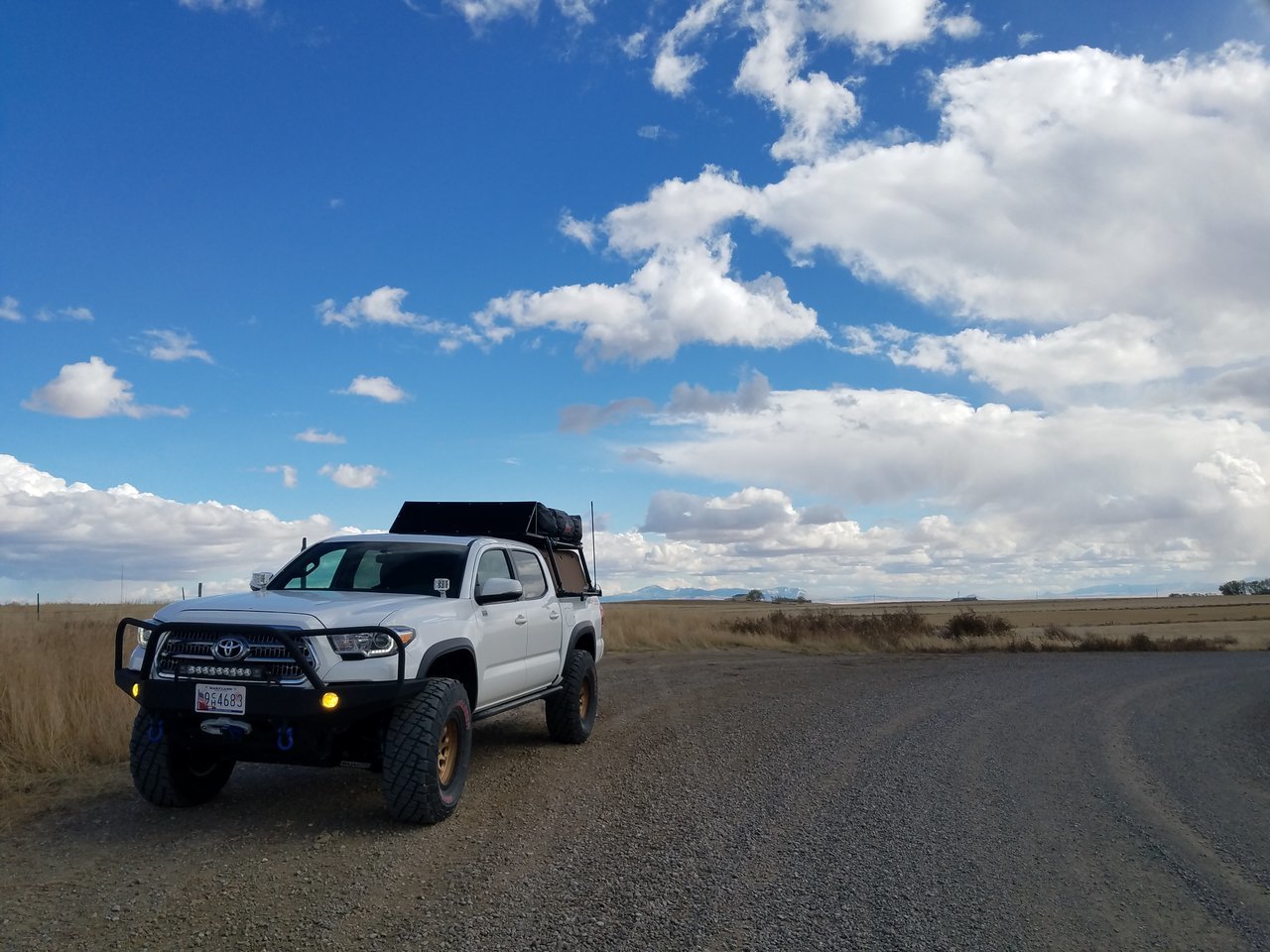

    Well, I'm actually pretty happy with the way it came out. Took it about 40 miles on dirt road and highway to test and didn't hit the cab of the roof at all so the spacing is perfect. Also gained back 3.5 mpg's :goingcrazy:

    Looks solid! Im really astonished that you gained back 3.5 mpgs that easily, thats awesome.
    90yota[QUOTED][OP] likes this.

    Thanks, its heavy AF though. The wind drag was terrible. Just cruising around I can feel the difference
